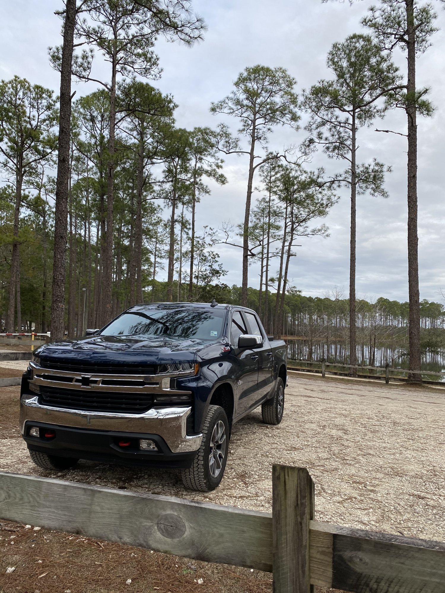

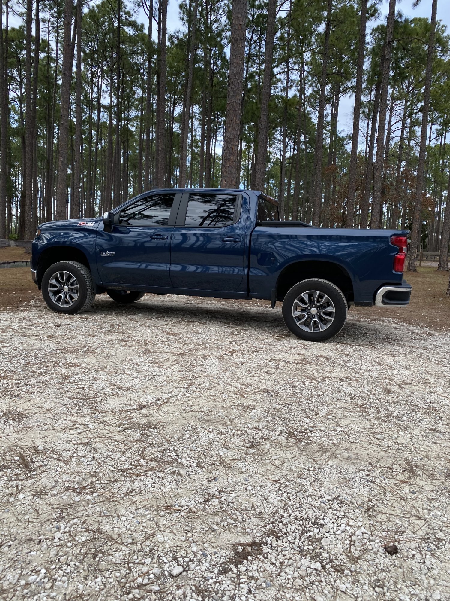

13 hours ago, PureZ71 said:
Anyone here running the Ready Lift AT4/Trail Boss Plus 2.0" SST Lift Kit- GM 1500 AT4/Trail Boss 4WD 2019-2021?
https://www.readylift.com/at4-trail-boss-plus-2-0-sst-lift-kit-gm-1500-at4-trail-boss-4wd-2019.html
Yes I am, zero complaints. I didn’t add the rear block as I have Bilsteins and didn’t want to over extend them and I’m not a fan of shock extenders.
Awesome. Do you have some photos of it that you can share?
