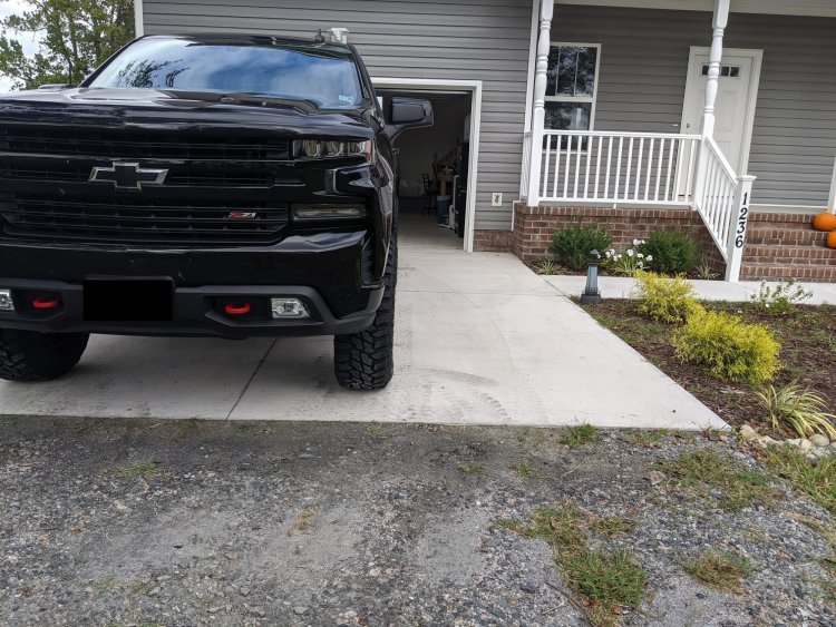

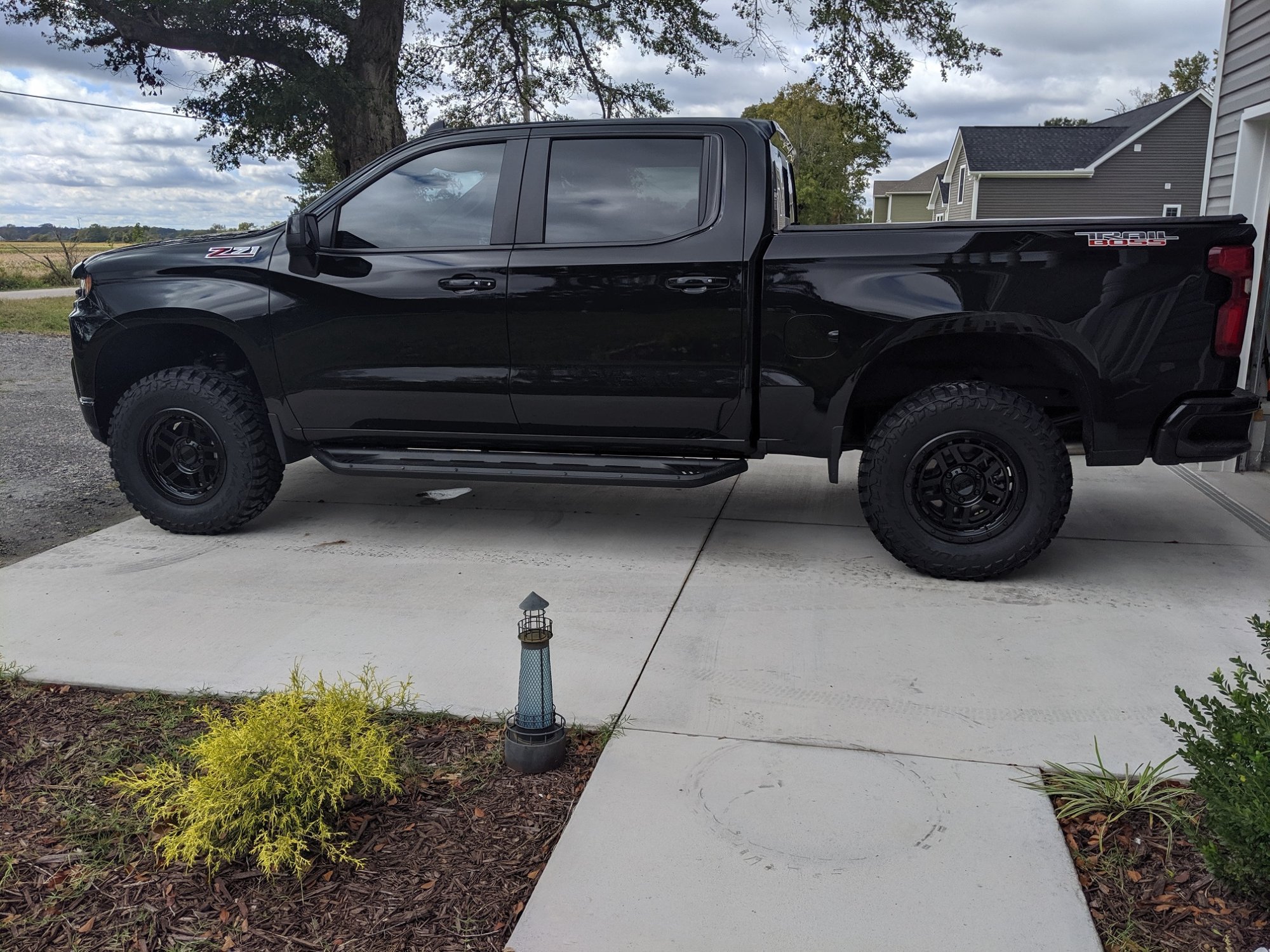

19 TrailBoss with Rough Country 1.5" leveling kit and 35x11.50r18 Toyo Open Country AT II
No wheel spacers and there is about a gnats ass of clearance but no rubbing
