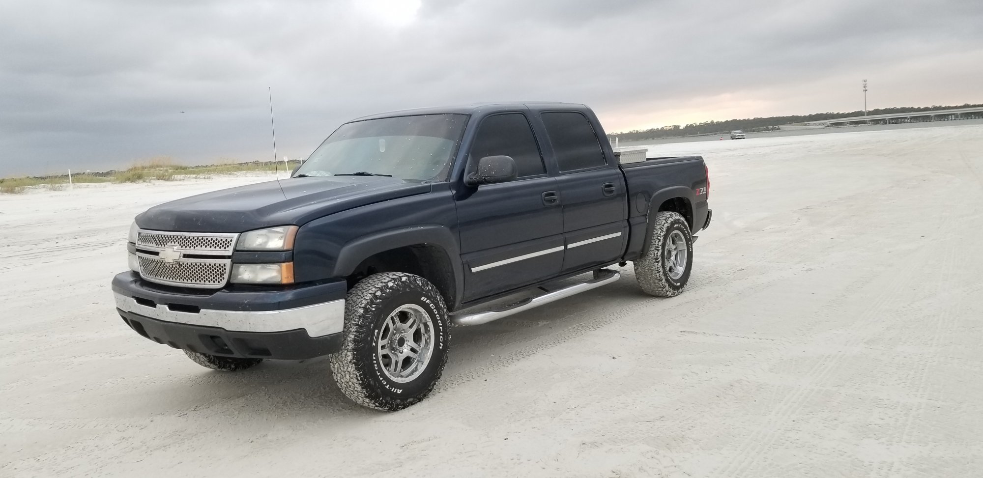

I recently had the same issue with my 03 silverado 1500 with -14 eagle alloy wheels (18x9.5), 2in spacers, and 35x11.5x18 Toyo rt. I replaced the pitman arm, idler arm, idler arm bracket, tie rod ends, and upper control arms. After replacing these parts my steering became much tighter and took out almost all play. Before I replaced these parts my truck was all over the road.dbfa6c090d02bcea29d854deeee58b3c.jpg6ae91604c8819efedeef6e97cf435c7f.jpg
