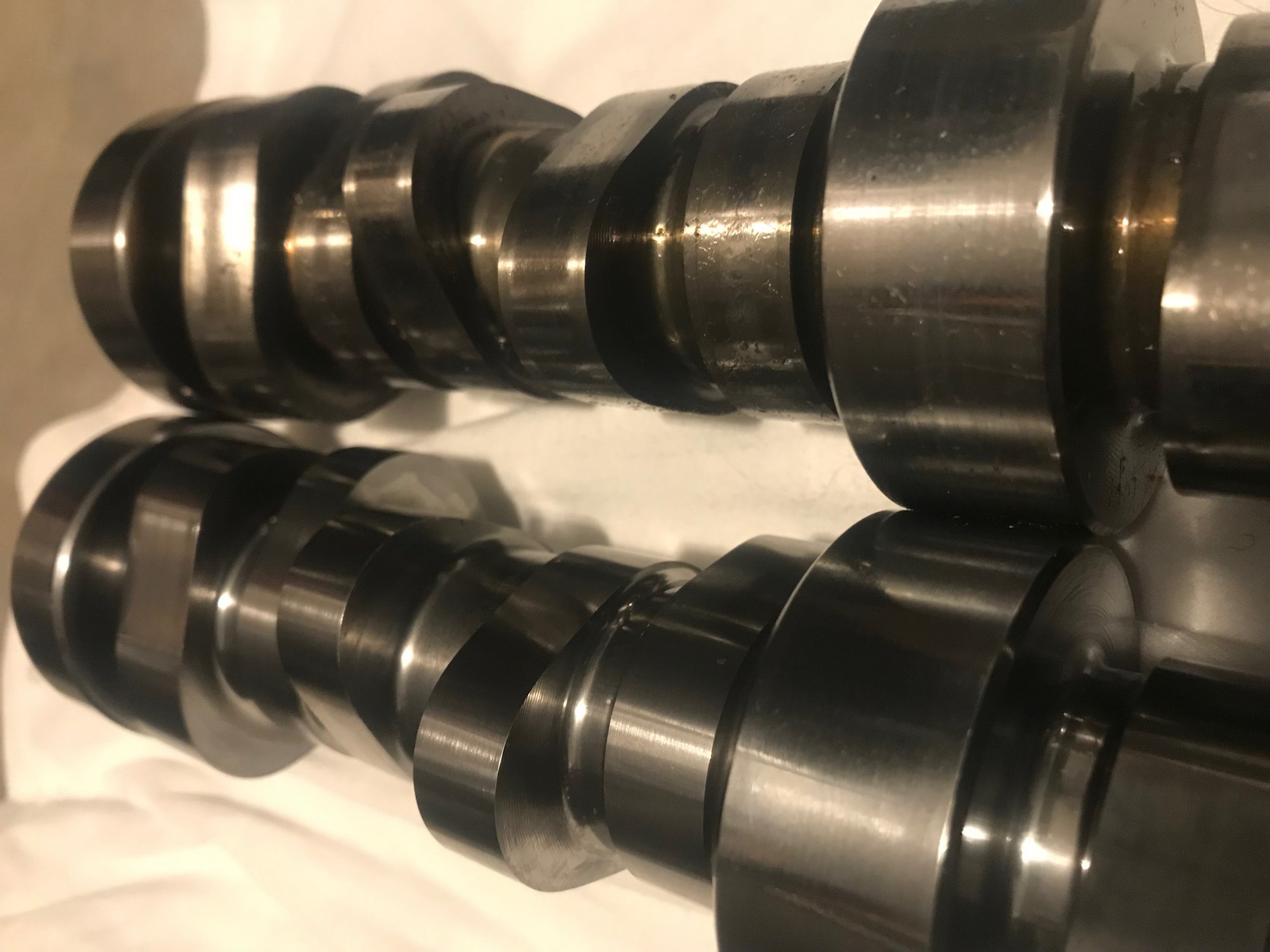

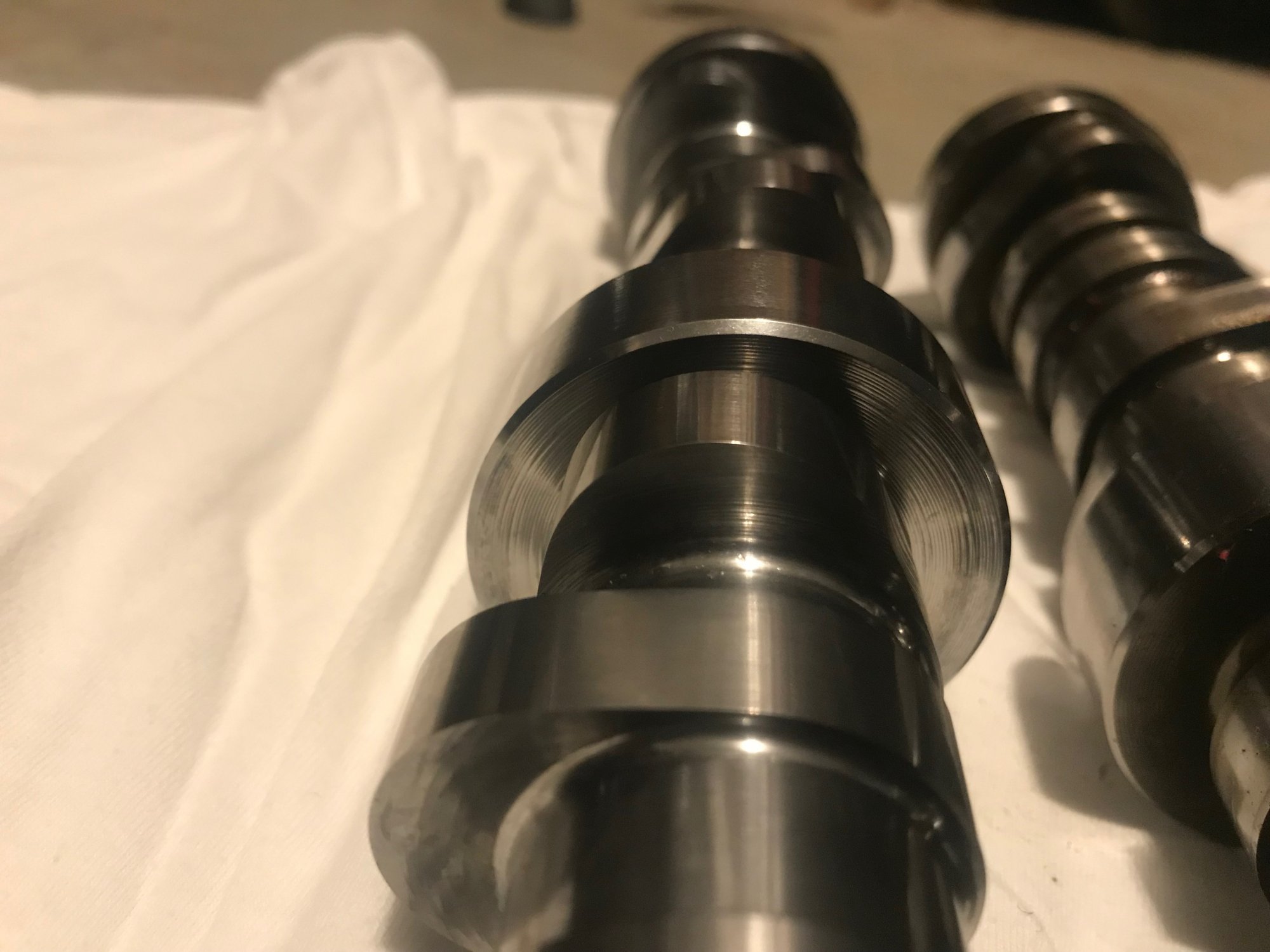

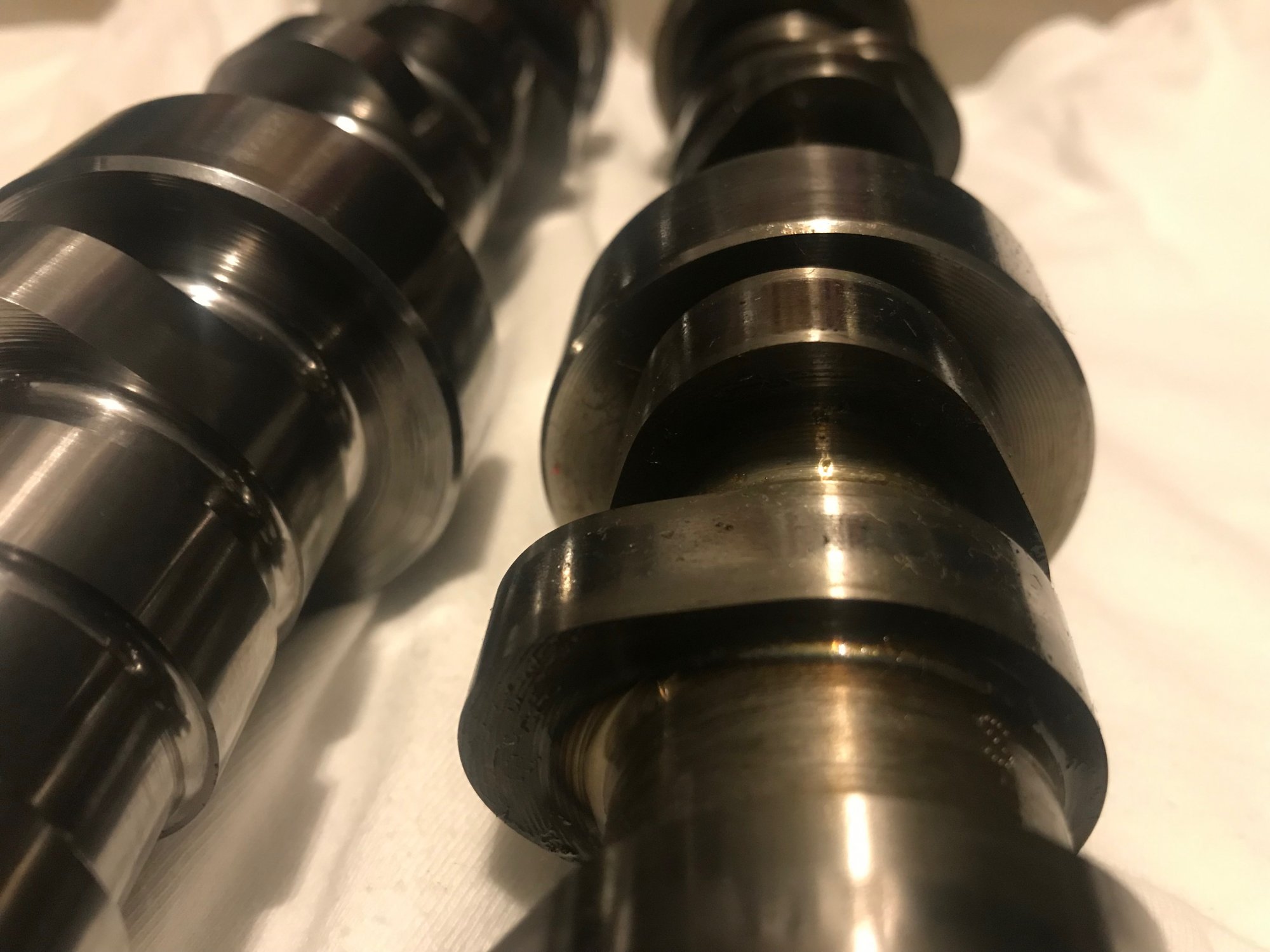

Once it is tore down I will share pics of what I suspect a scored cam lobe. Dealer replaced lifters and bent pushrod and said cam was fine at the time. I am sure it is toast now.

The OP is concerned that his current cam is scored from his previous lifter failure. So, it seems that a cam is in his future regardless of power gains.

I'm pretty sure I have a messed up cam lobe... I could care less about a 5.3 pulling away from me.
