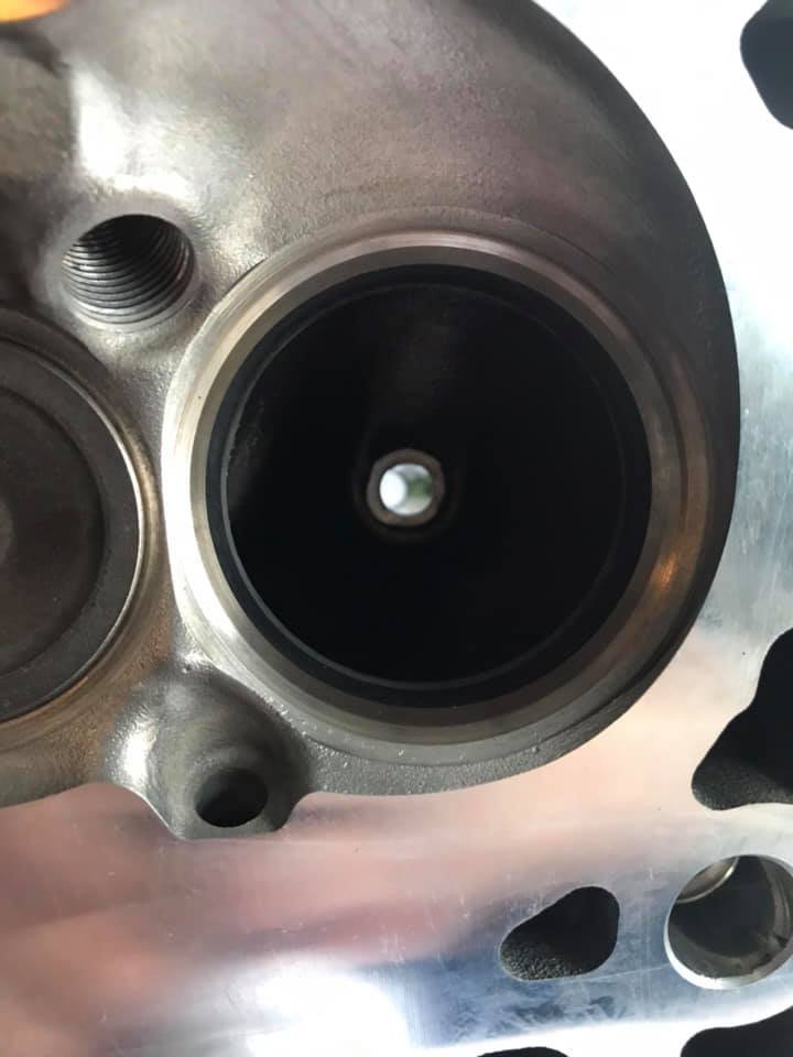

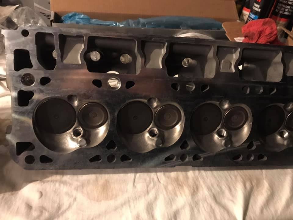

Taking heads to machine shop in the morning. Did not like how the valves were sealing even after attempting to lap them in. Too much work to not go ahead with a goof valve job.

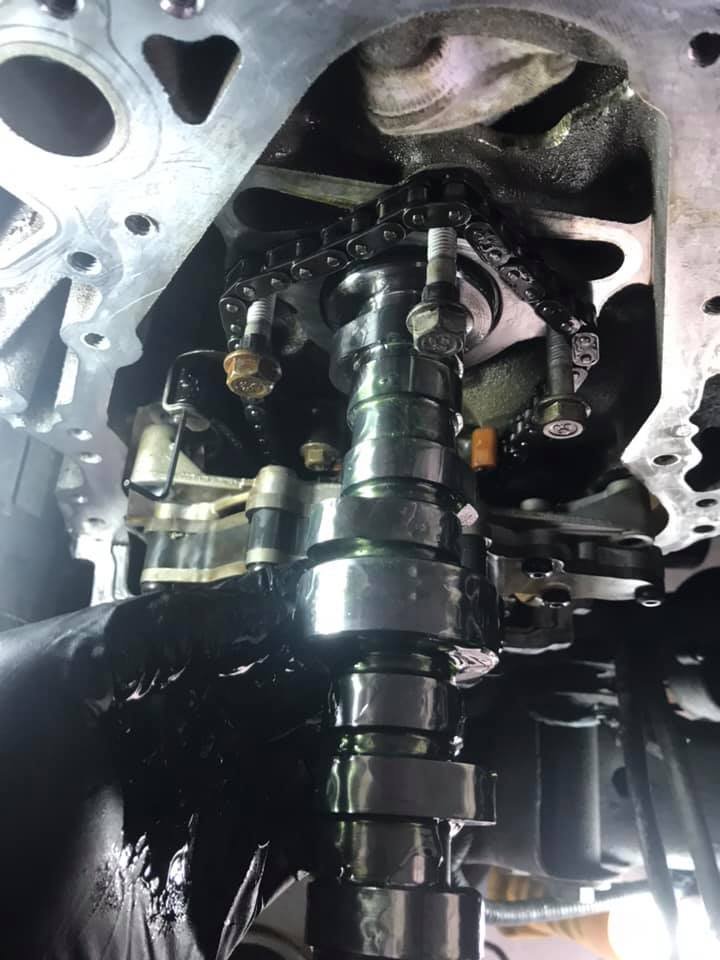

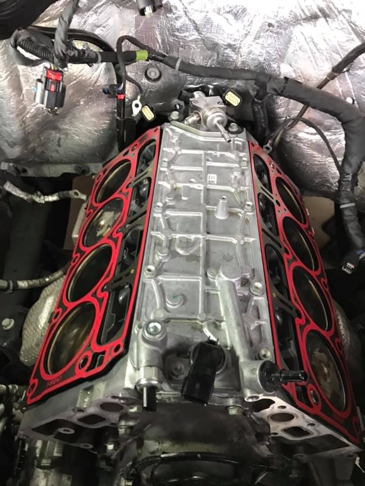

Note: I was able to loosen oil pump and slide forward just enough to remove cam timing gear (Oil pan still bolted in place). I am fairly certain I can get it back in time going back, we will see. Plan on making a mark 180 from original timing mark to help me line it up. Will use the piston at TDC for crank position.
This has not been as bad as everyone had made out. I was a GM Master Tech from 1993 to 2005 but I would say anyone mechanically inclined could do this with good repair info. Also I have $1100 in parts for the cam install portion. TSP Headers and Cats, New Plugs, Taylor plug wires, antifreeze, oil, & filter which is close to $900. Head work will cost $350.

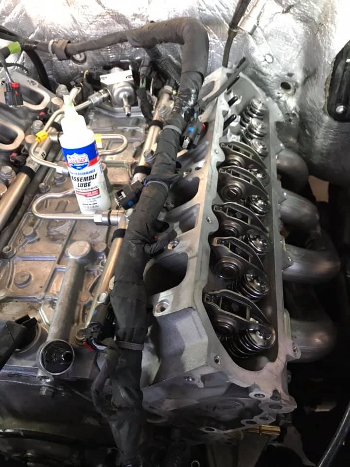

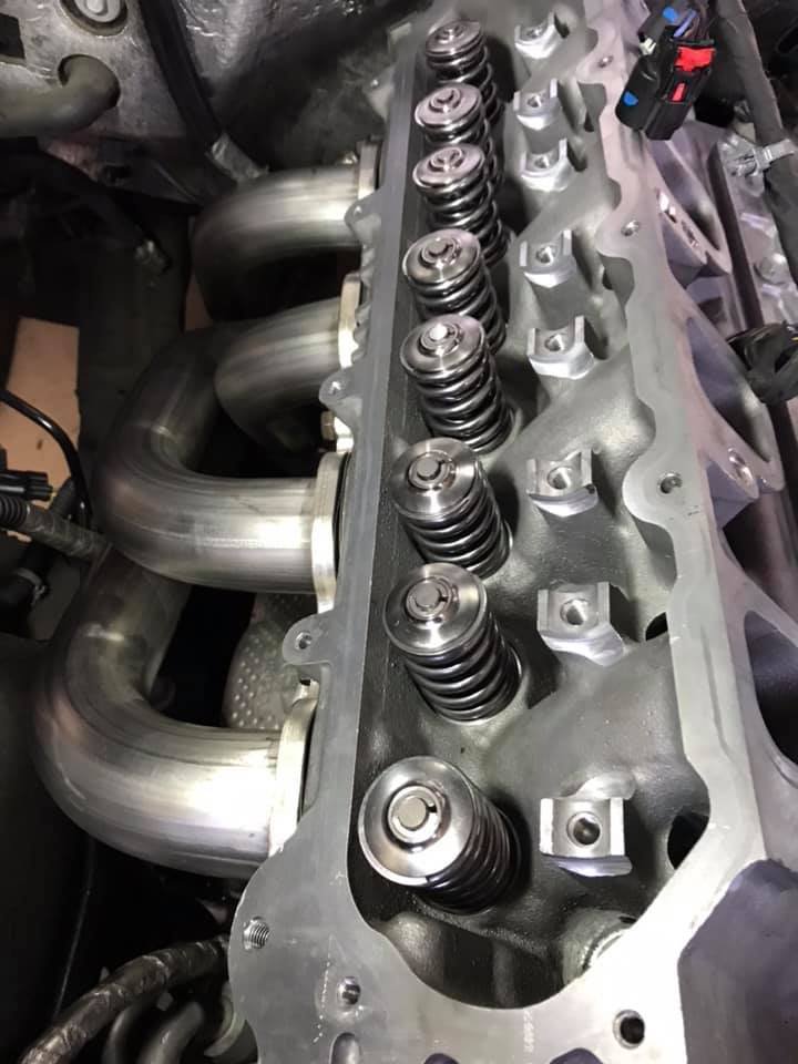

Looks great! Thanks for leading the way and posting this cam install for those of us looking to doing this.
