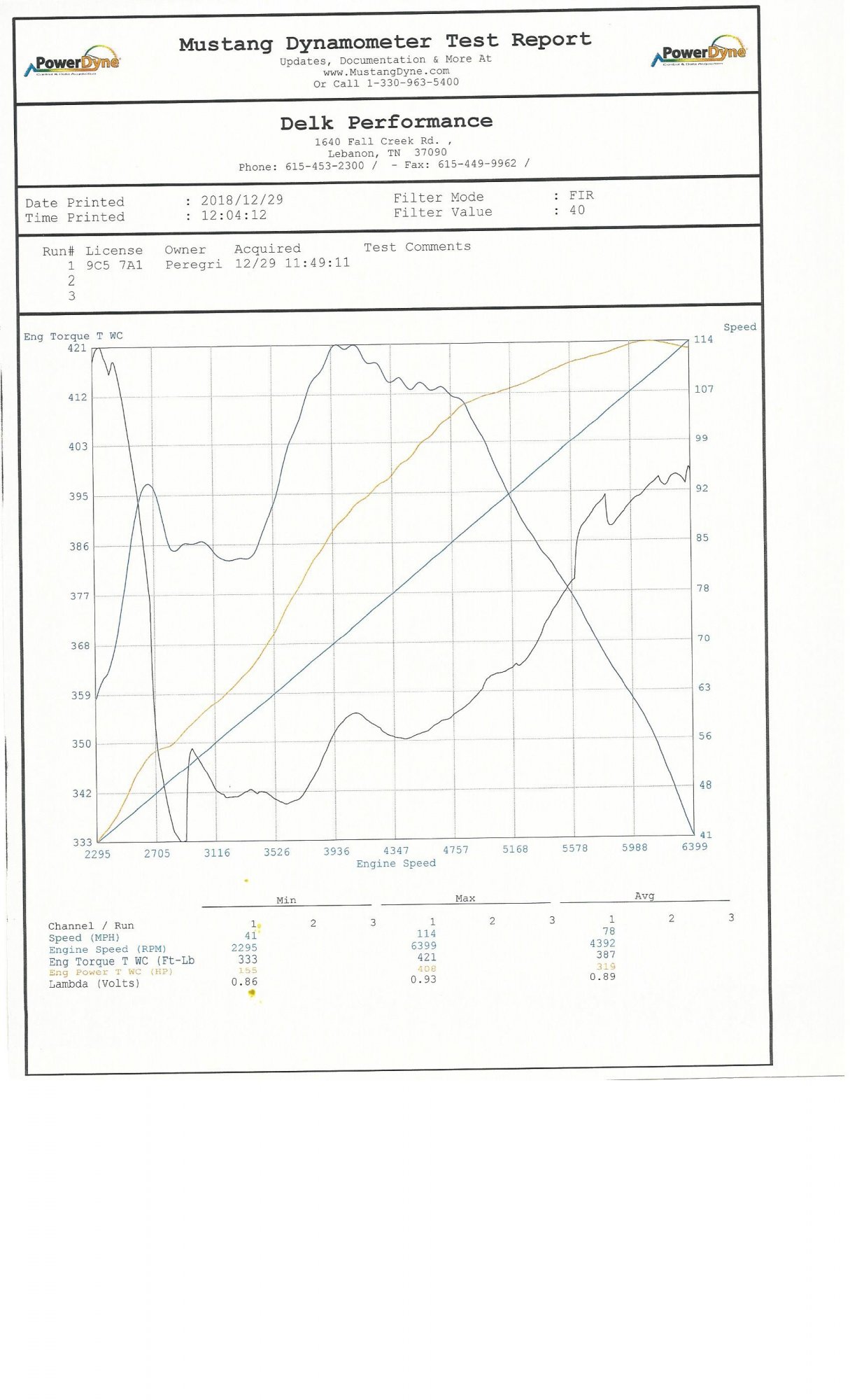

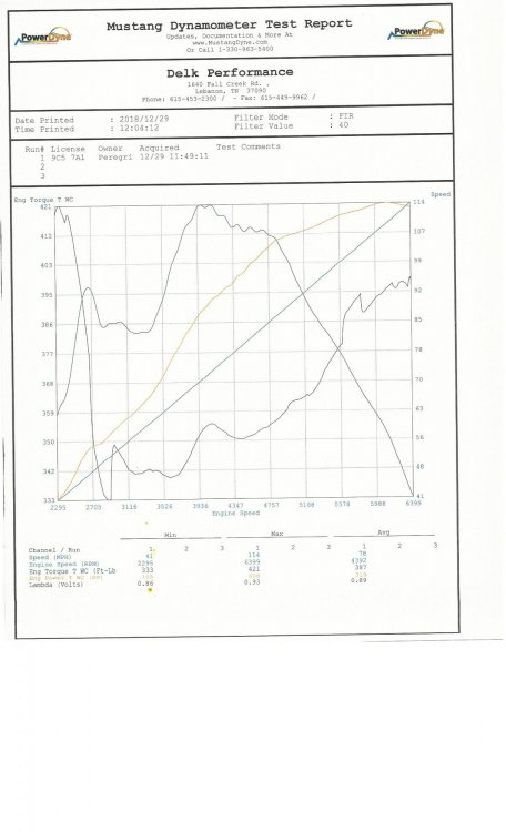

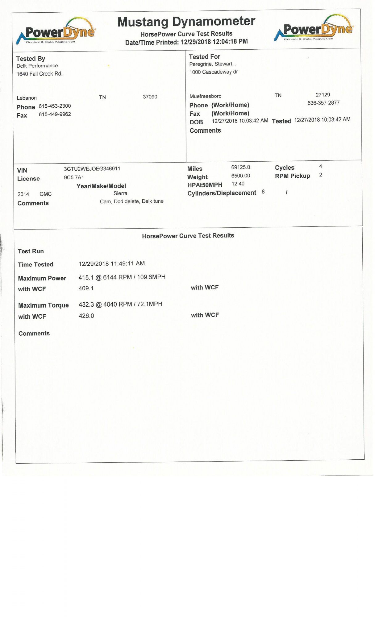

Dyno - 409 HP and 426 TQ on 93 octane and Mustang Dyno.
Torque reading looks all over the place. He got 1-4 shifts spot on. Not happy about my clunk in drive-line, more noticeable now with bigger cam. Believe it will go back to tuner for some more refinement.
