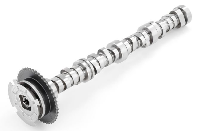

The large gear on the front of the cam is the actuator that controls the camshaft through its 31 degrees of potential movement. Also note the groove cut into the second journal. This groove is what directs oil from the main galley forward to the actuator. The cam bolt that also serves as the valve that directs oil in various directions to move the phaser to either advance or retard the camshaft.

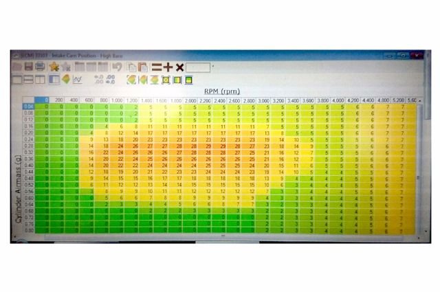

Pic below is the HP Tuners page for VVT control. Maximum load would be at the bottom of the chart with highest rpm on the far right. Note that the biggest numbers occur at light throttle (shaded yellow). This is because GM “parks” the cam at full advance, so the numbers refer to the number of degrees of retard implemented. GM retards the cam at light throttle to reduce intake manifold vacuum.
Advance vs. Retard
