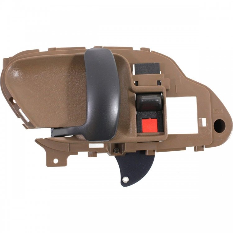

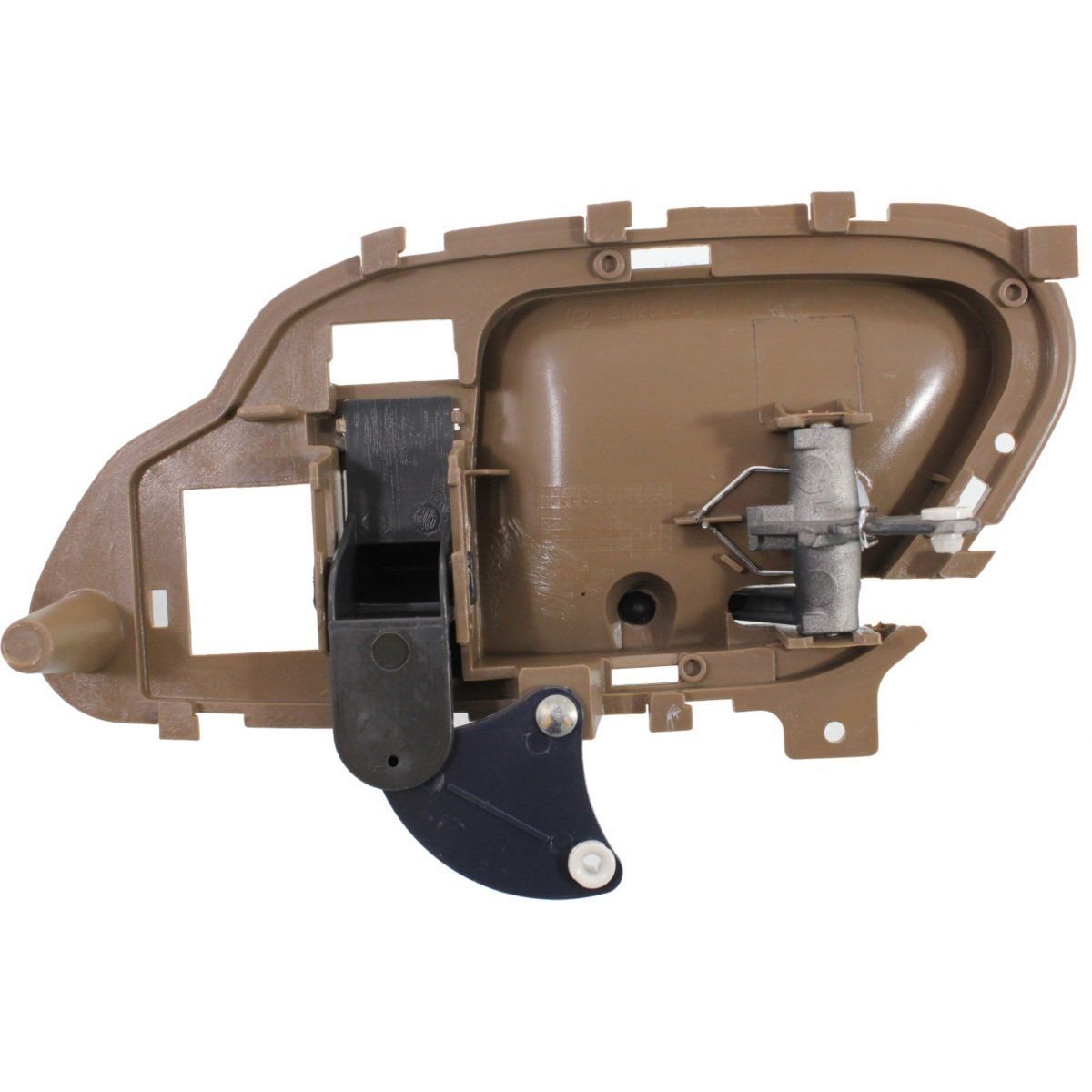

I had a '98 Silverado that did the same thing until the door handle finally broke. Replaced it and all was well. Been over five years ago so I don't remember just exactly what piece broke but here's pictures of the assembly that was replaced. Relatively cheap on eBay. Anyway that's what my problem was.

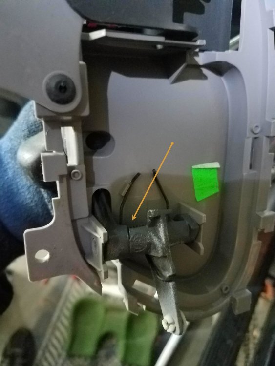

I found a video online that showed the cylinder (on the backside) was cracked.  Maybe that's what happened with yours, too?

Correct, the pot metal piece broke I just don't remember exactly where. These model vehicles are notorious for the handles breaking. As far as the rivet, yes, you have to drill it out and replace with a short sheet metal screw or another rivet.
Thanks for the helpful info!  I found the same problem... the pot metal 'cylinder-shaped' piece was cracked.  So, I found a new part for less than $20.
