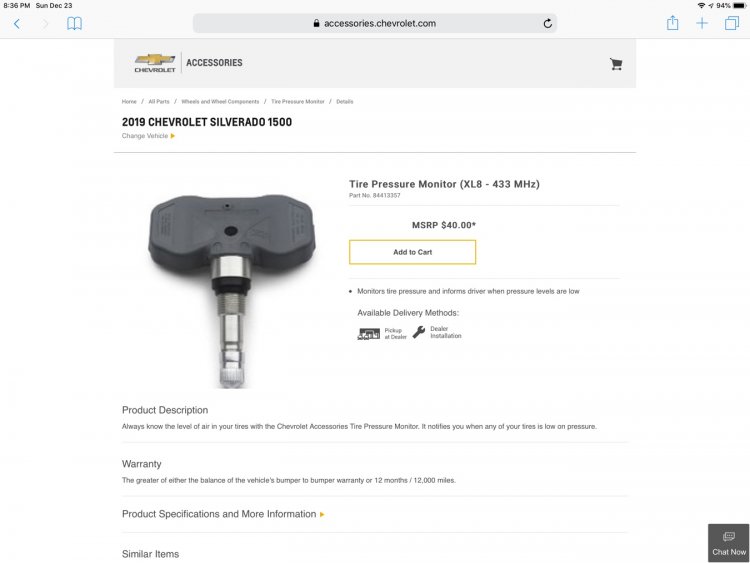

Has to be 433mhz. Had the same problem with mine. I bought a wheel and tire package that included sensors. I stated the year and make of the truck but they still gave me the early version 315mhz. We checked the originals before complaining and they are  433mhz. Also the programmer the shop was using they had to trick it saying it was an Arcadia for it to work.

My 2017 wheels wouldn't communicate with my 2019.  The 2019's changed the frequency to 433.  No way around it, have to change the sensors.

I ended up buying OEM sensors and everything worked.  The Discount tire manager found a note in their computer after I already bought the OEM ones, that said to set the programmer to a Chevy Traverse model.  We tried it and the truck honked with one of their own sensors.  Maybe try it and see if it will work.
