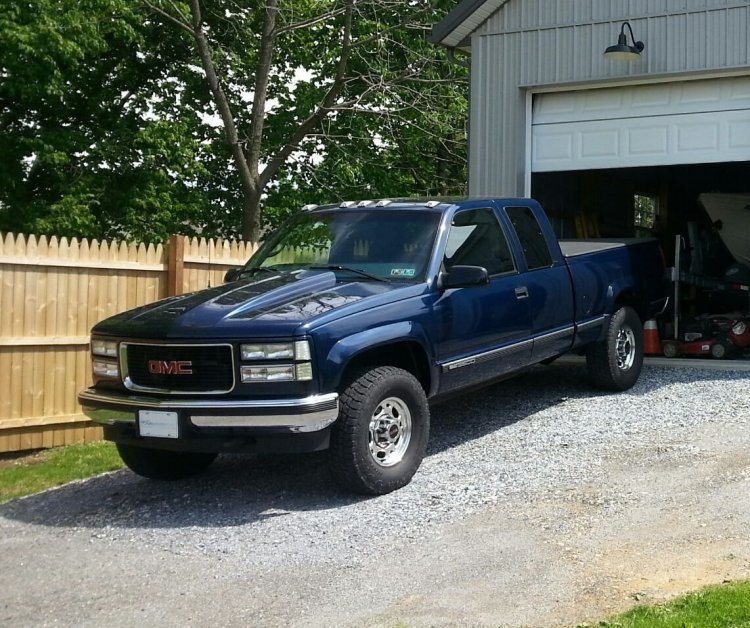

Don't expect much better mileage. I've had my 7.4/454 K2500 Truck for 19 years and the mileage hasn't gotten better or worse except in the winter when the oxygenated fuel comes out then it gets 1-2 mpg worse. I figure since I haven't had a car payment for at least 15 years I can afford the gas.
