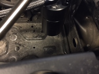

Installed my Elite Engineering Catch Can today.
Installation was pretty straight forward, the only problem I had was finding a place to mount it.
I tried the windshield washer fluid mount area, but the bolt was too short and I couldn't tighten it.
I then looked at the brake booster mount, but seemed too tight especially when it comes time to drain the can, since I would have to unscrew the bottom can.
My next choice was above the radiator, but same issue as the brake booster not enough space when drain time comes.
Being perplexed, I kept looking around and I found  a spot right above the spare battery tray on the driver's side inside fender.
What at first looked like a spot weld, I stuck my hand behind it through the large opening and found it was a thin piece of foam...not sure what/why this is there.
So I got a wood screw and pushed it through the foam to screw out some of the foam, got a bolt/nut/lock washer/washer and mounted the bracket.
I had to contort my arms to hold the nut and tighten the bolt, but eventually I won and got it tight.
From that point on it was a breeze...
I purchased a cable cutter from Harbor Freight (19.99) using a 20% coupon ($15.99) and it cut the braided hoses like butter, great tool and an even greater price.
There's a slight whistling sound, which I believe is from the check valves, being when I cover them with my hand the sound becomes quieter, but doesn't change when I cover any of the joints going into the can.
I also used the GM hose connectors, cut them off the OEM hose and used them on the braided hose with the supplied hose clamps.
I'll put on a couple of hundred miles and check to see what/how much I collect in the can and post the results.
I hope the pic of the mounting area will come out in this post...if it does I'll post more and ignore the dirty battery tray!
