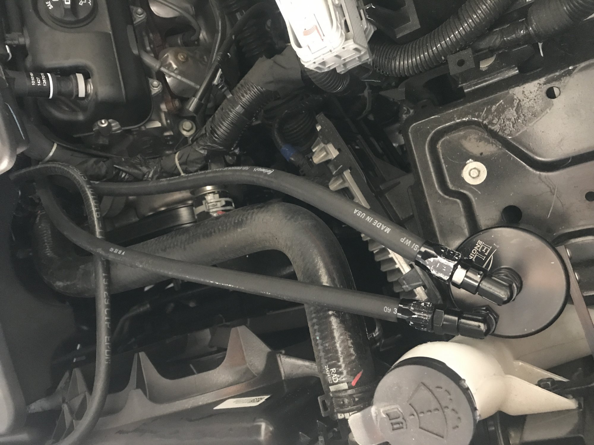

Just installed my E2 catch can on my 2017 silverado, within 10 min I have a CEL  service emmissions system alert from On star  didnt have this happen on my 2014  any ideas?
Need to see how you hooked it up.. sounds like a vacuum leak or check valve in backwards
No check valve, just 2 connections, the center of the can is hooked to the PCV barb by the throttle body, the plug next to it is hooked to the barb on the side of the motor driver side rear
checked can. It appears the bottom of the Can was barely screwed on I should have checked it. Would that have caused a leak?  I don’t think I hear any hissing now. Just the belt noise
The lines are backwards, the clean side (by the throttle body) should be going to to the exit port on the can, the dirty side to the center.
1 minute ago, ToesonTheNose said:
Do those ferrings look tight enough
I just now see your picture, is the center line going to the side of the engine and the other line to the throttle body barb?
5:20 of this video says center line goes to throttle bottle and the one next to it goes to side of motor.   My center line is going to throttle body
The video shows the newer style or 6.2L your dirty side has to go into the middle port on your can. Your dirty side is either on the side by the valve cover area on the drivers side or on the bottom area of the throttle body. The clean side is the barb on the top area of the throttle body. That line goes from the NON CENTER port off the can to the top side area of the throttle body
Catch_Can_Install_Chevy_GMC_2014_5.3L_6.
Copy that so on my 5.3. The center line now goes to the side of the motor and the non center line goes to my throttle body.   I appreciate the swift reply
Yes, the side of your motor is your dirty side that goes to the center of the can, the non center is your clean side that goes to the throttle body ?
Just to be clear, the throttle body barb should be near the top right (as you look from the front to back)
