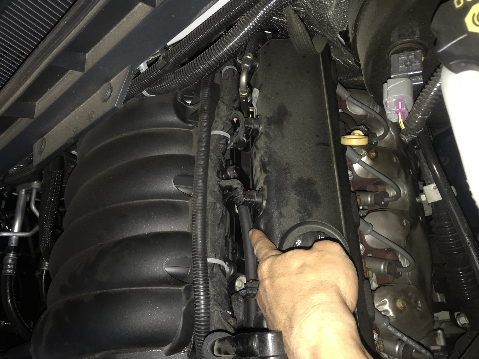

on my 5'3  the throttle body bard is below.   this video right here is my exact truck and he installs the center line of his can to the throttle body and the non-center to the side of the motor .  which was how I originally did it and now its opposite
  • Replies 698
9 minutes ago, SS502 said:
Just to be clear, the throttle body barb should be near the top right (as you look from the front to back)
No on my 5'3  the throttle body barb is underneath the throttle body  this vide is identical to what I had before I swtiched, you will see he installed the center of the can line to the TB amd the non center to the side of the motor
Well then I guess I gave you some bad advise, damn I’m sorry. See the pic mine is on top
And if you look closely below the screwdriver you can see the dirty out to the center port of the can.
On 1/6/2019 at 6:12 PM, ToesonTheNose said:
Ahhh. Ok. Heading back out to swap them around ahha
Man I feel like crap, I am sorry...here is a better pic of my set up...both barbs by the throttle body clean top dirty bottom ?
Yeah I have a port below my TB which is back to the center line and the other port is where I’m pointing.  I’m hoping that the can wasn’t tight and that threw the code
Yep, you had it right, I hope it was just a vacuum leak. Still feel like I sent you on a wild goose chase.
