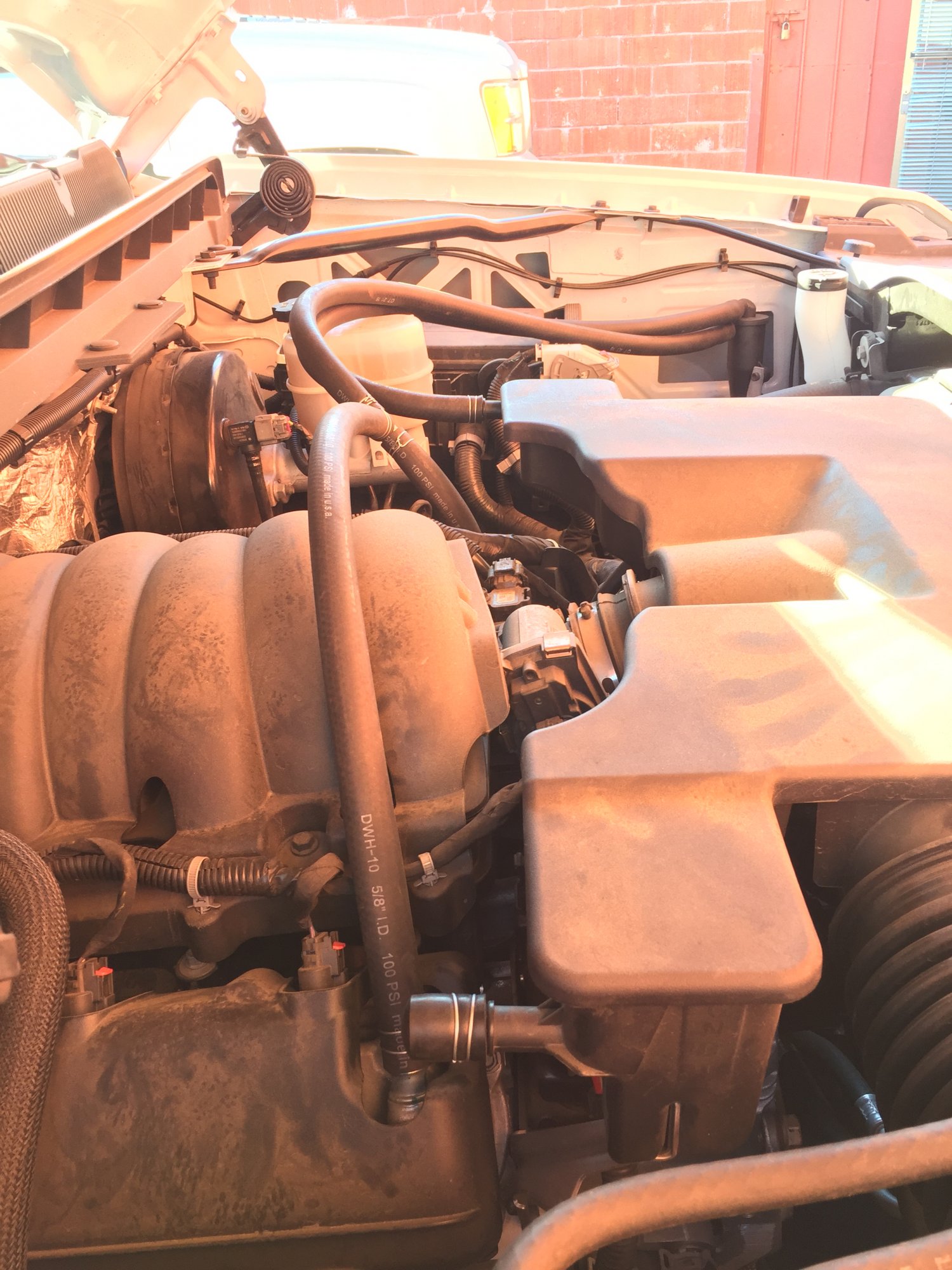

i think the difference would be the clean side connection seems to be on the top side of the TB on some engines (known years) but on my 2018 the clean side was on the side of the intake plenum
This is a representation of my 2018 6.2L please note that it is only to point out the clean/dirty ports on my 6.2L the clean side line appears too short in this picture. It’s not my engine (raining right now) but my ports are in the same position.

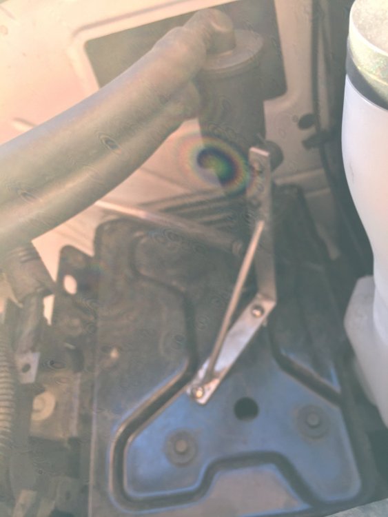

My catch can from UPR arrived today (fast shipping to Canada) and was waiting for me when I got home from work.. but it will need to wait a couple days for warmer weather to install..-35C is just a little too cold for that!

Got my RXP dual can set-up coming...
I never noticed that the small can is just a billet inline fuel filter with a hole drilled in the sie of it!
How much was that system? The internal filter image on their website is from a regular fuel filter.
You can get that filter on eBay for $18 Shipped and RX sells it for $149.00!!!
I would send that back as you are not getting any deal unless it's a FREE kit they sent you to test.

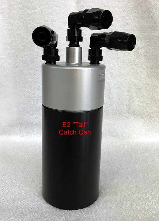

And because you have asked, we designed a taller version of our E2 Catch Can with more volume.  We already have our E2-X Ultra, which is a beast!  But now we can also offer our "Tall" E2 Catch Can.
This "Taller" E2 Catch Can holds an additional 4 ounces of liquid, which means less frequency required to empty.
And as with both our E2 and E2-X Catch Cans, they will outperform any other Catch Can on the market - period!  The proof is in the testing and what's caught in the bottom of the Catch Can.   In addition, we now offer our Catch Cans with quick connect GM style fittings.  Just ask for the GM Fittings during checkout, and we'll include them at no additional cost.

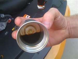

I have one of your catch cans on my Yukon and am happy with it. I empty it every 2500 miles and typically get this much out of it.
