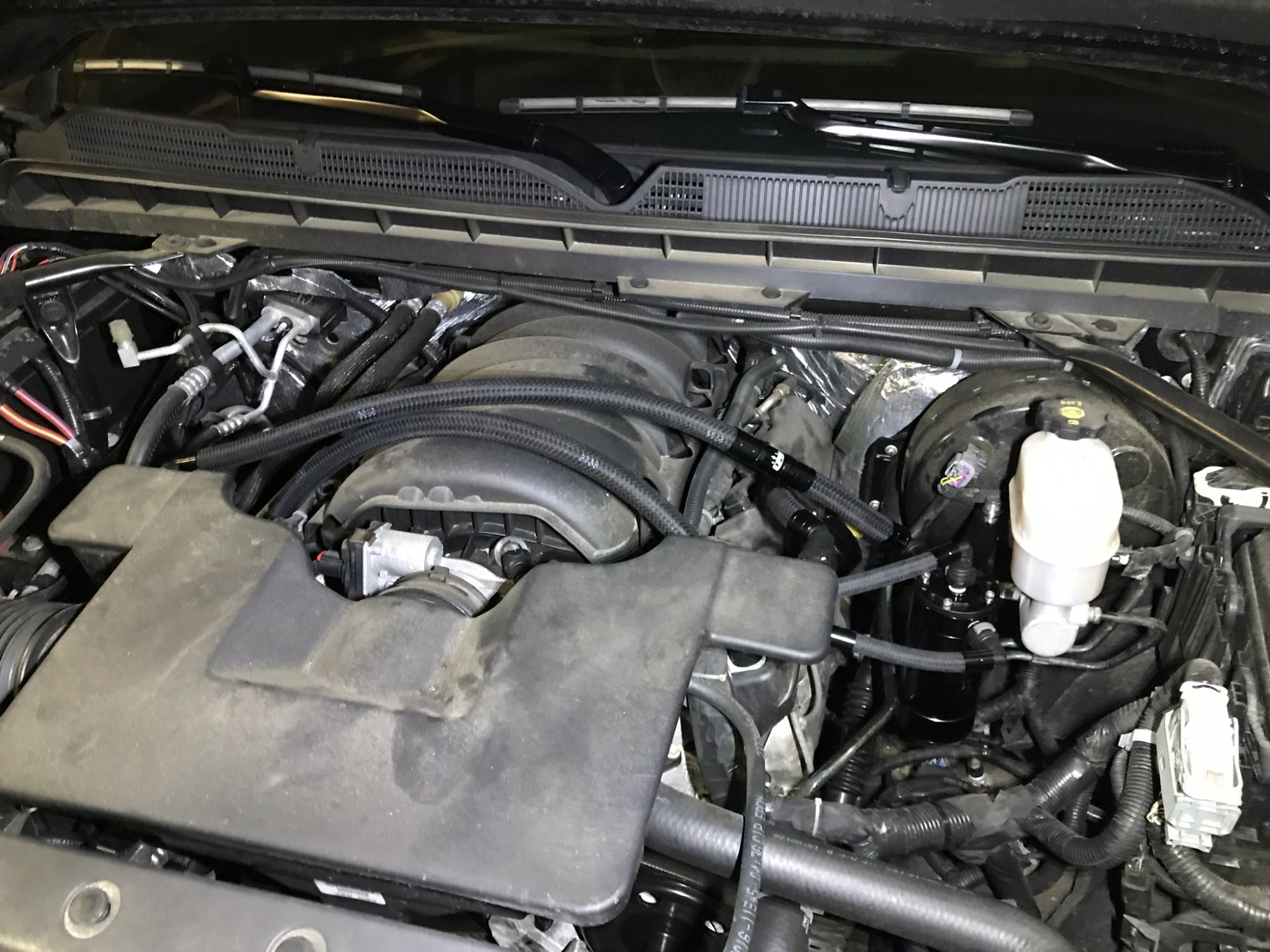

Just installed my dual valve with css UPR can tonight. The factory quick connections are amazing.
Can you show where you connected the hoses to your truck? I am thinking about buying a dual setup. Thanks

There are videos from RXP, UPR and Elite that show the entire install...if Geico was answering this they'd say "So easy, even a Caveman could do it"...
Seriously, see the top of this page for UPR video :thumbs:

I followed this video when doing the install. It is identical to the system I have. I think one connection is in a slightly different location if you have the 5.3.

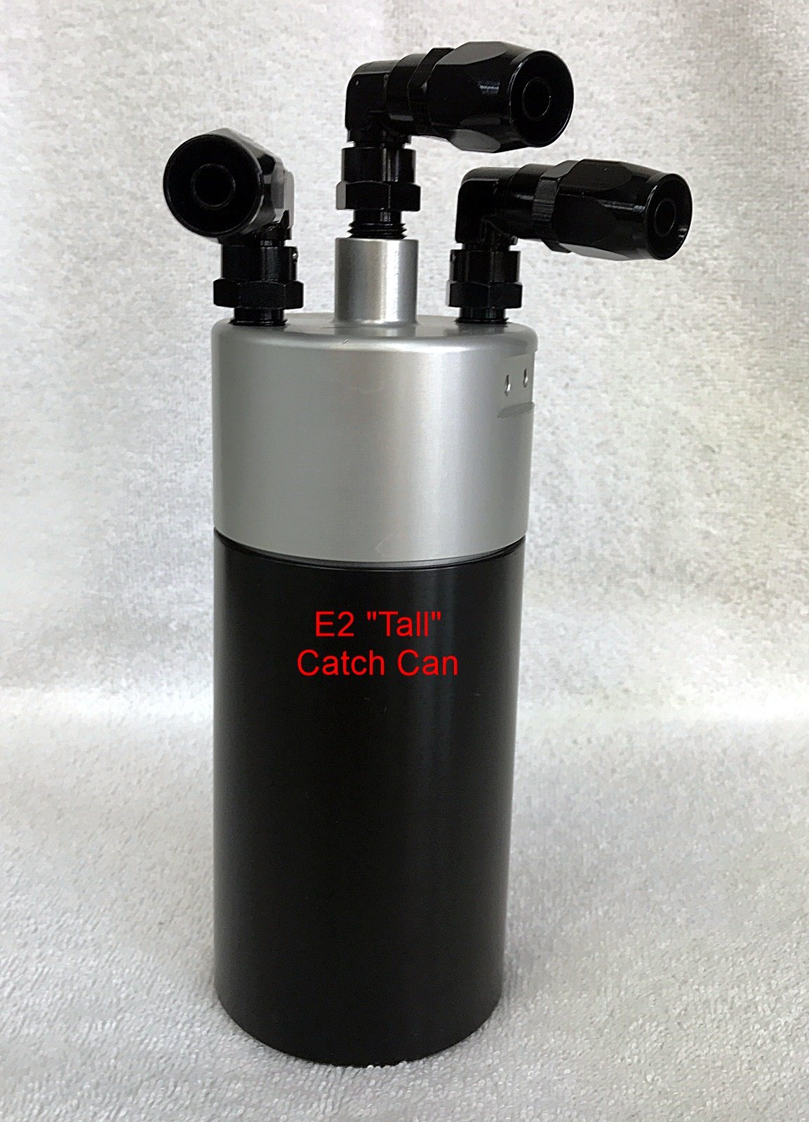

We have received a lot of requests to design and machine a taller Catch Can with more volume.  We already have our E2-X Ultra, which is a beast!  But now we can also offer our "Tall" E2 Catch Can.
This "Taller" E2 Catch Can holds an additional 4 ounces of liquid, which means less frequency required to empty.
And as with both our E2 and E2-X Catch Cans, they will outperform any other Catch Can on the market - period!  The proof is in the testing and what's caught in the bottom of the Catch Can.

Our E2-X Catch Cans come with a supplied ball valve bottom drain.  Our E2 Catch Cans have a removable bottom that unscrews to clean, empty, or inspect.   Some owners prefer the bottom drain, some prefer the removable base, so we offer both :thumbs:
