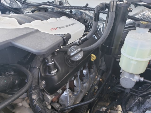

.. so I finally got the chance to install the single port UPR plug n play kit on my truck today. This is my honest impression of the installation:
-- Shipping was fast and arrived well packaged
-- instructions were supplied for 18-19 MustangGT Wipple charger w/CSS application.. not much help for a 18 Silverado 5.3. Fortunately with the help of this forum and YouTube the installation instructions were obtained.
-- mounting bolts on top of the can are located directly underneath the middle dirty port (I'm sure there is a logical reason for this.. they just could've been located elsewhere for my installation) which made accessing the bolts here difficult; in fact I ended up losing a washer trying to work around the port.
-- the quick connect fittings and hoses are AWESOME.. (large reason I was swayed by the UPR can). The 90 fittings are easy on/off like OEM with a single press point. The straight fittings are much more difficult to remove as they have double press points and these end up on the motor end where access is limited.. but they are still fantastic.
-- both hoses were routed alongside each other then under my engine cover.. there is just enough clearance without modifying the cover; however I will add some split loom at this point for added protection. The dirty line then runs along the intake following the original path hidden by the cover.
   The final plug n play install ended up looking much cleaner then I had anticipated and I am happy with the result; however I will still probably end up relocating the can to the front corner of the engine to free up the area around the oil fill and dipstick in the spring when the weather warms up.

Agreed! @STRMTRPR was very helpful in my quest to emulate his look. I replaced the Cadillac cover with a USAF badge. When I relocated my catch can to the fender, I made sure my hoses all went under the cover.

Thank you for your help in the cover, by relocating to the front fender/spare battery area, it allows clear access to oil fill and dipstick.

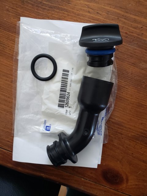

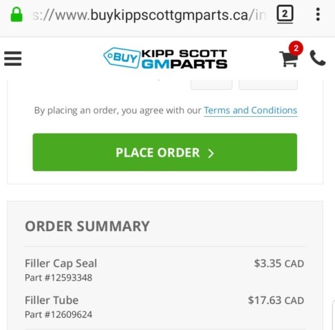

.. ok so I'm pleased to report that my plan to access my oil fill unobstructed by my catch can lines allowing me to leave my catch can in it's present location worked out great so far and install was plug n play!  :thumbs: .. I will update again after I get some driving time on it but here's what I did (part # used are in screenshot)..
- oil filler tube extension
- filler tube extension seal
.. this moves the oil fill cap up and forward of the stock location .. both clearing the catch can hoses and making adding oil easier by bringing the fill point closer to the front of the engine bay. I've attached pics from multiple angles to clearly show the result.   For the ~$20CAD OEM parts required I'm more than pleased.
.. added a drain ball valve to attach a hose for easy empty.. wish I knew UPR offered a solution when I purchased my kit but you know what they say about hindsight!
.. I also noticed that the can fitting to the manifold had been leaking.. obvious discoloration of the teflon tape.. I'll be removing the fitting and resealing this as well. :(

That worked great! I may get one even though I have a clear shot but it still takes a funnel due to the angle. Is this a direct fit on our engines? I had seen where someone got one off a older Suburban and had to Dremel it to make it work but it was a little wobbly. Looks great and thank you once again for the help!!
..I made no modification at all to this tube.. just unscrewed the oil cap.. screwed on the extension tube with seal and put the original cap back on. This tube has the slots for the tabs located 90 degree from the original cap so the tube faces more towards the front of the engine rather than straight up (this is the result I was after as my oil lines are directly over top the oil fill cap.. I wanted a clear shot to my oil fill and dipstick which is I have now)
