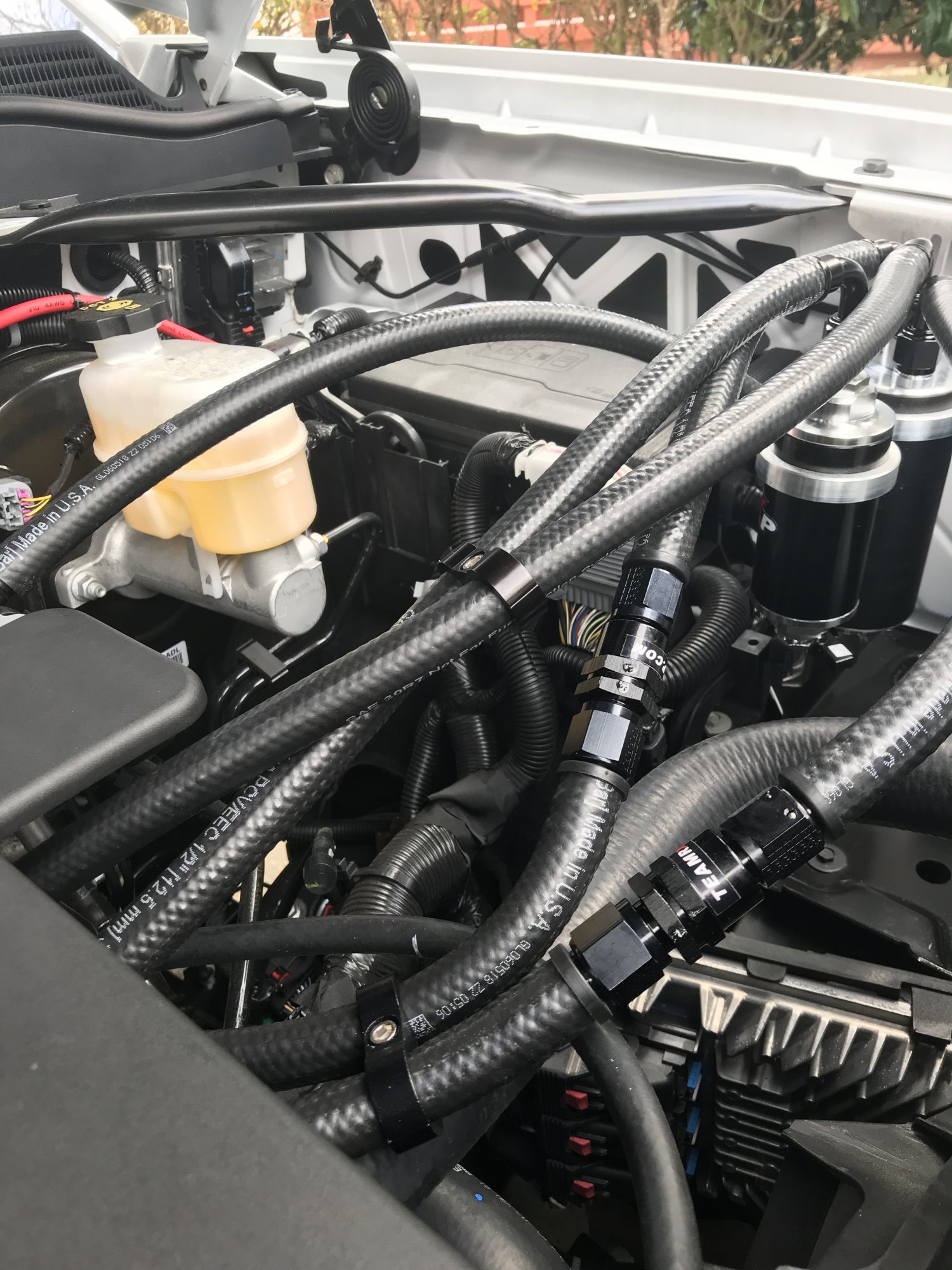

New PCV and install/relocated completed.
I have mine off the fender and it allows uninterrupted access to the oil fill and dipstick. To empty, I just slide a small pan under the cans on the spare battery tray, open the drain valves and let them drain. No mess whatsoever.

So I re-read the thread and came across this. Maybe I'm overthinking the location thing.
Well there you have it! It’s gotta be next to the engine block or headers lol...I’ll keep mine where it’s at and let it keep doing it’s job :thumbs: Oh and as for the plumbing, it’s probably just that most people aren’t running a dual can setup. My lines are completely out of the way too.
I think we are good on the locations! We may have them in the colder part of the engine, but they are still in FL and CA, which are the warmest areas of contiguous USA! By this logic, it should be fine anywhere on the vehicle as long as it's still in CA or FL.
