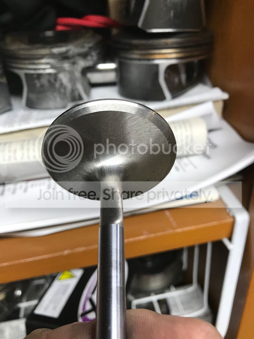

And a LY7 GM 3.6 Port Injection engine at 115,000 miles:
Cleanvalveson%20LLT%20114k_zpstqzcuuv2.j
As you can see, wherever the fuel makes contact, zero deposits form. Th valves were kept cool and clean, and for the past 30 years app. valve guide wear had disappeared where the old timers will remember coking of the old carbureted engines pre-Fed mandated detergent fuel additives had to be done every 30-40k miles.  Port fuel injection combined with detergent additives eliminated this.

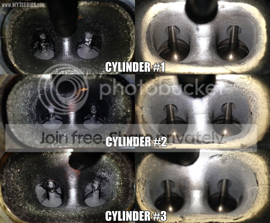

Now, what happens with GDI?  Not fractions of a gram, but ounce plus is commonly removed from the intake valves during a manual cleaning. Here are examples: (Note, I am including examples from several brands of GDI engines to show it is universal, and also from mild to extreme examples. MOST GDI engines built in the past 2-3 years have far less rapid build up than GDI engines form 5-10 years ago due to internal separation, adding in small port injectors, and other advancements I will cover later.....not all good)
LT1%20intake%20valve%20deposits%202_zpsx
ValveBuildup%20before%20and%20after_zps4
DI%20valves%20at%2040k%20miles_zpsamoe32
So note, the amount will vary from valve to vale as it is never an equal amount. Those closest to the point of ingestion, both the PCV vacuum access point and the ports closest to the throttle body will also build faster and more severe. What occurs then? Look at a valve when it comes new. Note the shape, the undercut of the stem, the seating angles, and the satin swirl finish on the valve tulip itself. All of this has an impact on flow and velocity. Both are critical for an engine to run at peak efficiency:
So, what does this mean to the average 5.3 or 6.2 LT based GDI V8 owner?  Well, at 20k miles when we do before and after dyno pulls to show what was lost and regained from a manual intake valve cleaning, the average regained/restored power is 20 whp.  That also results in 1-2 MPG.  As the degradation is gradual, not a single owner over the years that signed up for the study thought they had lost any power, but after wards were surprised as it is night and day:

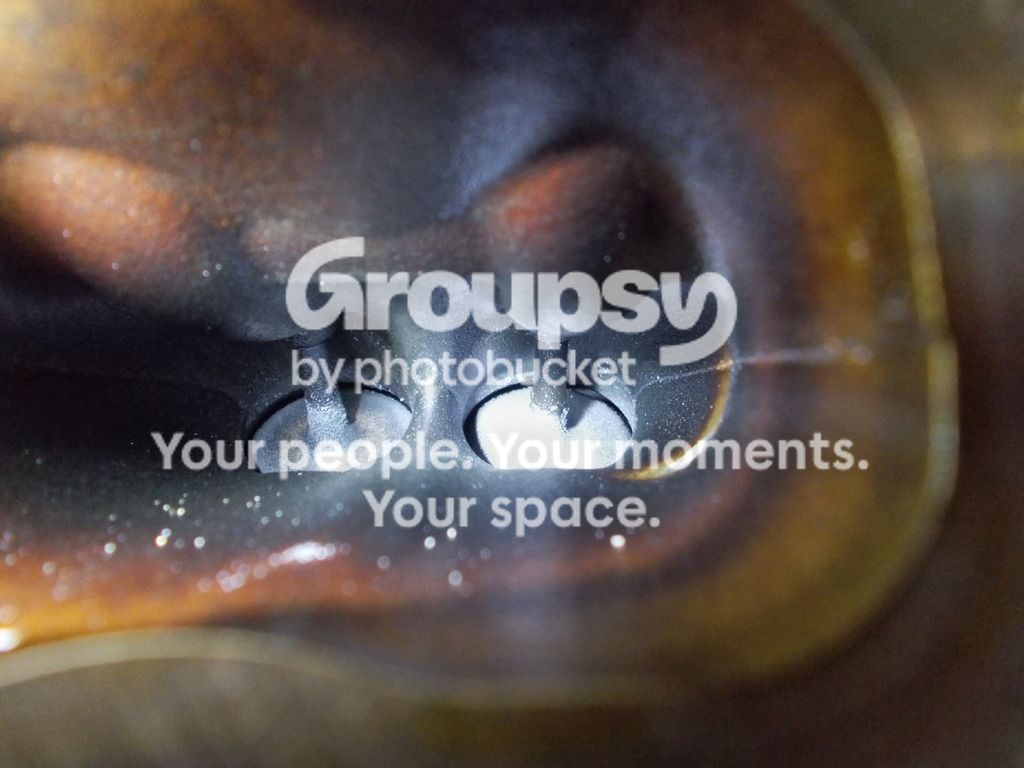

This shows with the system installed within 100 miles of new:
This is without (same year, same 3.6L V6 GM engine):
So that may not be impressive to some, but think about the valves and how they restrict the incoming air charge when coked up as such. As no two are equal in severity, the cylinders will receive unequal amounts of the air charge meaning as each bank the injectors are commanded to deliver the same amount of fuel per cylinder as the exhaust is measured as an aggregate of all cylinders. Some will be too rich, some too lean, and 1-2 close to stoich. The worse the buildup, the greater the disparity.

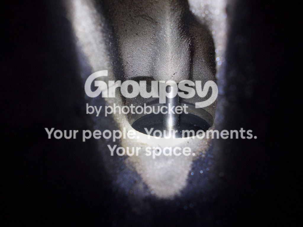

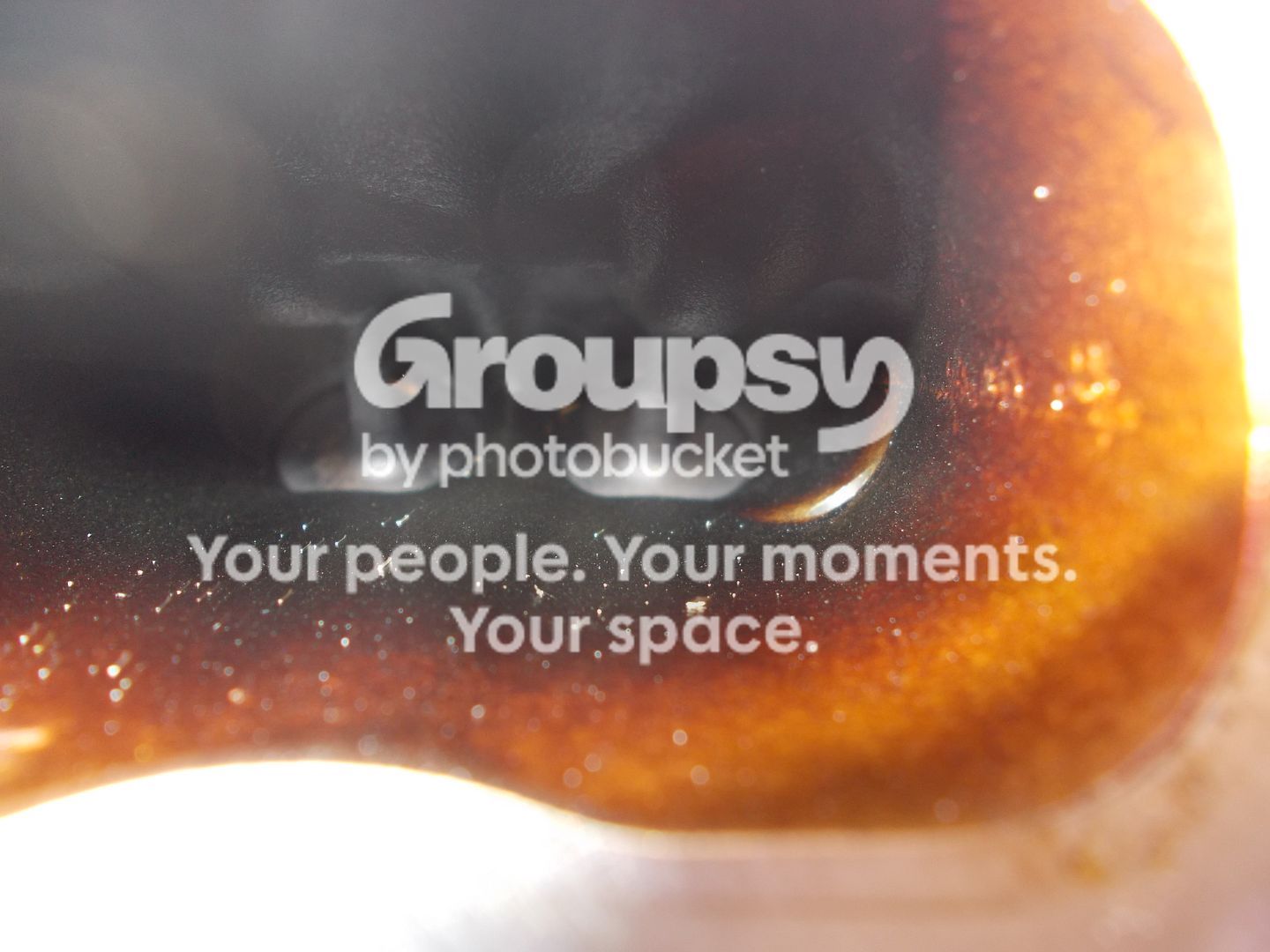

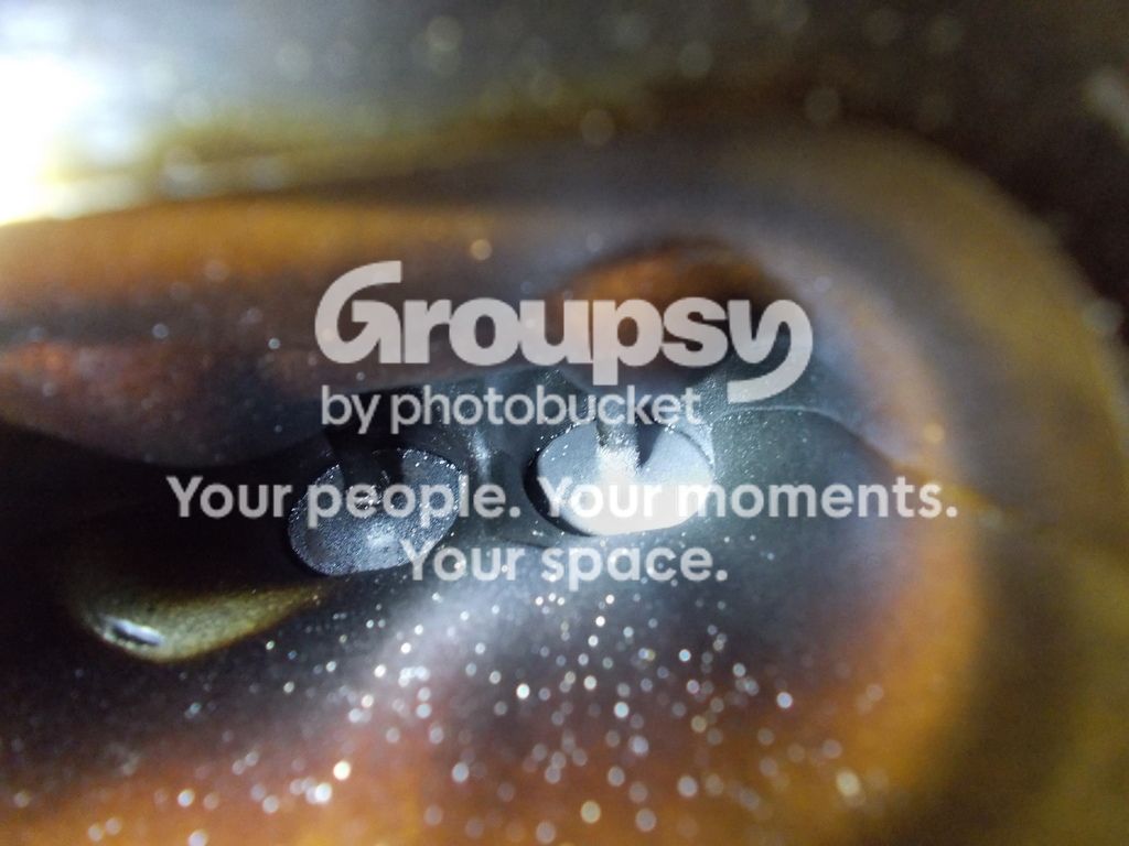

Here is a test I'm going to do and document. For all the fellow 14+ owners on this site. In coming months I'm going to walnut blast my intake valves. I've been following issues with DI from various mfg's since say 2010~on. Cases of buildup and the detrimental effects are well documented across the net.
I have had a basic Elite catch can installed on my 2015 L86 since about 3k miles from new, now
approaching  60k miles.  Will take pictures when I pull my intake so we can see what shakes out. I clean out my can every 1~3k miles, Have pulled as much as 2~3oz at a given time. Much rather would pour it out than be ingested.

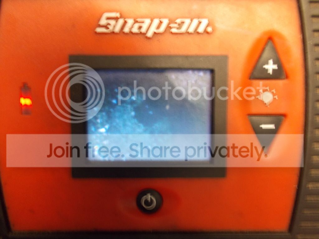

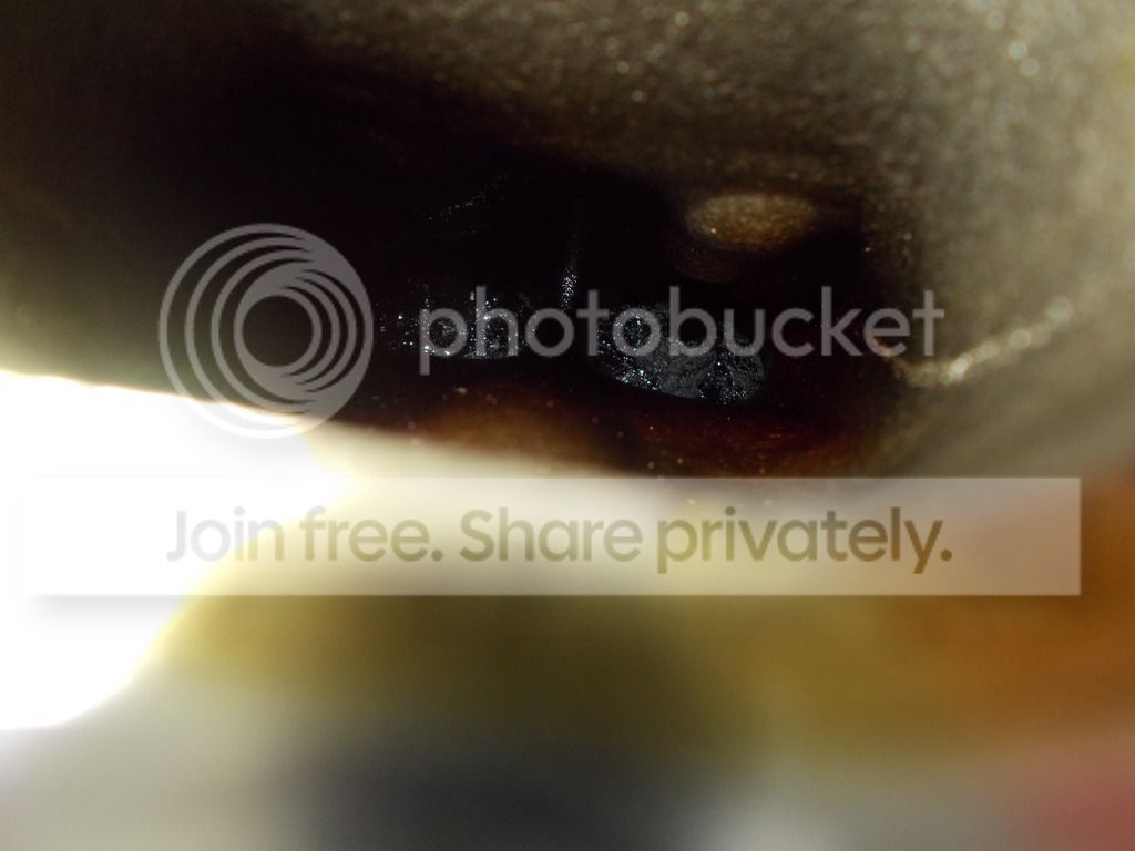

Looked inside my TB the other night and could see a brown film in the intake runners that was not horrible , but no where near clean.  This may not be a definitive test, however it will be a "real world" example one way or the other. And no I'm not going to dyno it twice, not that important to me, but I do expect to gain back mileage and HP after the walnut blast. No GDI intake cleaner for me.
I appreciate Grumpy's input, however this one is not a myth. The ways to approach the problem are mostly bogus, but the fact that it occurs and degrades performance has tons of evidence. Done years of research on this topic and fully believe a catch can (you figure out which one works for you) and blasting using the correct media is "the Way". When I find out I'll share.

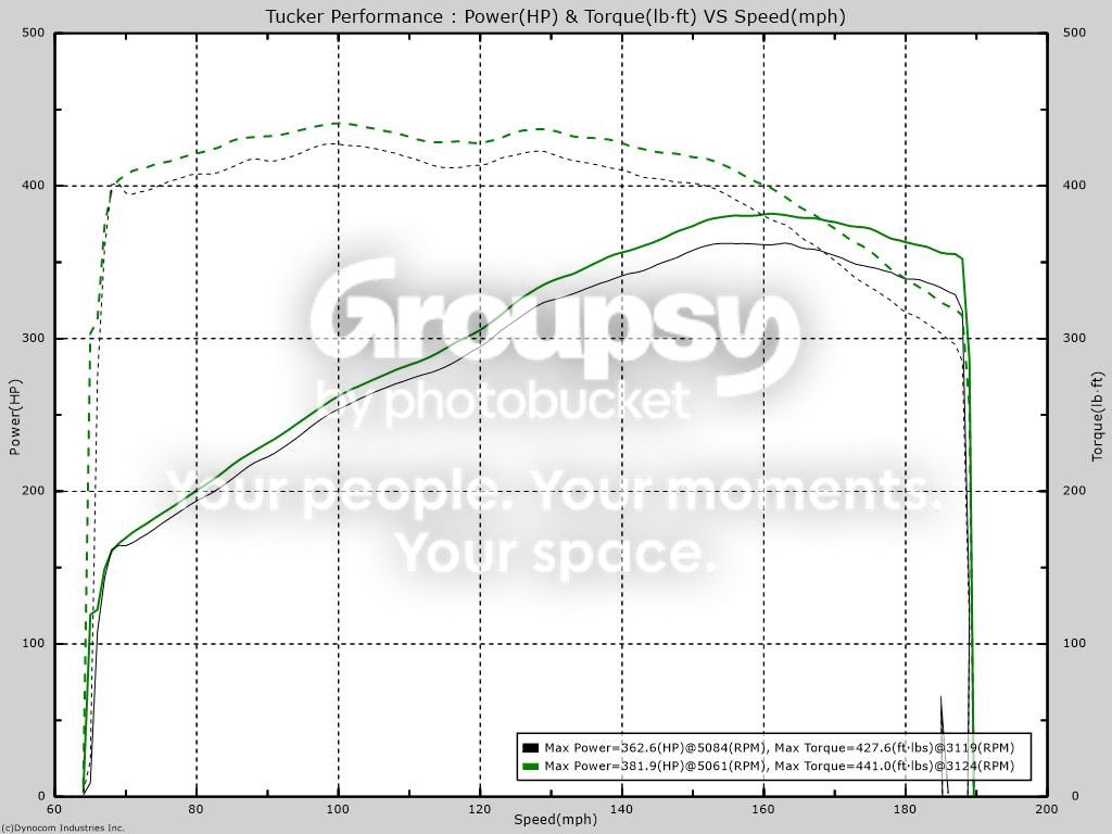

Here is a recent oil analysis done by a long term field tester. His goal is to determine how the system impacts engine oil. This was done at just over 13k miles and it is a twin turbo GDI engine making over 20# of boost, so it is subject to more stress on the engine oil than the average passenger vehicle.  His next drain and sample will be done at 20k miles. Note the lab techs comments:
Falcon%20long%20term%20testing_zps7l9mvz
