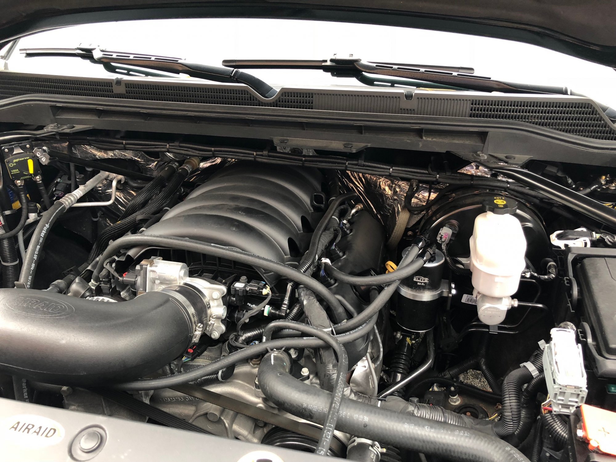

Installed
I see you only have a single valve catch can, but you still connected the valve covers together instead of running them to the intake tube. I thought you could only connect the valve covers together if you were using a dual valve catch can. Also . So could you connect the valve covers together even without a catch can? Either way with or without a catch can , wouldn't that create allot more pressure and work the pcv valve more? Would that create a flow restriction due to only being able to evaluate crank case pressure through the pcv valve and nothing through the valve covers? Your picture shows the type of setup I was thinking about but I didn't see any of the manufactures of catch cans connect the valve covers using a single valve setup?
He has the valve covers connected because he has the Clean Side Separator installed in the Oil Fill location.
