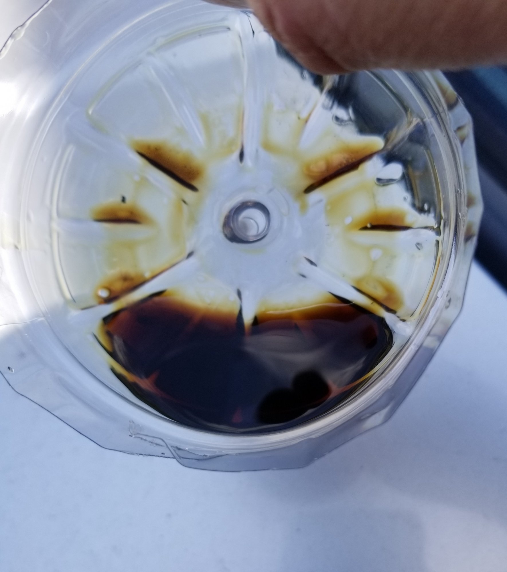

I dont understand how when people post pictures of what's in there catch cans. It looks like chocolate milk. This is the second time I've drained mine. 1000 miles each time just to see.

The colder the weather, the milkier the substance will be.  When it's cold, you get more condensation or water coming out which makes it milky.  I just drained my elite can the other day and it looked like yours.  But earlier in the year it was milkier due to the cold mornings driving to work.

 In fact, oil is a very small percentage of what is caught. Without going into real deep analysis, here is the average makeup of what is trapped in one of our Catch Cans after a 2450 miles trip and drain when spun in a centrifuge and then analyzed.  70% of the contents are acidic water (water and sulfuric acid are both produced /released during the combustion process and need to be removed/evacuated from the crankcase before settling and contaminating the oil), 23% was unburnt fuel (raw fuel reduces viscosity and the oils ability to protect). and 7% was oil filled with abrasive particulate matter (carbon, soot, ash, etc.) so as very little true accurate information is available on any of this, oil is what most assume is being caught, so the decreased wear extends engine life. The removal of oil mist reduces detonation and allows less carbon build-up and for the engine to run more timing advance and make more power, etc.
So there are a good number of benefits but education on all that is involved with proper crankcase evacuation is so critical. We at Elite Engineering USA have made it one of our priorities to help educate the consumer and sort through all of the misinformation and incorrect assumptions.
