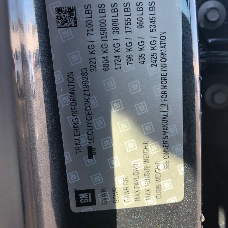

Would someone be able to post a picture of their trailering/weight capacity sticker on their driver's side door jamb like in this link:
https://www.tfltruck.com/2018/10/2019-chevy-silverado-1500-trail-boss-tow-payload-specs/
I'm interested in the Rear Axle Weight Rating for a 6.2L with the max trailering package.
LTZ CC Short box 6.2 max tow. Truck has all available options except running boards if that makes any difference.
Thanks!  Out of curiosity, does your truck have the 20" wheels?
I'm wondering if the RAWR is limited by load capacity/range of the factory tires moreso than the 3.42 rear end and axle.
Yeah, it has the 20s and Bridgestone Alenza tires. Theoretically you can get an LTZ with 18s. But I’ve yet to see one actually equipped like that, and I’m not sure if it would increase the ratings.

LTZ crew cab short bed 5.3
Convenience Pkg 1&2
Safety Pkg 1
Trailer Camera Pkg
Z71 & Protection Pkg
Sunroof
Payload: 1755lbs
Edited by UGADawgs
Why does a sun roof change the max payload?
My new 2019 Sierra Denali 4x4 Short bed rated @ 1486 lbs
My old 2016 Sierra Denali 4x4 standard bed was @ 1396 lbs
