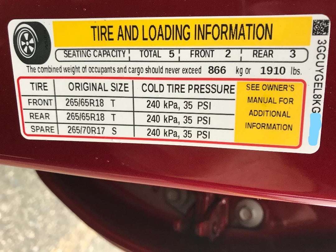

Think about it.  How can payload capacity that is specific to each truck include arbitrary weights?  And people will not necessarily be towing, so why include a 70 lb hitch?  This is the payload sticker from my truck.  Read the definition of what counts as payload.  You're confusing max tow rating with payload capacity.  They're two different things.

That isn't the payload sticker - that is the tire pressure sticker.
The serial number of the truck is on the sticker.
The pressures listed are for the tires that were installed on the truck.
There will be a second sticker on the door post.  It is also printed specific to the vehicle/serial number.
Down near the bottom.  Easy to miss.  (other posts have pictures of the payload sticker)
Similar to the tires pressure sticker, they know what options are installed by serial number and establish payload from those numbers.
Any accessory added at dealer or by owner, that wasn't on the factory order, is considered 'payload'.
