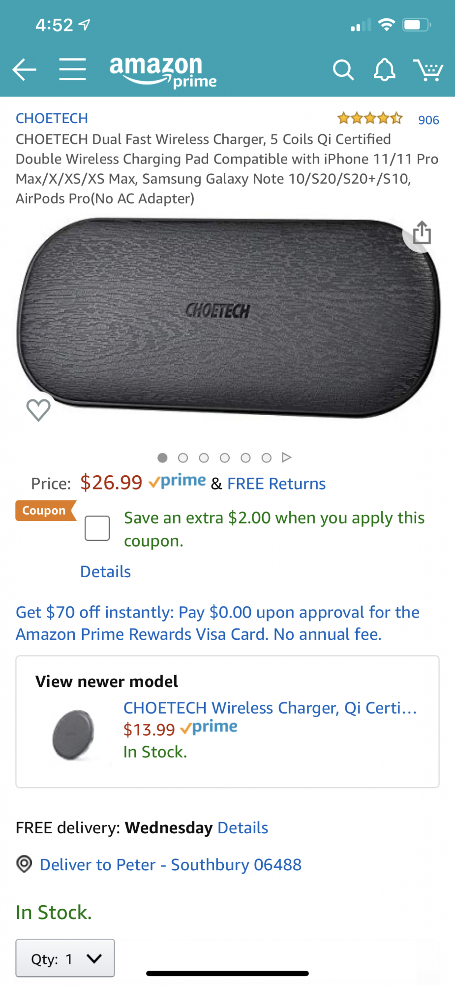

I just ordered this wireless charger which others on this forum have installed (I think...) in the center console lid.
CHOETECH Dual Fast Wireless Charger, 5 Coils Qi Certified Double Wireless Charging Pad
here is the issue:  the charger works when I plug into the wall outlet. When I plug into the USB in the center console the light comes on but does not charge when a phone is placed on it. I tried a regular charging cord plugged directly into the phone and it charges, so it is not the USB outlet in the truck.  I did this without mounting it, just loose on the center console, so it is not the thickness of the lid and cover on the phone that prevent charging.
any suggestions?
thanks for the help!

The USB on the dash probably doesn't carry enough voltage or watts to run that thing. It charges phones slow...
I bet it carries enough to power the LED on the device, but not enough send power to your phone. Try to hard wire it??

Hard wiring is an option, but would prefer to avoid having to tear apart center console. I am wondering if getting a USB C to USB C cable would work. The plug on the charger is a UBC C but the other end of the cable is the old, larger USB connector. I see cables with USB C on both ends available. I wonder if there is more power supply using the USB C jack in the console?

The built in USB ports didn’t provide enough power to effectively power up the coils in my charger mod either.   Run a hot wire into the console and use a quality 12V USB adapter to power the charging pad.
Also - you don’t have to tear apart the center console to run a wire, you can easily tuck a wire up under it, and the rear of the console (where the vents are) comes off extremely easily, so you can access the inside of the console.

Even plugged into the smaller USB-C outlet?  I thought those charge faster.

The only way to know for sure is to test with a meter. I bet that they are both the same though.

I had the same issue.  Found this adapter for the cigarette lighter and has higher output.  Then invest in some right angle usb/usb-c plugs.  I didn't know that middle piece came up like that on the console.  I might have to try relocating mine underneath like what you have pictured.
