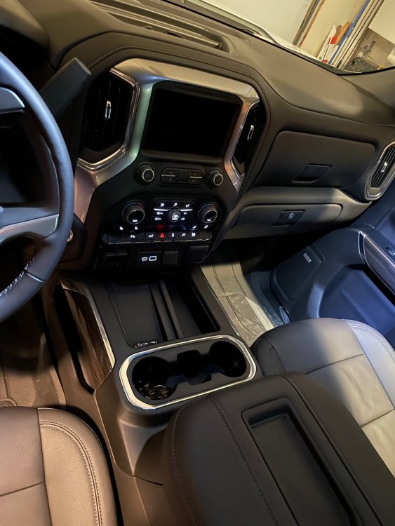

I did mine myself in center council of my 19 Trailboss. Went really well with a little work and some ingenuity! Cut apart a triple coil charger off eBay. Paid $12 for it a couple years ago and wasn't using it anymore. Opened up the bottom side of the lid, ground it out with a Dremel tool, glued the modified charger in place, ran a charging cable from the USB in the counsel to the charger thru the hinge, put it all back together and it works awesome. Radio has to have power to it for it to be on!

Easy peasy...under $30. ..Go to Amazon or EBay and get the full console or arm console insert tray and a wireless charger with USB pigtail. (Get a separate tray and charger...been there tried that, .the trays with a built-in charger are as crappy as the OEMs and need a sweet spot for charging and cannot charge through a protective case). Has an indicator light, but no need to even look when charging, a large sweet spot just throw the cell phone onto the tray pocket close the lid, leave it there and use the Bluetooth connection. In cae you forget to take it, it is in the console safe from prying eyes.

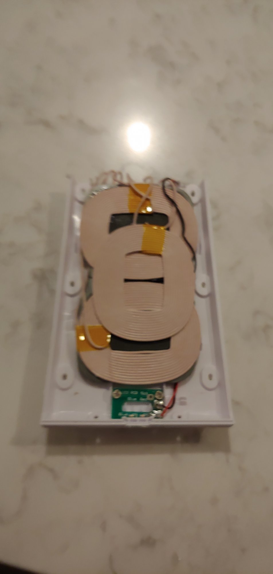

Was going with the before mentioned single coil disk.... But decided to step up my game to 5 coils!!!! ?
Will be installing tomorrow... Will report back.  Size is almost the exact same size as the phone tray in center console, so should work beautifully.  Going to tie the power into the rear 12v.
Here's the part I used:
https://www.amazon.com/dp/B07PYQQ1R7/ref=cm_sw_r_other_apa_i_R2ZwEb6850DQB
Getting the cover off this larger one was infinity easier than the small disc one.

Fit was perfect... Epoxy is drying now.  Then have to do the wiring.  Will post complete install pics later this evening.

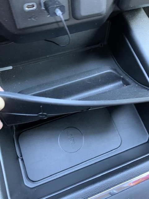

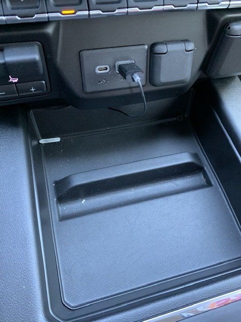

This is how I decided to do it for now. Want to wire it in so I don't lose the USB port on the dash.

Some pics of the install today.  Epoxy isn't pretty, but can't see it at least.  Drimmel made short work of the plastic tabs.  Wired into 12v at rear.  Works good.  Size is perfect.
Edited by Swiftks
