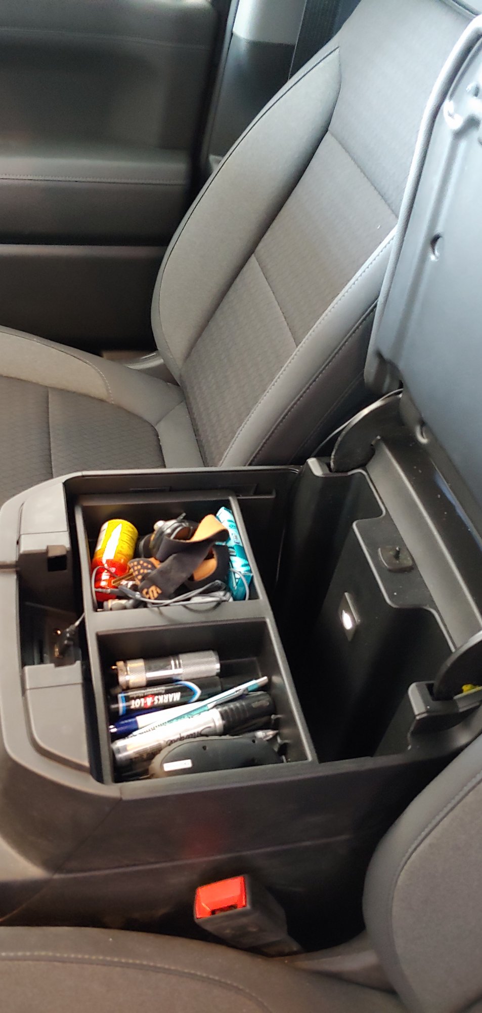

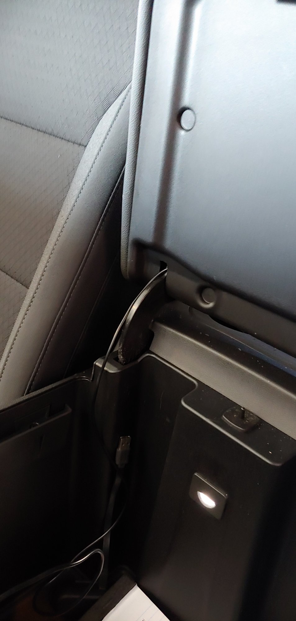

Ben,
Can you create a seperate new post on how you added the wireless to your 2019? Can you post the details and parts (link) that you used as well?
46 minutes ago, Ben Berkenpas said:
How do you get the inside part of the lid apart?  Is there clips or screws I'm not seeing?  BTW. You may be my hero of the day!  That's freakin awesome and exactly what I was looking for.  I think this should be a sticky.  I think the secret is the 3 coil charger to make it work well
That inside cover is really just compression fit.  I took a small putty knife, got one corner started and it all just pops out.  there's little pegs that go into rubber grommets so when you're ready to put it back on you just push it all back in and it's good. You do have to make sure that you're pushing the button on the council that you normally would push to open the council while you're poppin it off as those two little ears that go in and out will hinder that cover from coming off
Edited by Ben Berkenpas
  • Thanks 1
16 minutes ago, GMC-AT said:
do you guys have a link to a charger that easily comes apart? that I can use for this..
The one I used is like 3 years old. This one looks very similar. (but no guarantees). Because you won't be able to see any part of it I would think any 3 could charger would work. You'll just have to take it apart (mine had 12 tiny Philips screwdriver holding it all together then I cut some if the plastic off with a Dremel)
https://rover.ebay.com/rover/0/0/0?mpre=https%3A%2F%2Fwww.ebay.com%2Fulk%2Fitm%2F252760579426
Check this out.  Taidacent 1 pcs lot Wireless Charging Technology Three Coils qi Standard DIY Modified led Low Heat Wireless Charger Transmitter Module https://www.amazon.com/dp/B07176HT5T/ref=cm_sw_r_cp_apa_i_mjCCCb8EEG3YV
Most Fast Chargers are capable of 18w and most phones can not accept that much. 15w is probably max right now. 5w would give you a 1st gen charge, no Fast Charge.
