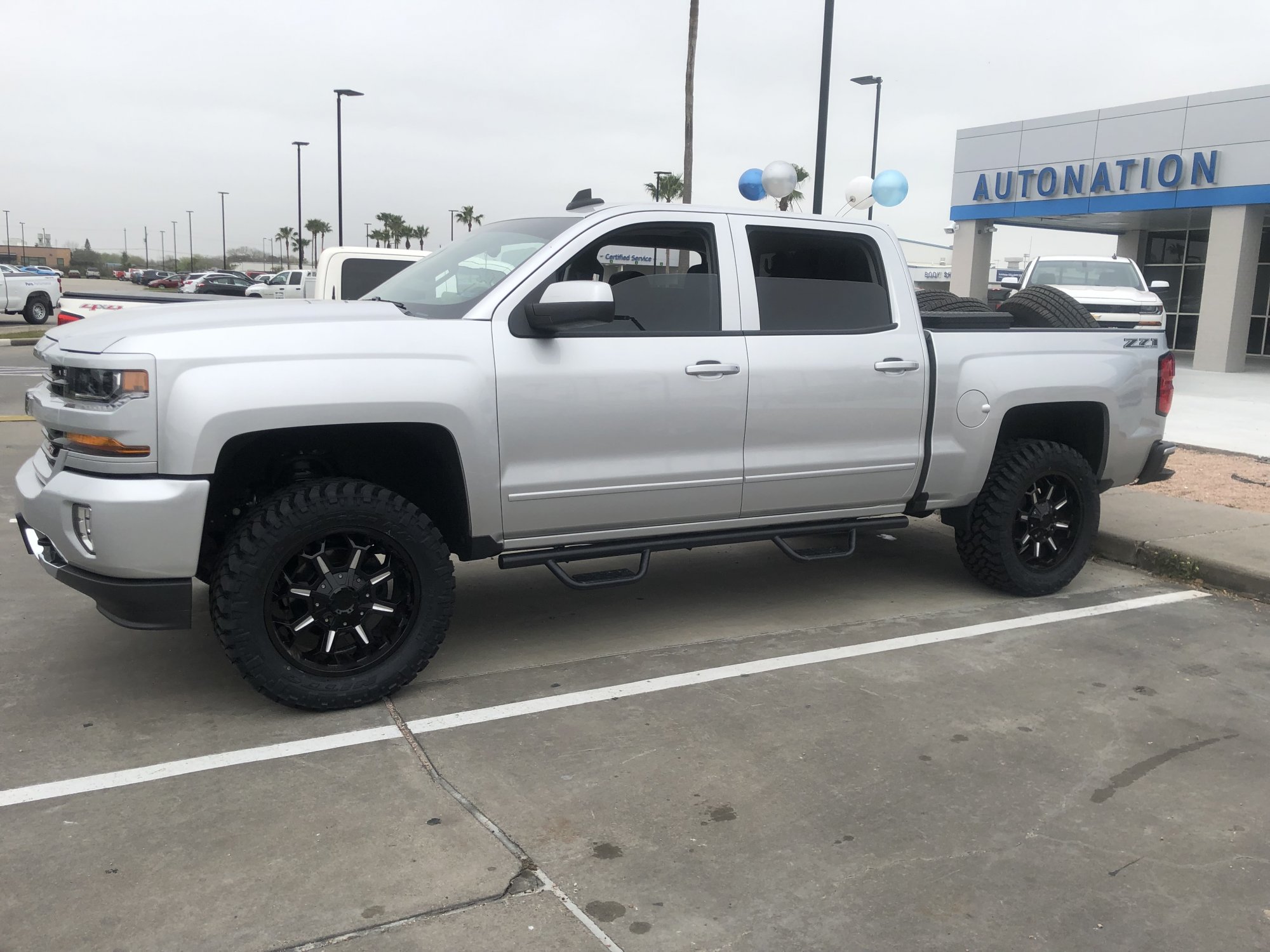

Ok I’m new to the Chevy world and doing any type of mods to a truck so bear with me, I have a 2018 1500 Z71 and I put a 3” front and 2”rear lift/level kit, I put 33/12.50/20x9 with no offset. I have some rubbing on the spring and control arm and was curious to know what anyone thinks about adding spacers and if so what size and how much trimming?8E0F066B-15D4-4BD0-8505-CE035D402C0B.thumb.jpeg.ff1f395f1e8ba765e2ee68b3c81f19ec.jpeg5A76B073-D2E7-4DCA-8845-8D10B4DBEFF3.thumb.jpeg.e6f759ab334aafb62199b1714818a01b.jpeg
When you say spring you mean rear leafs? Im paranoid so I get 1/2" any more than that I get nervous about the wheel stud to lug nuts.
Sorry I misspoke it’s the coils in the front, that’s where the rubbing is

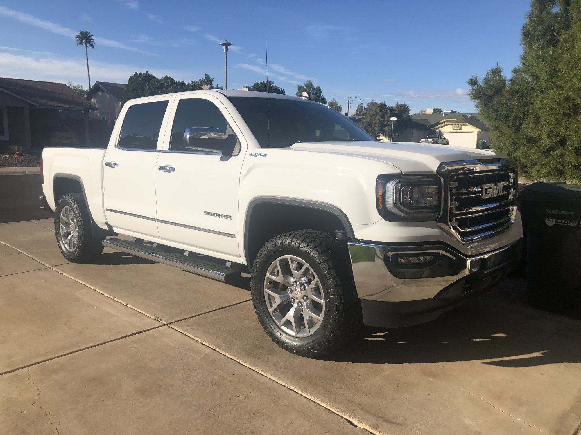

I probably would have gone with something smaller.  Your 20x9 with a 0 offset already stick out 1" more than stock 20x9 wheels (the ones with 2" spacers pictured above).  I would have tried a 1" instead, but then you would have to trim the ends of the studs so they dont touch the back of the wheel.  3" is a decent lift in the front and you may be OK, but proceed cautiously.

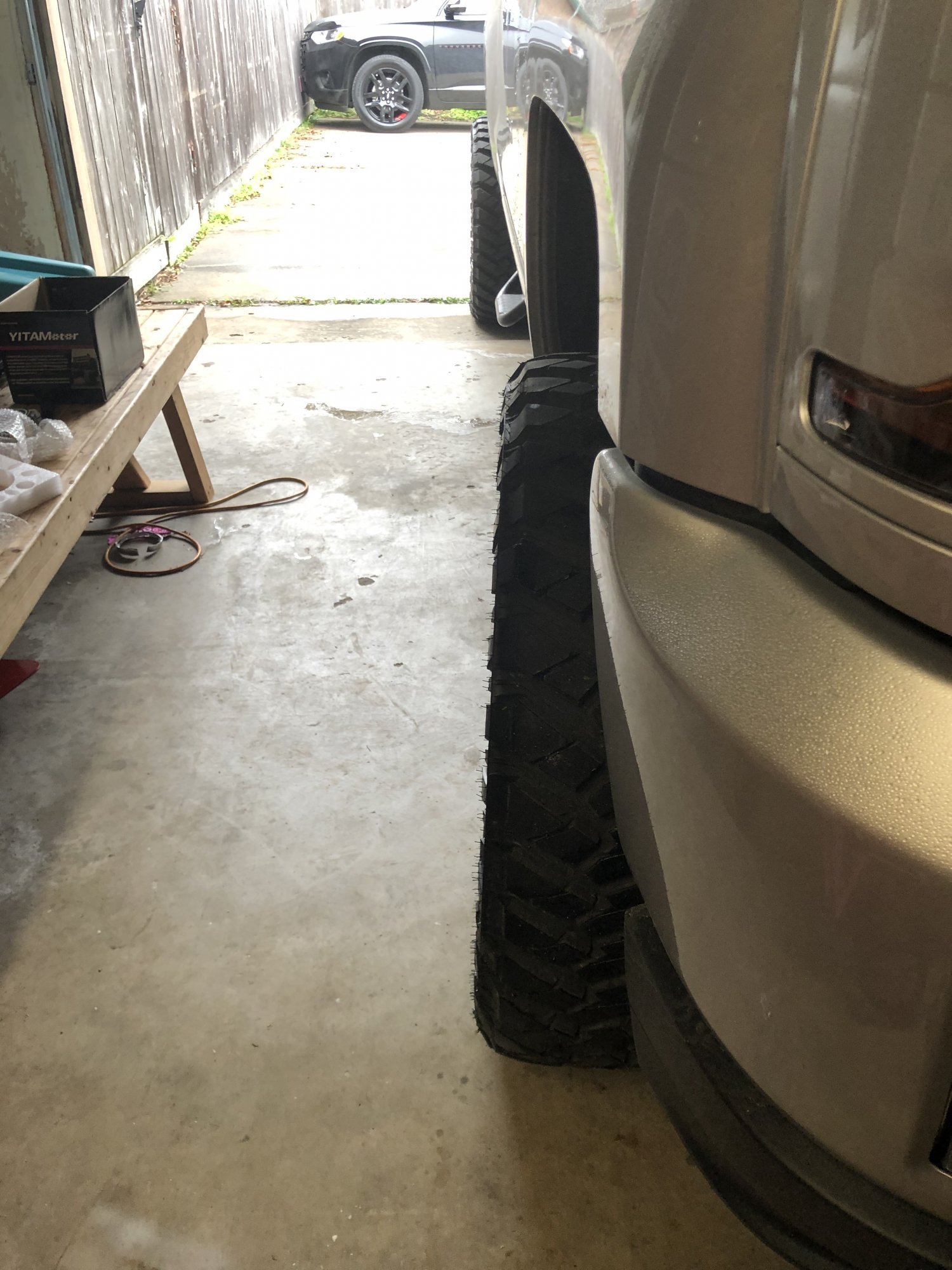

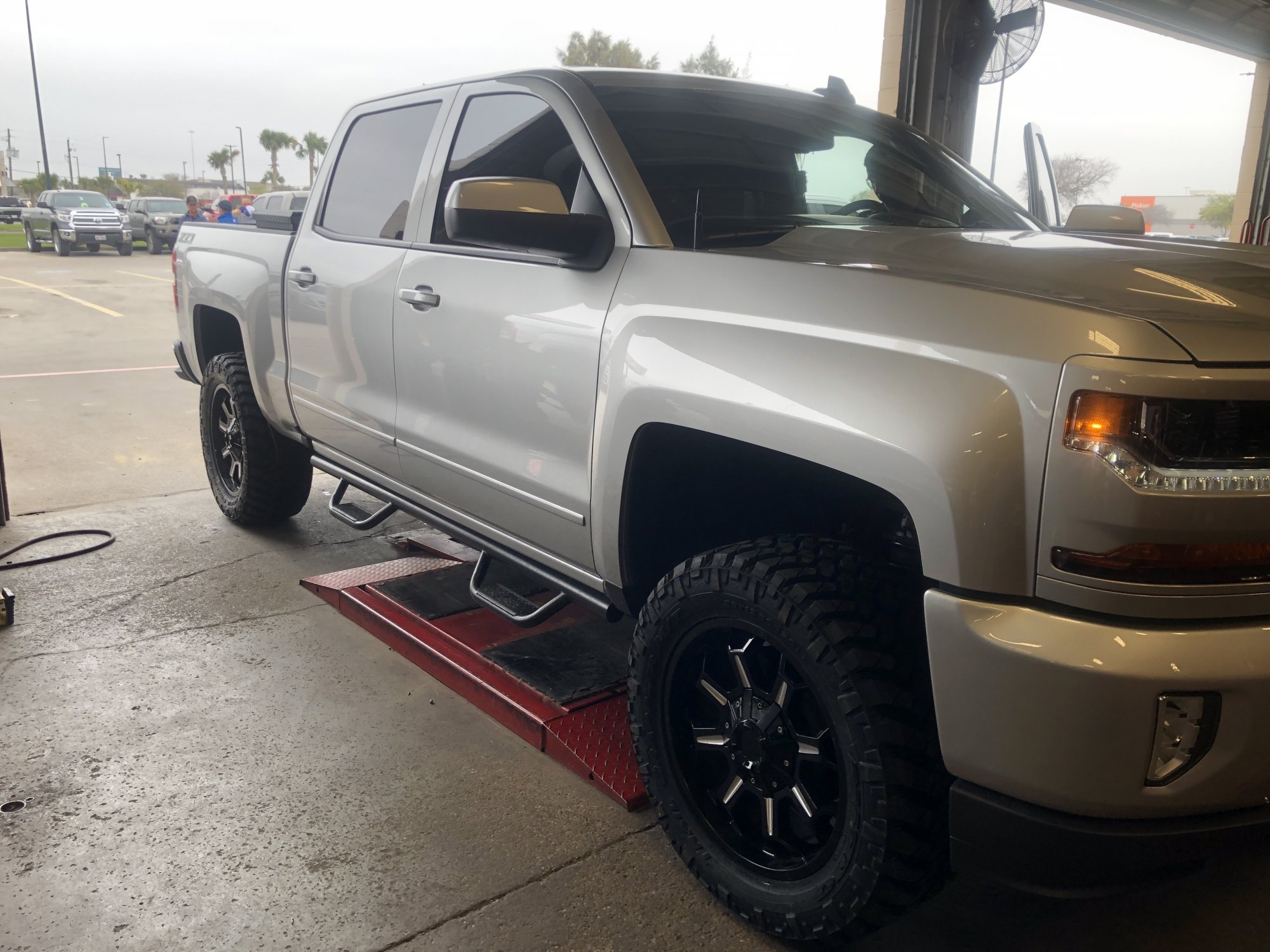

Ok so they finally came in, here’s how it looks.

It does rub with 2” spacers but only in the back of the wheel well, I’m going to NorCal trim it tonight I’ll take some pics tomorrow once it’s all done
