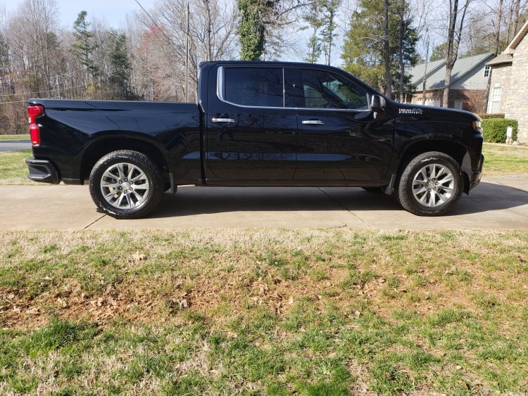

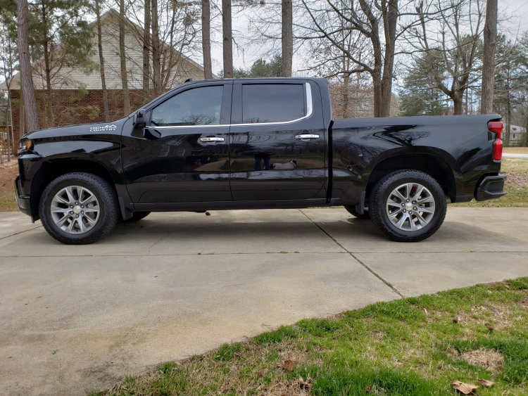

I installed my drop shackles today. I installed them in the bottom hole which will give it less drop. The result is the truck now has a 1/2" rake on the drivers side and 3/8" on the passenger side. My truck had about a 1.5" rake to start with. If I would have installed the shackles in the 2" top hole I think the back might have been lower than the front. The install was pretty easy. There is a 3" gap above the frame to the bed so there is plenty of room to get the top shackle bolt out. The only thing I had to remove for installation was the rear exhaust tail pipe hanger bolts. They are in the way when trying to remove the lower shackle bolt. The truck drives exactly the same except you can feel it sits a little lower.
Before install:
Edited by Billet Bowtie

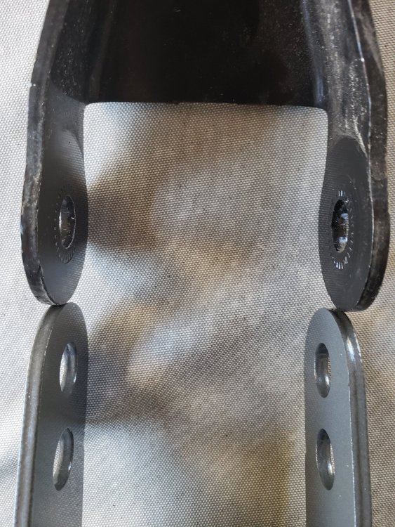

I also had to spread the new shackles slightly. They were just a tick narrower than the stock one.
