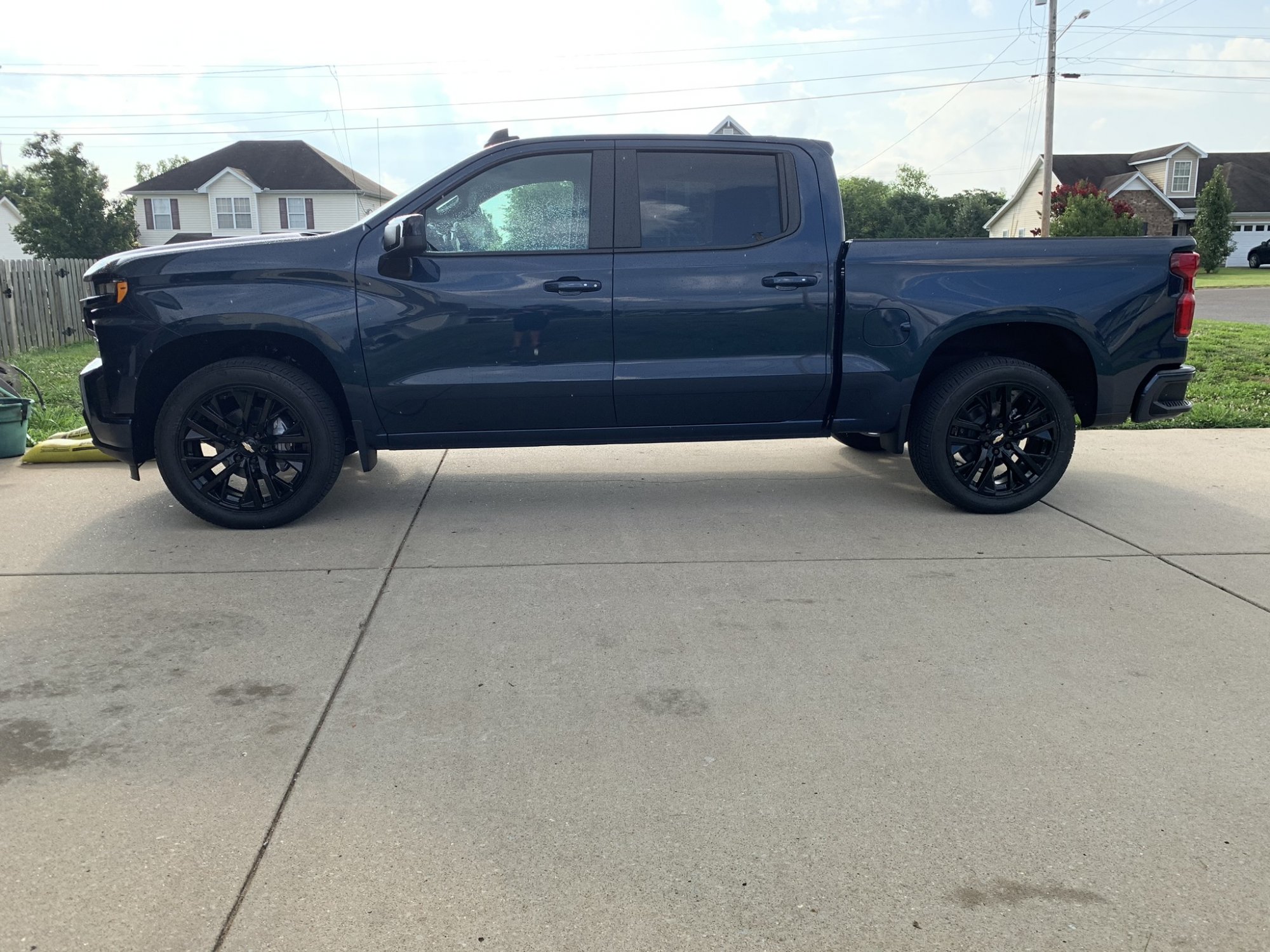

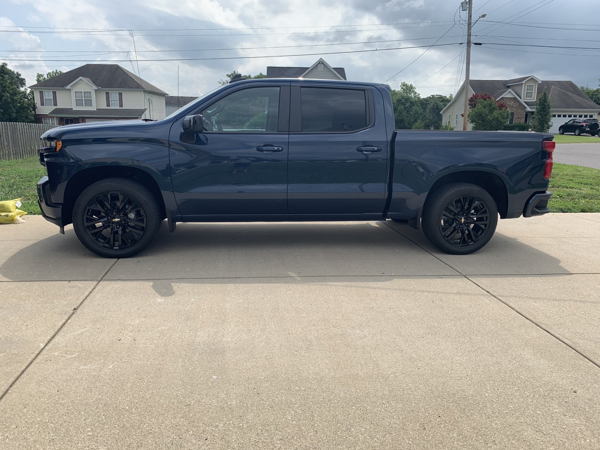

Got mine in today. Tried to install them on the higher set of holes and found that I still had about 3/4" of rake so I went ahead and went with the lower set. Also flipped around the shims just to be safe. no vibrations. Just need to adjust the headlights not and all should be good.
Before:
After:
