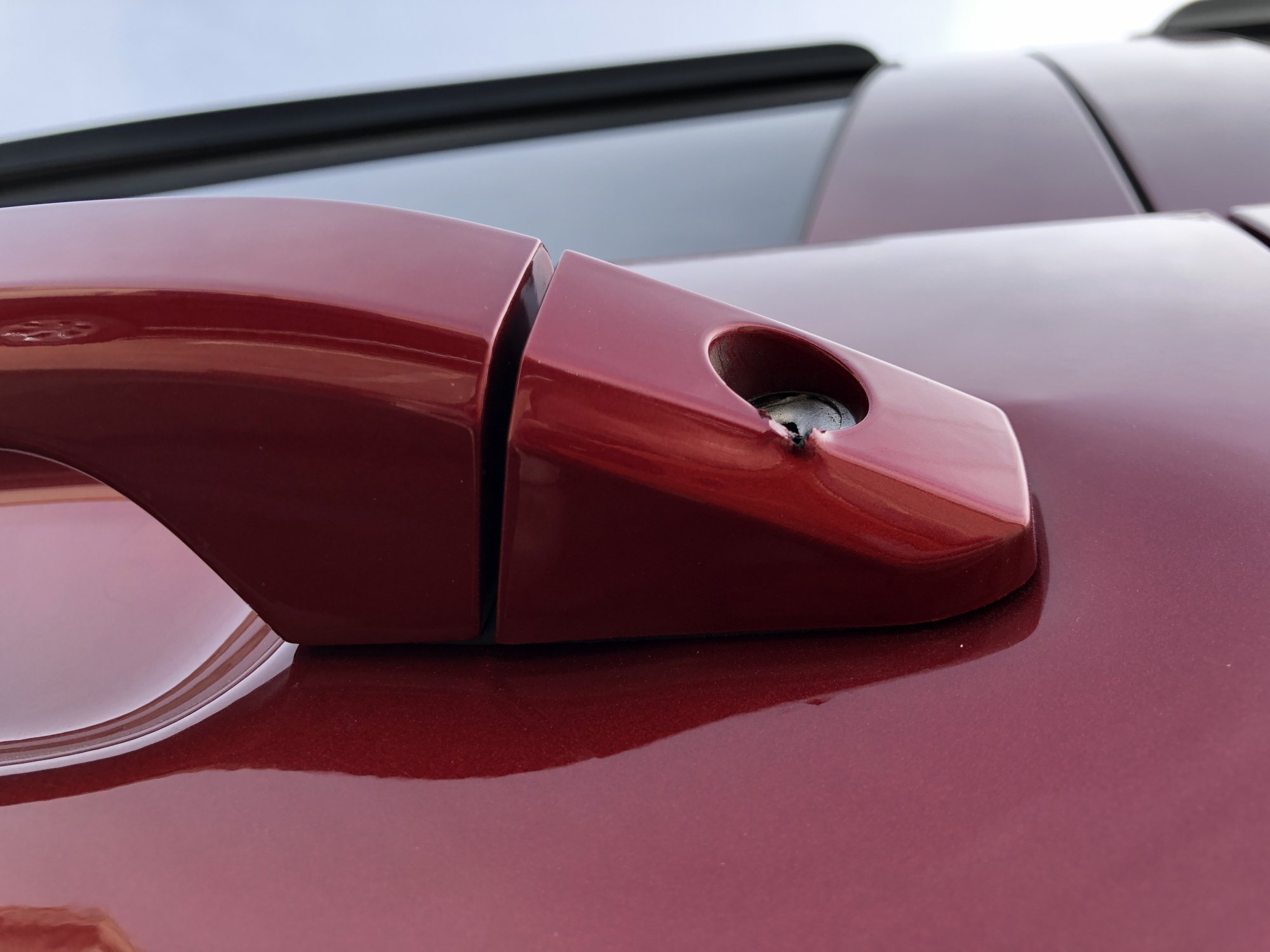

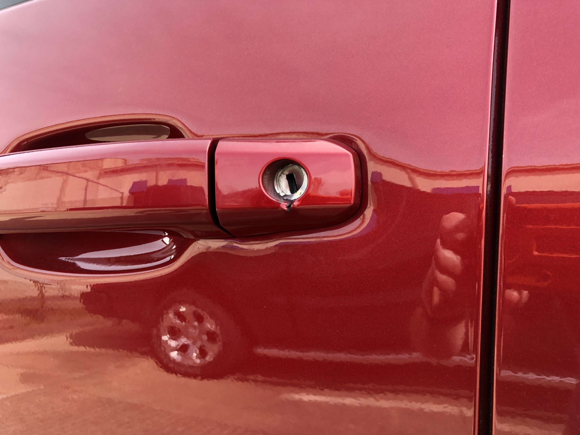

Door lock busted, metal bent in around handle.
So my truck was broken into and they busted the lock. They hit the screwdriver in hard enough it bent the metal on the door.
Can a body shop fix that or they replace the door?
I’m just trying to figure out which direction to go with the repair and set my expectations. If they just “knock” the bent parts back out, can they get it back to perfect?
Im not a paint and body guy, so not sure how they usually do it. There’s a crease in the paint and just trying to figure out how they’d do it.
Odds are im gonna drop it off at the dealers body shop and say I want it fixed, but curious how they’d do it.

FYI - you're not going to get a new door.  I feel your pain, but there's no way insurance is going to do that.  Plus, if they ordered a door, they'd still have to paint it.  It's not like they would order a factory red door and just bolt it on.  Any time your vehicle is damaged, you lose.  No matter how good the repair is, there just isn't anything like undamaged original.  Sorry.

They can make it look new again. If it doesnt, make then fix it again! I wouldnt be surprised if you could see something super minor, but nobody would notice unless they had prior knowledge of the damage.

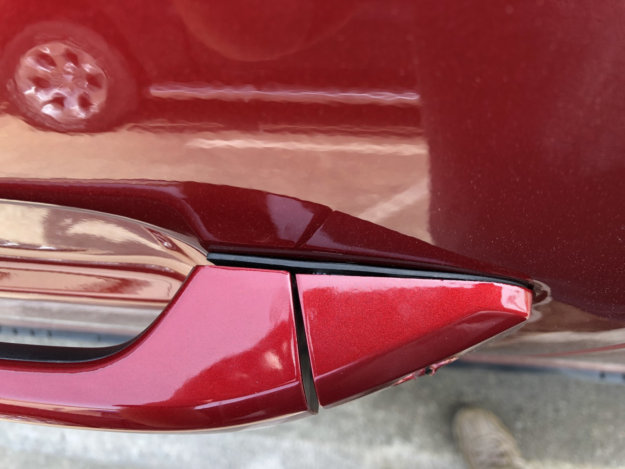

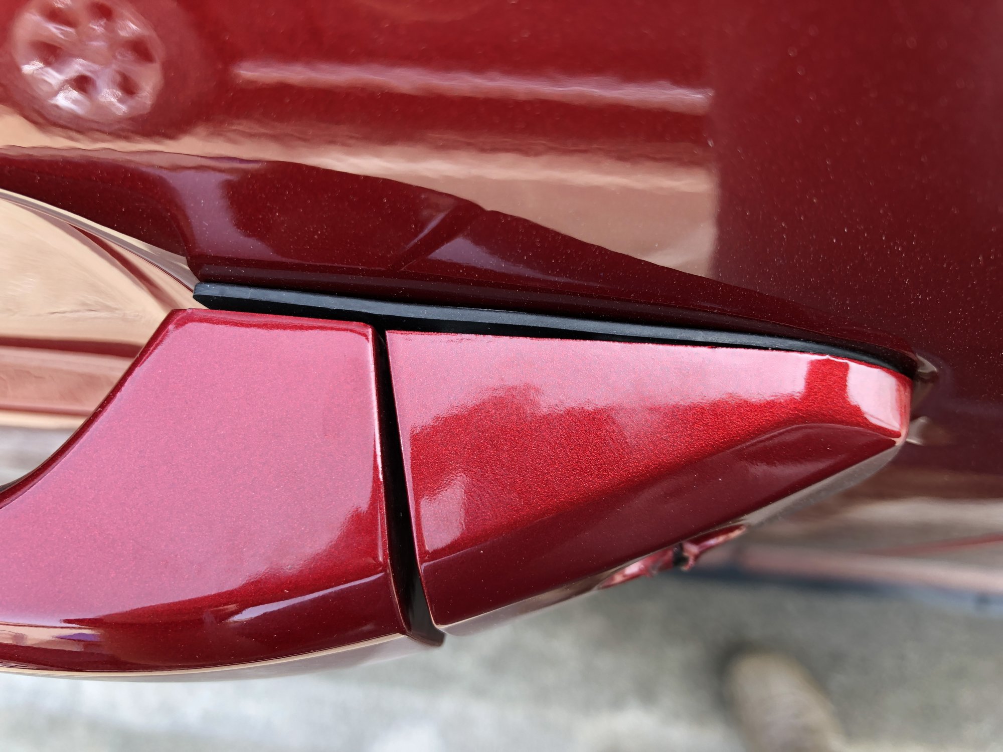

It literally only took 3 seconds for them to bust the lock and open the door. I'm amazed at how fast it was. I still hope they got ran over by a bus and died, but still impressed. haha
What it boils down to is insurance has sent me a check for $600. I've ordered a new key cylinder which i'll have to code myself (pretty easy to do) and I almost bought a set of take off handles for $200. So $250 for all the parts.
Then I realized the actual metal on the door is bent in, i didn't notice this before. i thought it was just the cover being jacked up (didnt look close enough on my end)
I took the guts out of the door and tried to lightly tap everything back into place and got it close, but not perfect enough for my liking.
if I take it to the dealer are they just going to tap everything back out a little better than i can and charge me $600 or are they going to actually going to fill it and sand and repaint it all so its really close to new again for that $600?

The handle is not the issue as much as the crease in the door panel, at least as far as body work goes.  Typically, even for a small spot on a panel, they would sand, fill, base coat the spot and then clear the whole panel to hide the fix.
As someone else pointed out, even with a new door, they would have to paint it and also blend into the fender and rear door to get it to match possibly.
Probably better off with new handle (painted to match), lock cyl replacement and fix the existing door skin.
Another option, if the paint is not cracked on door skin, is a paintless dent removal place like dent wizard.  It maybe worth a try.
