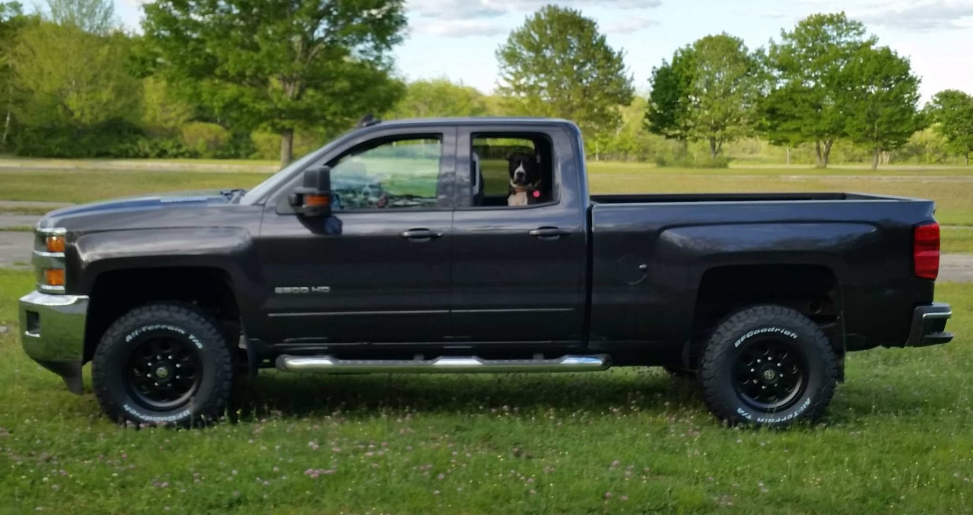

So, I recently traded in my 2016 double cab duramax for a 2019 crew cab gasser. Today I took off my winter tires and put on my summer wheel tire setup. These are the same wheels and tires I had on my 2016. They are rubbing. Was baffled why they would not rub on one truck but do on the other. Never touched torsion bars on either. Looked at photos of old truck and noticed that it sat an inch or so higher in front. Also the wheels seemed to be set back from front of wheel well about half an inch. Hoping that I can adjust torsion bars on new truck to get it to sit like the duramax did. Any thoughts? Thanks. Bob

Thanks everyone. Having tortion bars adjusted and getting alignment on Monday. I also realized drivers side about inch lower than passenger. Drivers side is side rubbing.

Nice looking truck, Bob!
What brand and specs are the wheels? What size BFGs?
Thanks. American racing Mohave II. 17x8 00 offset. Tires are 285/70r17.
