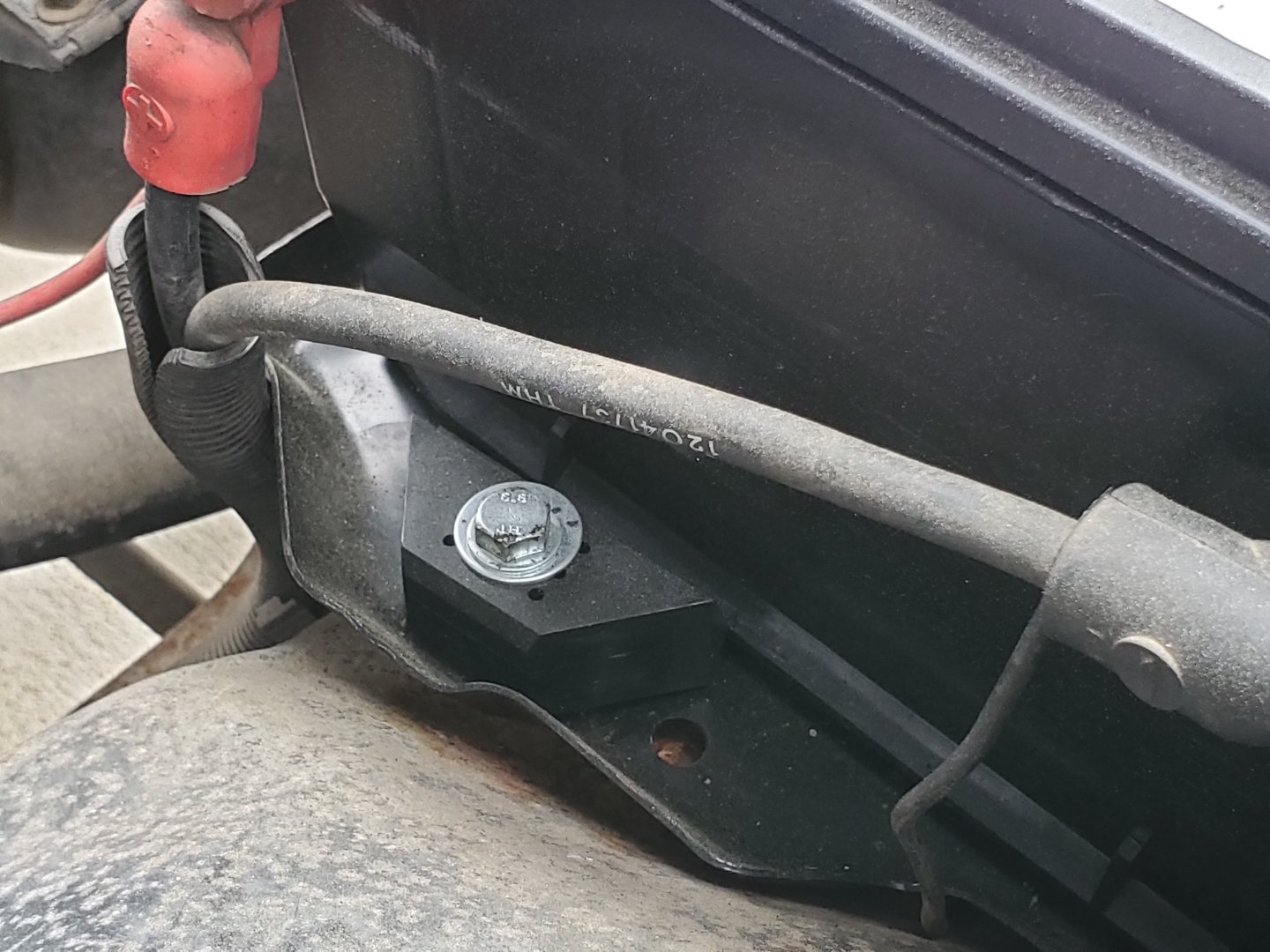

Anyone help with battery tie down used in 1989 S15? I can't figure out what factory method was used to secure battery in place.
thanks
It used a bolt and a block that gripped the battery on the side near the bottom.  lmctruck.com will have what you're looking for. Pg. 143, part #'s 11 & 12
I don't think the block and bolt will work, this is what the battery tray looks like. Just an inner fender bolt and a small hole.
There is supposed to be a nut welded over that hole. I forgot about this thread. I just swapped out a battery on '80 truck and it uses this hold down mechanism. I should have snapped a pic
I replace my battery tray on my 86 s10, with one from rock auto. There is a nut welded in on the bottom of the tray, you can get the block from autozone. I had to get a bolt from Lowe's, but it is the same setup on 2003+ silverado.
