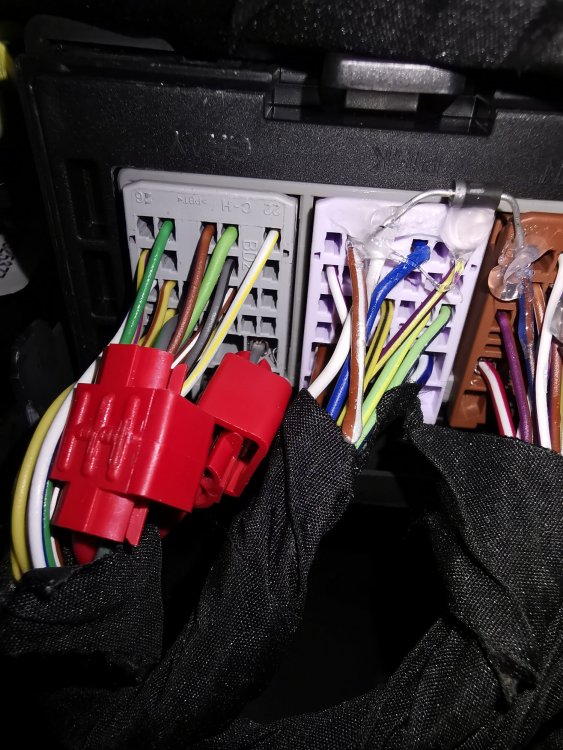

What, and how, did you tap to make the running board lights come on with door open/close?  Does opening the rear doors activate the lights as well?  I'm getting ready to install a set on my truck this weekend and could use a little help there.
I tied into the puddle light wire for the running boards as per Pgamboa here https://www.gm-trucks.com/forums/topic/202018-puddle-light-wire/. That way your running boards won't turn on while your driving and turn on your dome lights.

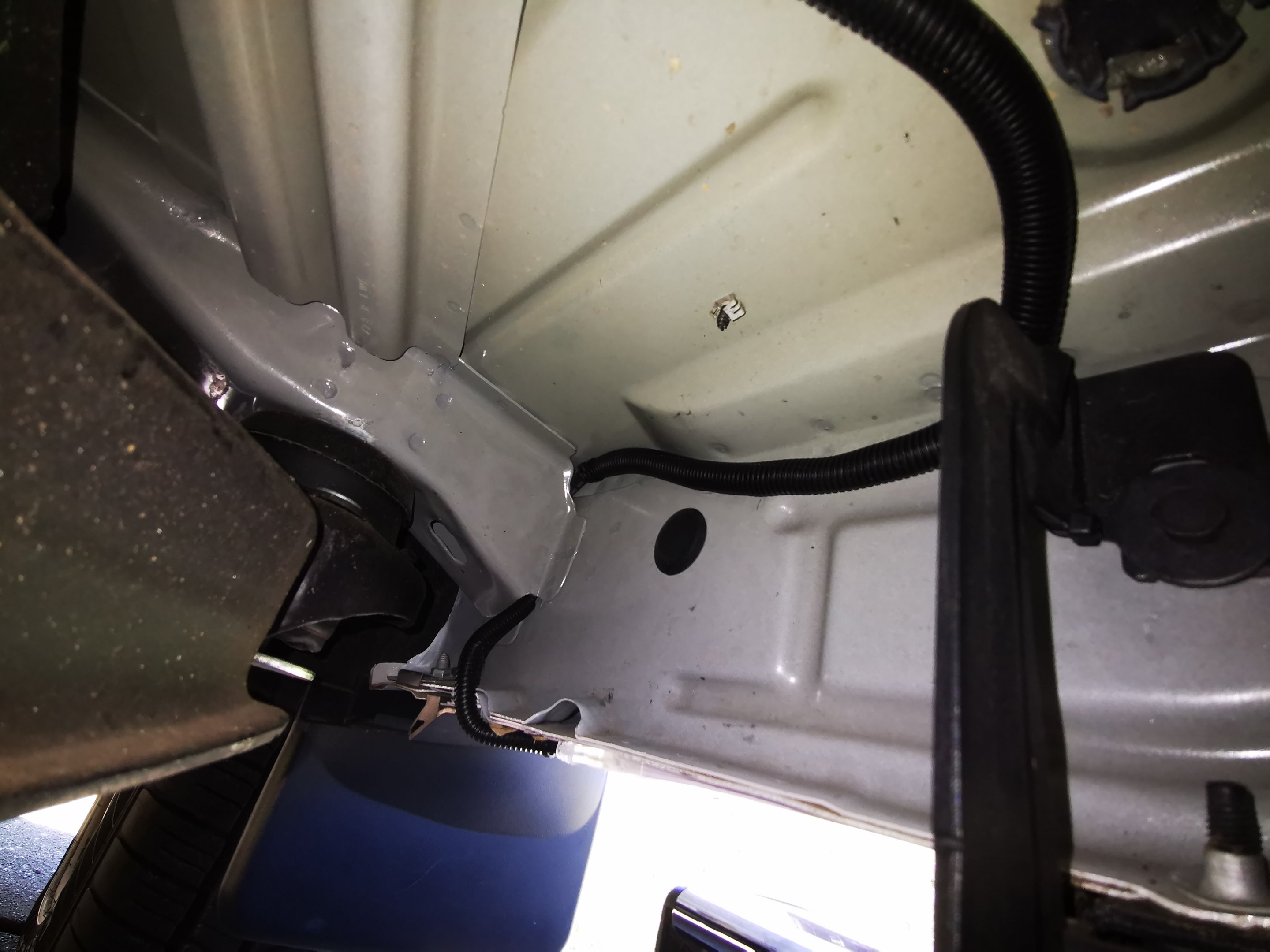

large.IMG_20190322_160725.jpg.0f23259588911a326b1d1e8424ea8a14.jpglarge.IMG_20190322_161151.jpg.16f9bd074073a4ca73ccc2fe038879cf.jpgI ran the wire behind the side panel under the carpet and out thru the brake cable boot. There is ground point to the right of the brake cable boot outside the truck. I ran the wires thru the cross member to the passenger side.
