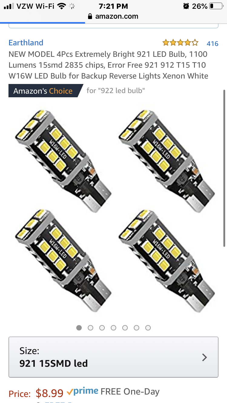

I got my reverse LED lights from Amazon for my 2019 LTZ and have had no issues.  I have the same lights in my 2016 LTZ and have had no issues with those either.  Both sets are 1000 lumens and they make it much easier to see at night when backing up.  I think the parasitic drain issue is way overblown.
On 10/26/2019 at 6:39 AM, Thomcat said:
Here's the best reason for not substituting LEDs for reverse lamps.......seems the on next gen. models the BCM monitoring of the bulb outage circuits may continue to draw current with key off if original halogen is replaced by an LED. Length of time necessary to kill battery may be dependent upon brand of LED substituted.
https://gm-techlink.com/?p=9594
If you get CANBUS compatible LED bulbs you should not have a problem.
do you remember what brand or do you have a link
