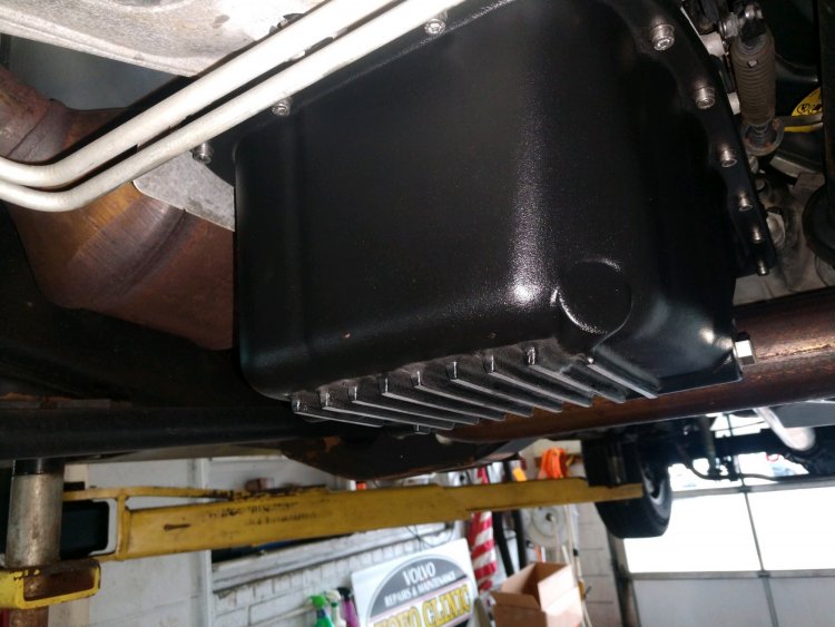

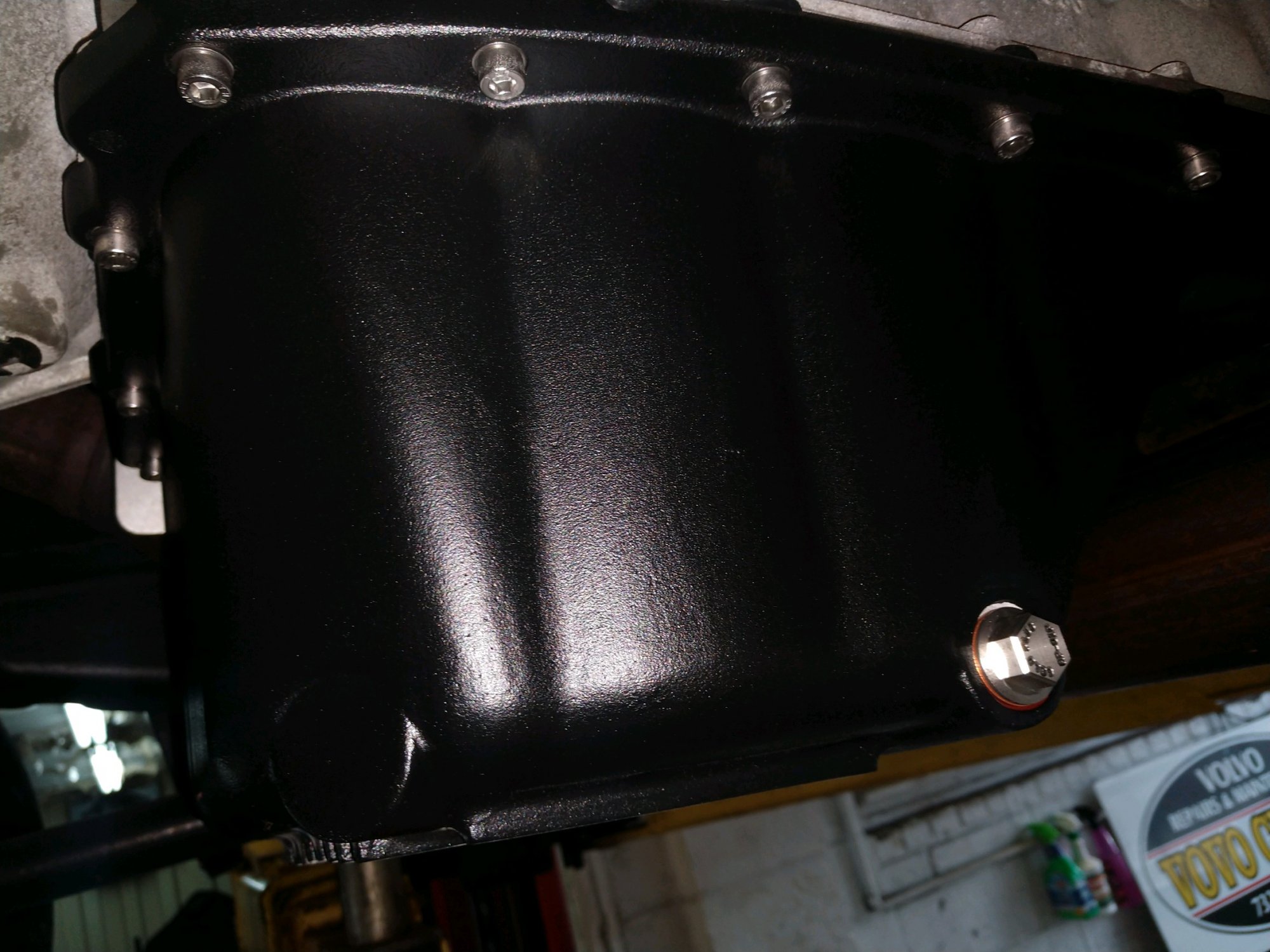

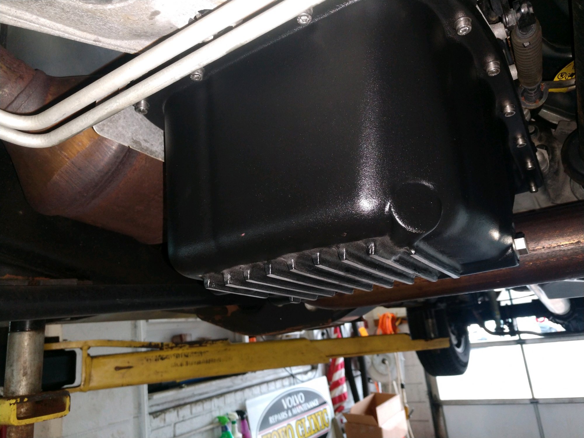

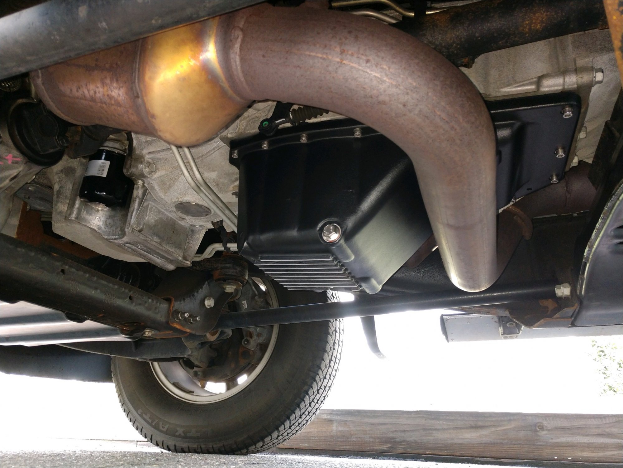

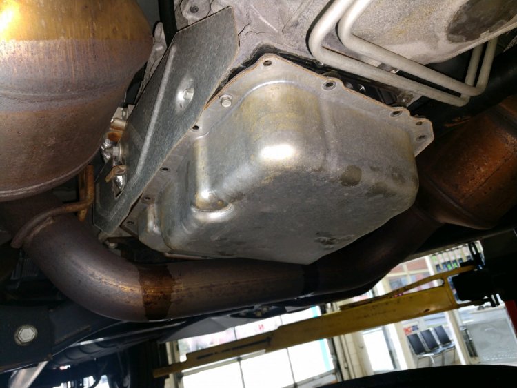

just a suggestion,  i have a 2015 Hd gasser and i just installed the PML covers,deeper trans pan.   easy install and it holds about 2-2.5 more quarts.  i daily drive and tow a good sized enclosed trailer and i plan to keep the truck for a long time and im a little anal with fluid changes.  i got the powder coated pan that comes with nice stainless hardware.  i used a new AC Delco gasket ,filter,and fluid. pics posted here.    Ray
do you have a link to that pan? when you refilled it how many quarts did you put in?
On 4/8/2019 at 10:40 AM, dynoray said:
https://www.yourcovers.com/transpan_11036.php
here's the link.   stock fill is 6 quarts and with the deeper pan its around 2-3 quarts more.  i initially put in 8 and it looked good when the truck heated up.  this was this past friday,i just drove to work today and im going to recheck the level hot and see.
