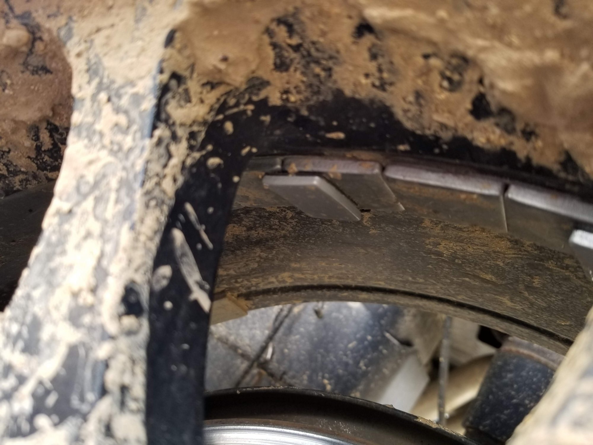

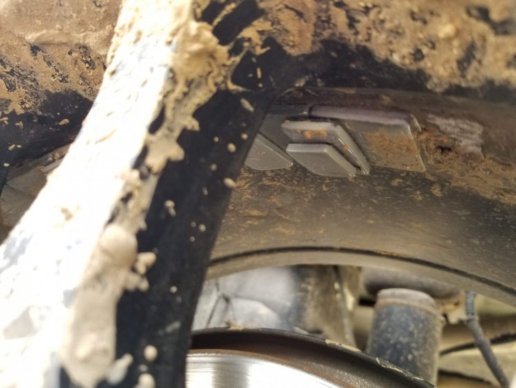

Well I got it on the highway headed home and past 60 the thing shook like crazy. I'm used to a bit of vibration, these are 35" RT tires after all. This however was insane. I thought a steering or suspension component went out, till I got home and checked the weights.
20190407_154830.thumb.jpg.2db6b00c981101ffd88171114da4b6b8.jpg20190407_154814.thumb.jpg.42bc3fea21c2b02f575ce9a9eff0dc75.jpg

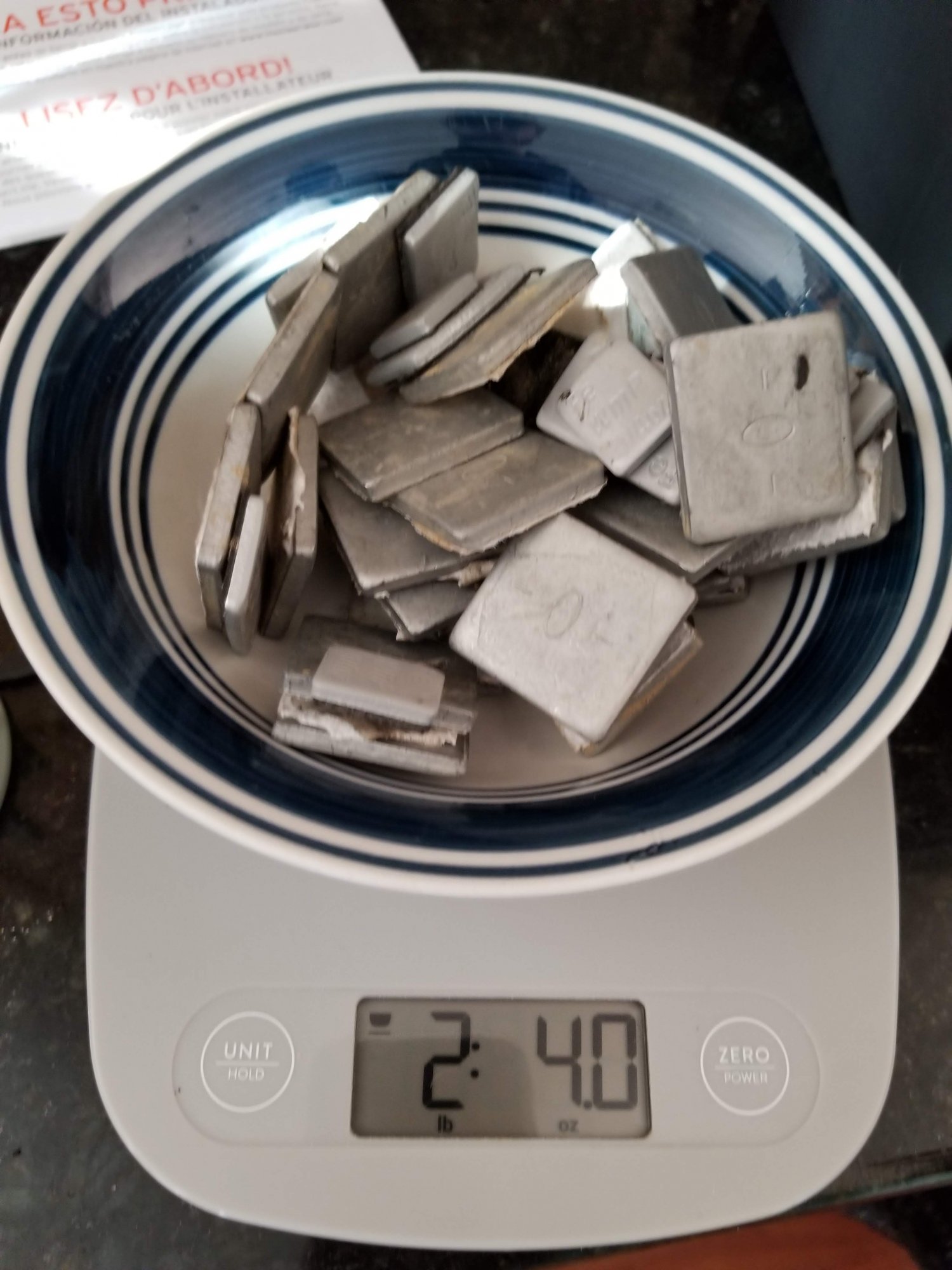

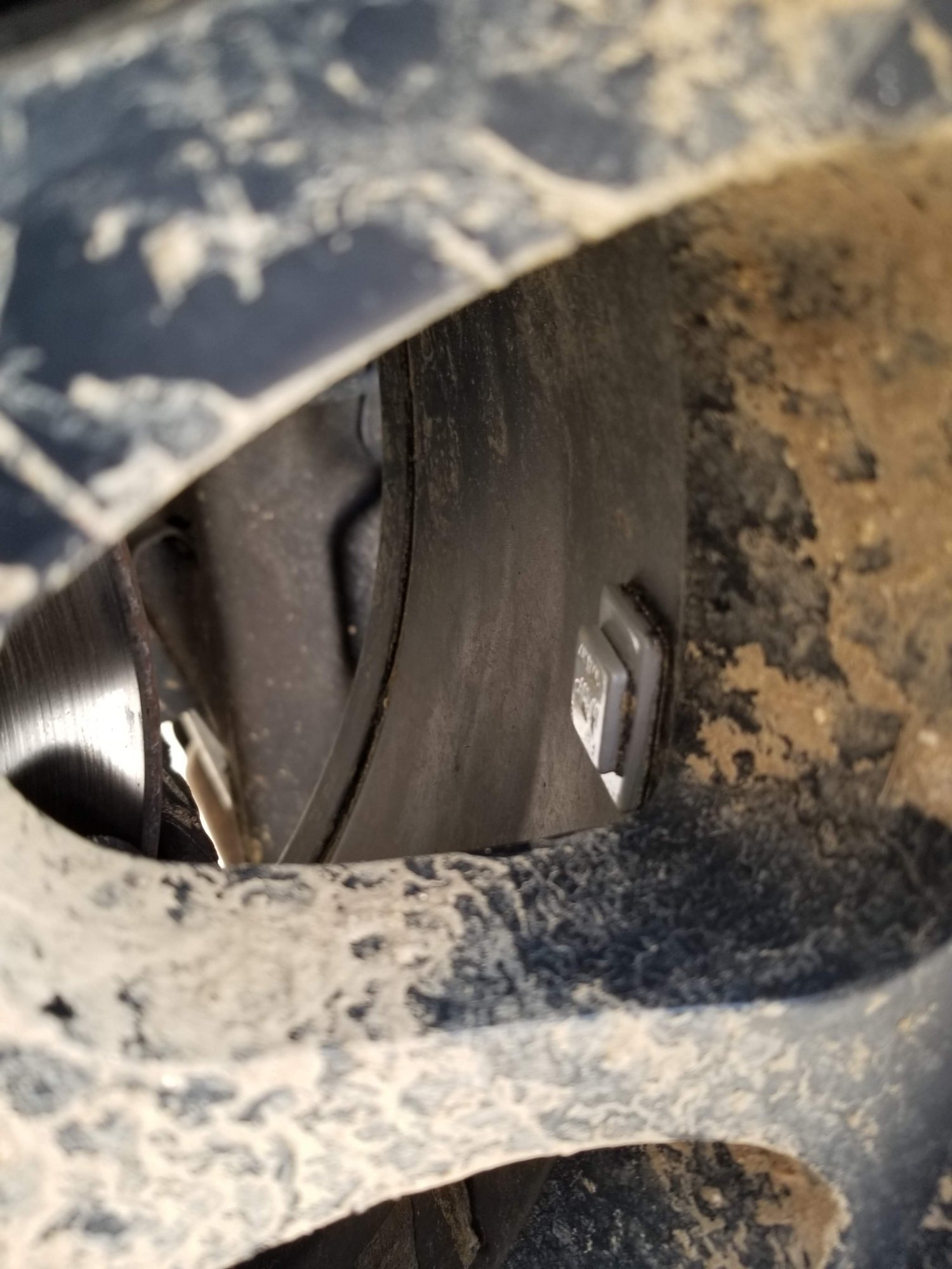

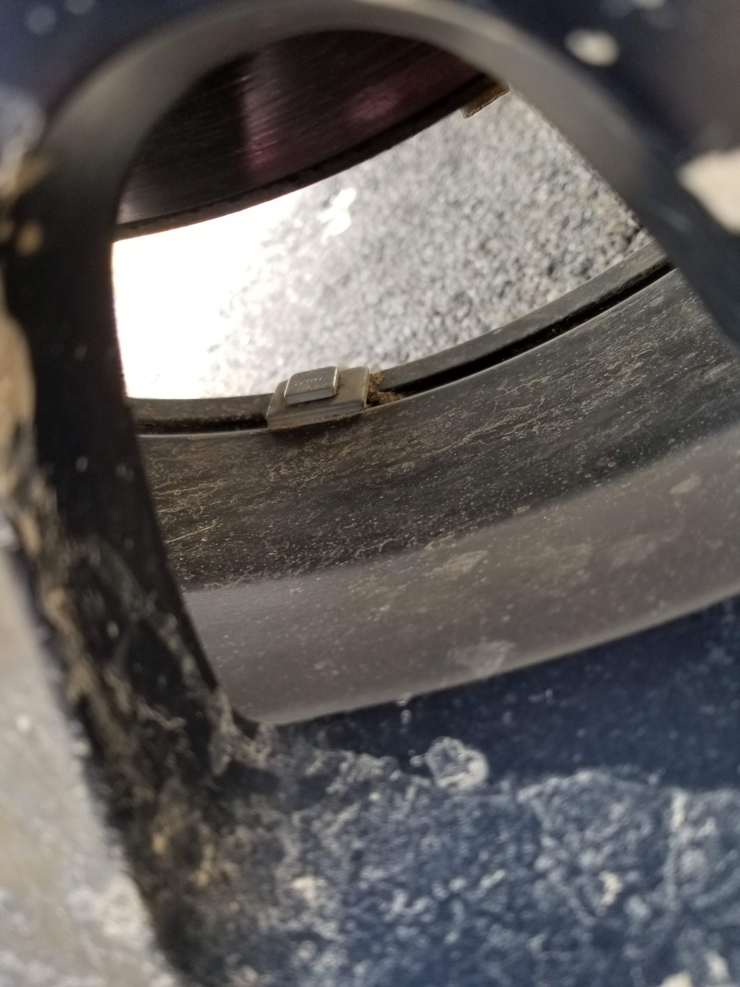

Ignoring the mud as I had been off road to the range after noticing the shake. I've never once seen weights double stacked. I've never seen weights triple stacked. Outside the fact that there are a million of the little things on there is this normal? I pulled them off until a local shop can get me in to do the "sand bag" balancing. Total was 2.25 lbs across the 4, that seems a bit excessive.
I’ve also never seen them stacked and don’t think it’s a good practice.

Im going to assume that you have aftermarket wheels. Just keep in mind that most aftermarket wheels are not created with the same spec tolerances than OEM wheels are. I had to double stack to balance my aftermarkets properly. I really didn't want to but otherwise it was going to require way more weights than necessary to balance. As long as the surfaces are completely clean and the weights stick, I wouldn't worry about two stacks, I would never do 3.
My assumption in your case is one or more of the weights were not applied to clean surfaces (either the wheel or the 1st stack) and detached.
If you ever have the opportunity, throw your wheels on a balance machine without tires and see what the machine says is needed just to balance the wheels.
