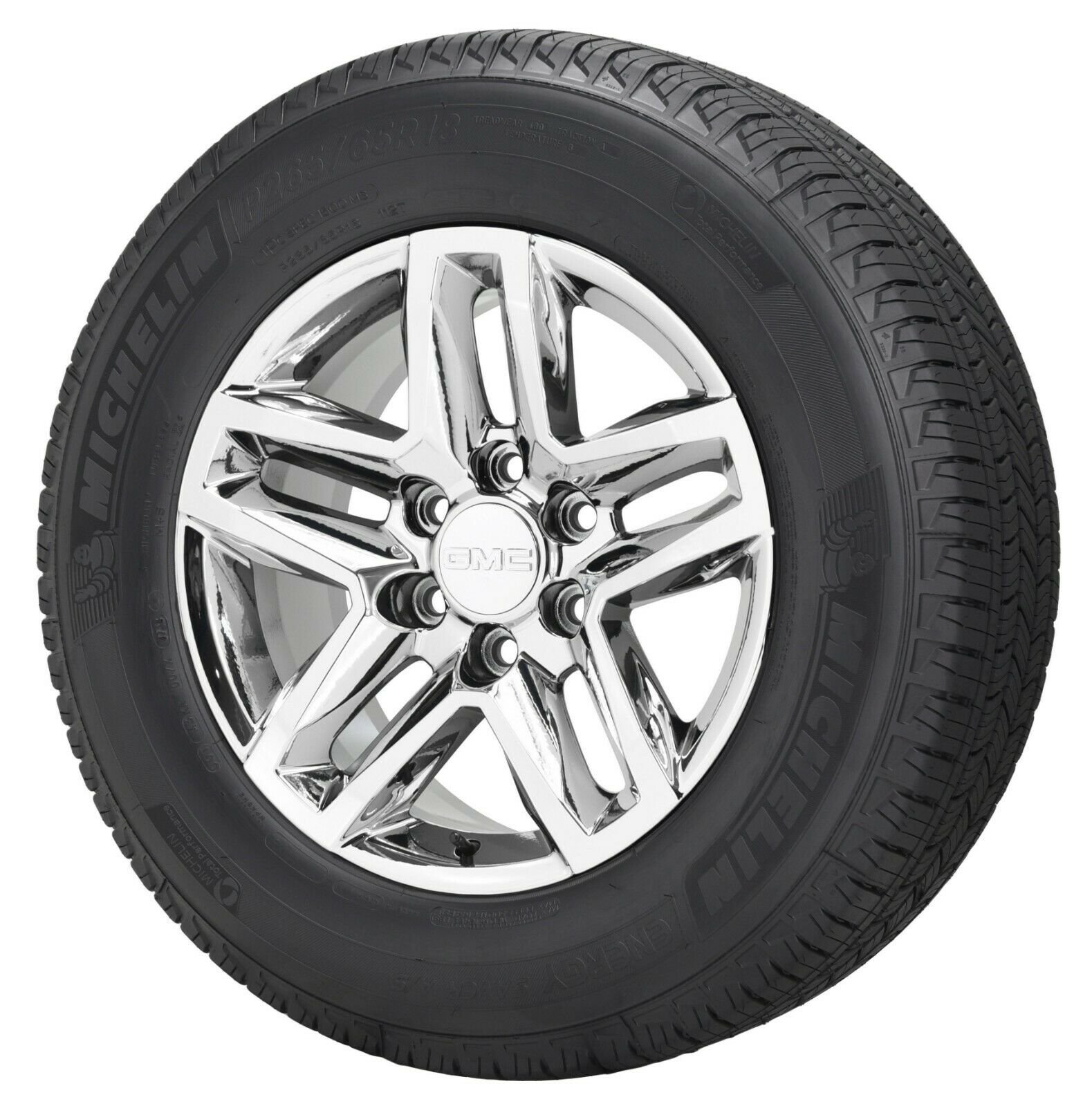

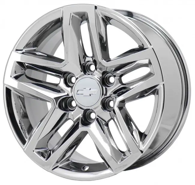

What wheels are these from ?
I found these wheels and I'm drawing a blank on what type truck that would have been on when they were new ?
I figure they were painted silver or polished, they are 18's.
I'm thinking it was a GMC, but I'm not positive.
16 minutes ago, michigan2500hd said:
Aren't they early All-Terrain wheels?
That was the truck I was thinking too, but these appear slightly different....the holes in the spokes are triangular these are more slotted.
gmc_sierra_1500_2008_2008_gmc_sierra_1500_crew_cab_sle2_4x4_all_terrain_2290003507137347855.jpg.34b7a59217ad77f1e806ba5996668df7.jpg
2 minutes ago, Likarok said:
I don't know but I like them!
Me too, I'm seriously considering getting some.
Hard to find wheels that look like that now.
You got it, thanks!
I knew they looked familiar I just couldn't place it, they look so different not in black.
Anyone know if the '19 wheels fit the older trucks ?
2 minutes ago, Cowboyman said:
You got it, thanks!
Same bolt patterns.  Offsets are within 0-3mm for most wheels T1 vs. K2 stock wheels.  Some even the same.  Widths are the same as well.  The issue that I seem to see on the T1 section of the forum here is front caliper clearance when using K2 wheels on the new trucks.  The new trucks have a 4 piston fixed caliper up front, and the T1 wheels are accommodating of them as such.  The new trucks need a small spacer when using the old wheels to clear the calipers.  Should be fine the other way around though (new 2019 wheels on 2014-2019 old) as the old truck uses a traditional two piston floating caliper.  Much more clearance to the wheel.
