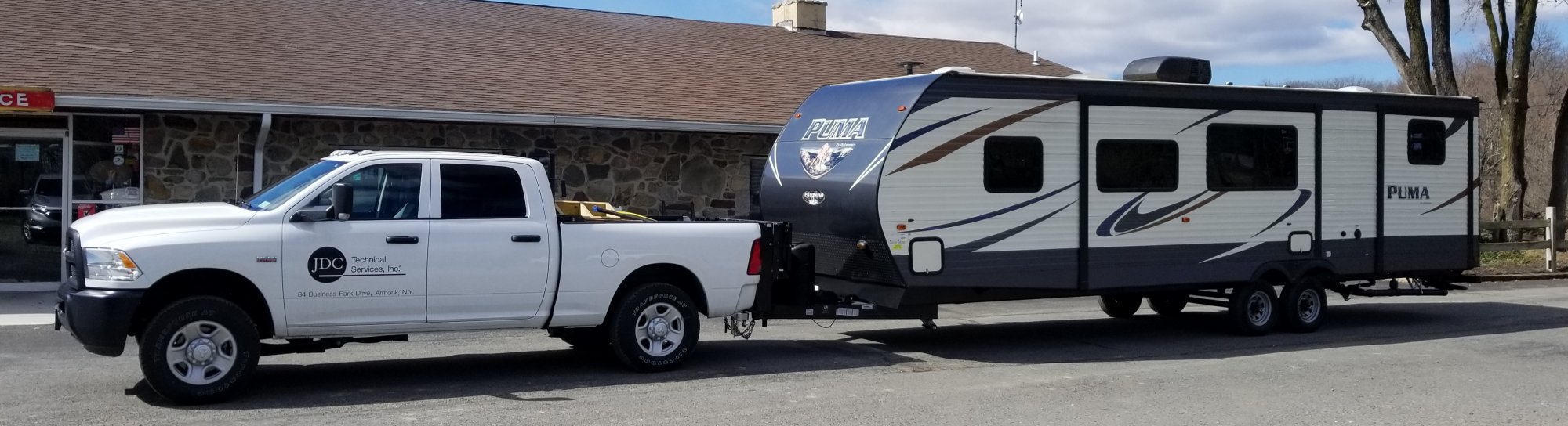

So I'll throw some oranges out there...
My daily driver is a 18' Dodge 2500 gas powered 6.4L with 6spd 66RFE, here is a comparison after towing a 9600lb trailer last week about 30miles thru some decent grades 10% in spots. Now ambient was 39deg but water and oil both in the 200's, Trans in the 170s. Its a stock work truck has the plow package better coolers and the sort made for work for sure. I keep an eye on my temps, that is my default display.  Heat kills transmission's plain amd simple, I am a trained SCIE going on about 19yrs started just after Y2K.
I'm sure just like Ram, the new displays show a made up number from some algorithms from various inputs, so alot of these reading we are looking at are not real..... but lets say they are real for now. 195 and into the 200s IMO is pretty hot for a "stock" trans, I would be figuring out a better cooler set up for my ride. Or make sure the temp is from a reliable location in the system.

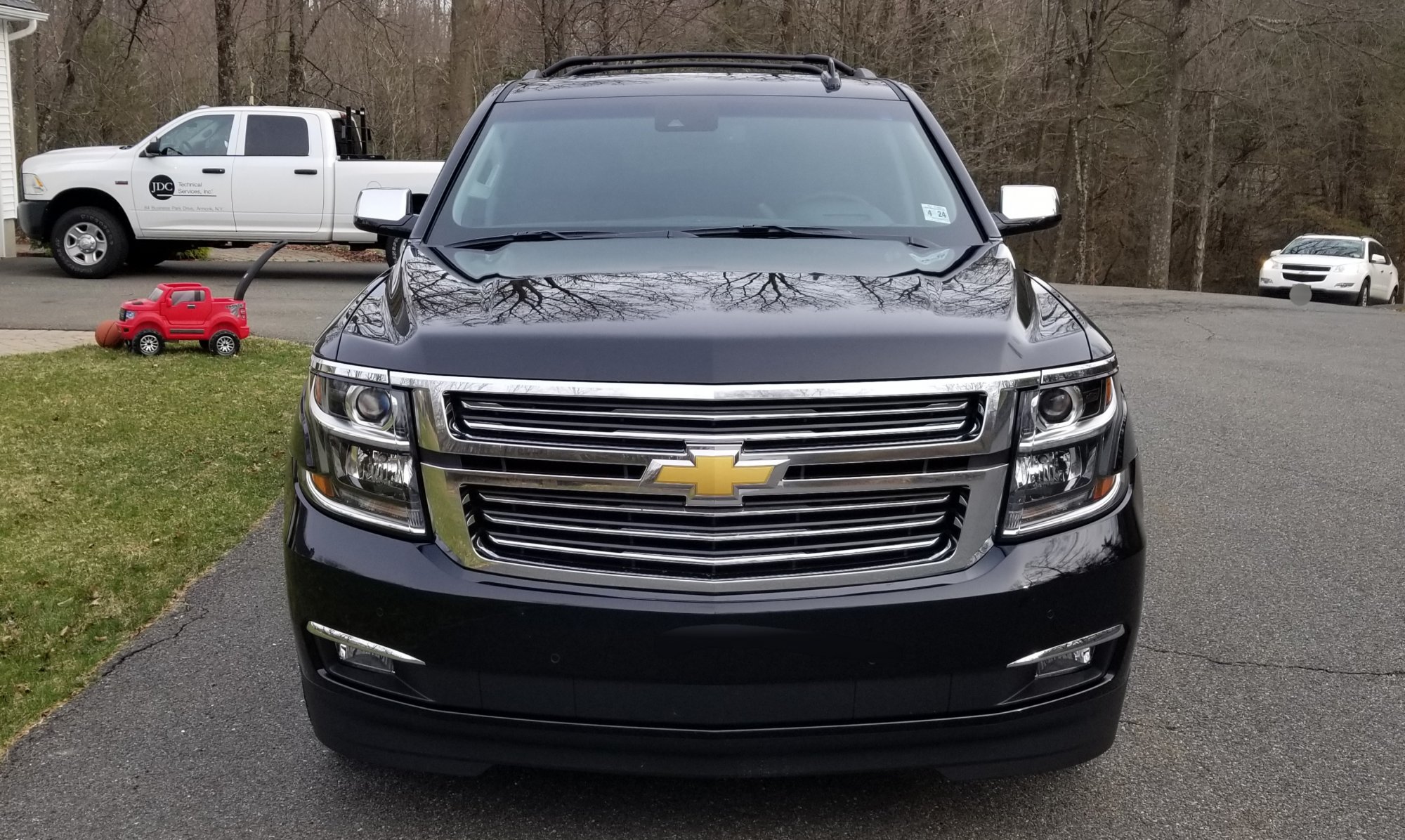

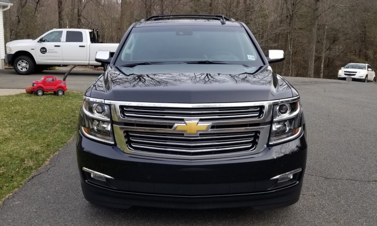

Have most of the fleet above.
11' Traverse heading up the driveway that has 140k on it .
Had
07' Tahoe Z71 139k
10' Tahoe LTZ 170k
So have a little Chevy seat time.
My daughter has her red Ford Raptor, there, so I'm a equal oppurtunity offender.
Cars are all about rebates, and financing anymore, who has the best deal month to month, Chevy did not have the #'s when I needed a 2500. Plus my local dealer has like no stock of work trucks ever, maybe 6 Corvette's, a few sub compacts, plain jane midsize, a few super high end pickups, and the rest is other brand preowned, its sad really.
Drove about 55min for my 19' Suburban to get the best deal, passed 2 other Chevy dealers.
