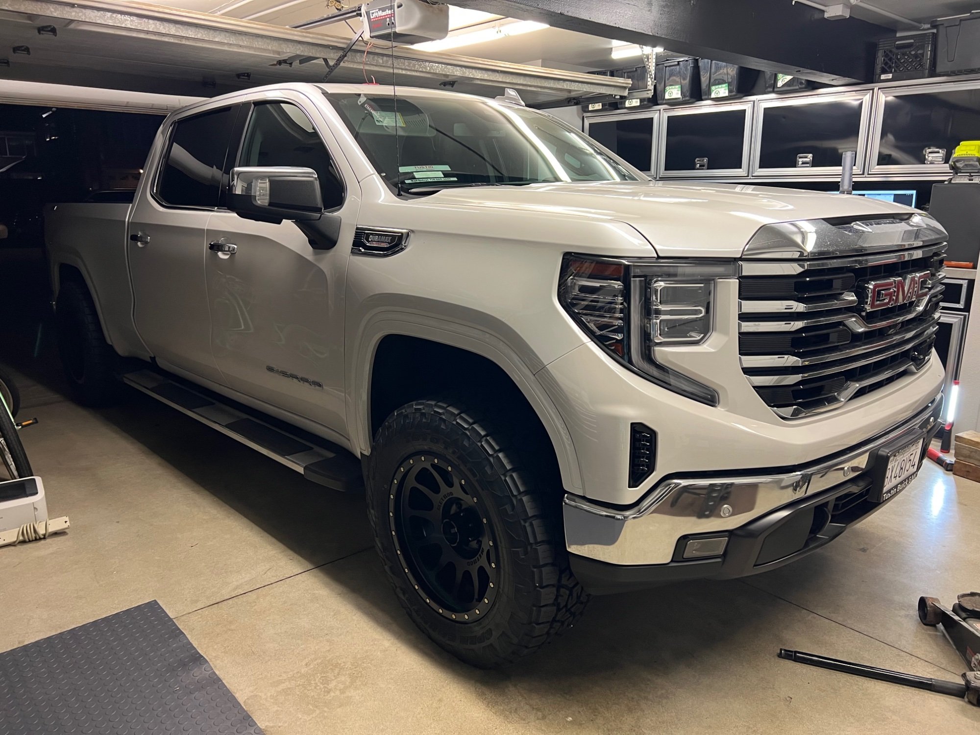

On 1/21/2023 at 3:01 AM, xxbucfan88xx said:
Have 2022 with the 2023 body/interior. Put adjustable kings at 3” and I fit 35s no rubbing.
20s or 18s? Stock or lifted?
