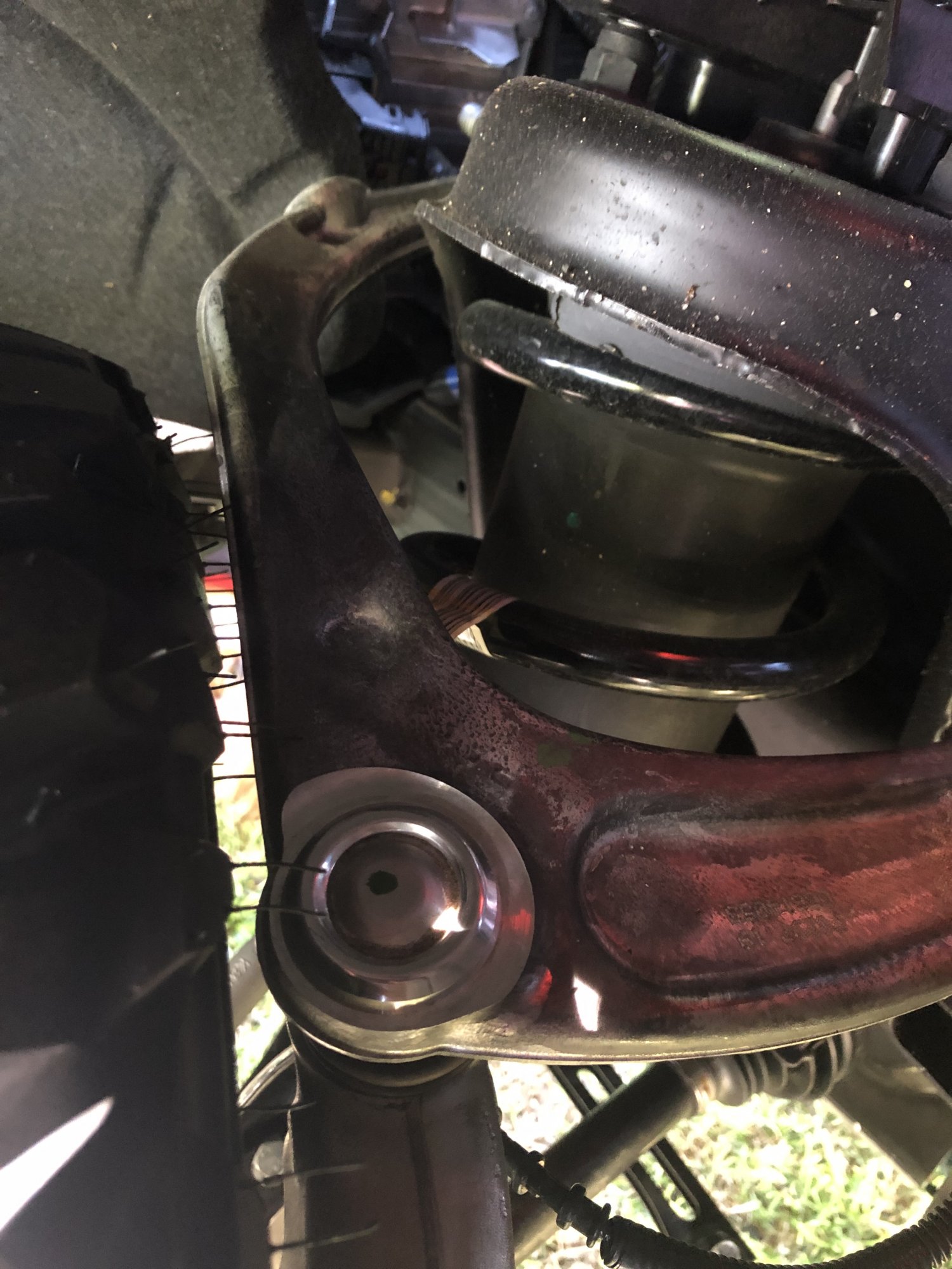

Picked up my Sierra last week, so decided to see what we could fit on it today. Installed the rough country 2” level  and a set of fuel gripper m/t’s In a 35x12.50. After some trimming of mud flaps, removing bracket behind fender liner, and tying the fender liner back. Rubbing is gone. So if you’re not scared to trim some plastic it can be done. I think it looks good, let me know what you think. I knew worked on at4, couldn’t find anyone to confirm if would fit a standard level.

I noticed after I put a set of  TG2's 285-50-22 (= 33.27-11.69) on my stock wheels with 2' level I had enough room with minor trimming (if at all) to go with the 285-55-22 (= 34.37-11.69).  I was afraid of the gearing and performance loss though.
Looks good. Do you have any rubbing on the UCA’s with the 12.5’s?  This is where I’ve read most people complaining. I have a 20 AT4 and plan on the same level. Sucker for a big tire so I’ve been toying back and forth with 35/12.5/20 and 35/11.5/20.
Not to be a pain but can you post some more pics?
Side view to see gap? Front view? Know what I mean? As said before in this thread this is the same direction I plan on going but with the 33x12.5 on exact factory rims. Nice set up by the way!
None at all! This is cranked as far as will go
