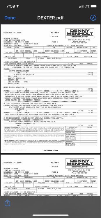

1 hour ago, Dexter Jensen said:
2019 Sierra AT4. My body line is 1/2” off. And 1/2 sunk in width wise. So far I have gotten no where with the dealership. They first told me this was not a warranty issue and I was going to have to live with it. If anyone gets any traction. Please let me know. I am extremely disappointed. Thanks

Yes actually. It goes in today for new body/box pin  alignment. Gm has said most likely the alignment pins were incorrect placed when mounted and crushed cause the lift in the box. I will post on here as soon as I get it back tomorrow. I have been in contact with GM via Facebook. They have been super fast and responsive

Got mine bed adjusted, went to a larger dealership, they have done a few, it’s almost perfect now, not sure how they fixed it, at least it’s straight , like it should be

I just got a 2020 Chevy 1500 Trail Boss from Autonation North in Denver and it has the same issue regarding the misaligned box. I noticed it a week after I purchased the vehicle. I took it into the dealer and they said the only way to correct the issue was to drill holes into the bed. They told me that there was no possible adjustment with the pins. So did the dealer remove the pins on your truck and put new ones to realign the bed? Who can I contact for this issue?

I stopped and talked to Dealer a couple days ago. He told me the pins probably got crushed and they could loosen 6 bolts that attack the bed to the frame, TRY to shimmy/shift it over some but there isn’t a lot of room for movement. He took pictures and said he was going to contact GM to get it approved.
I spoke with a local body shop today, that I have been friends of for quit some time, and was told the beds are removable since they have to do so when working on cabs of trucks when involved in accidents.  Told me the dealer should have never moved the cab if they truly did, as that would drive off the alignment of everything else on the front in or cause the vehicle to look like its tracking or floating from behind.  They also then asked if the frame was bent if the bumper itself is off as well, since the bumper typically attaches to the frame.  As many stated though, they stated the bed should have been removed, re-pinned and aligned to match the cab and the bumper, not vice versus.
