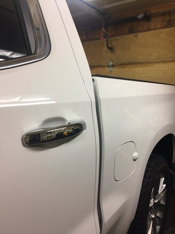

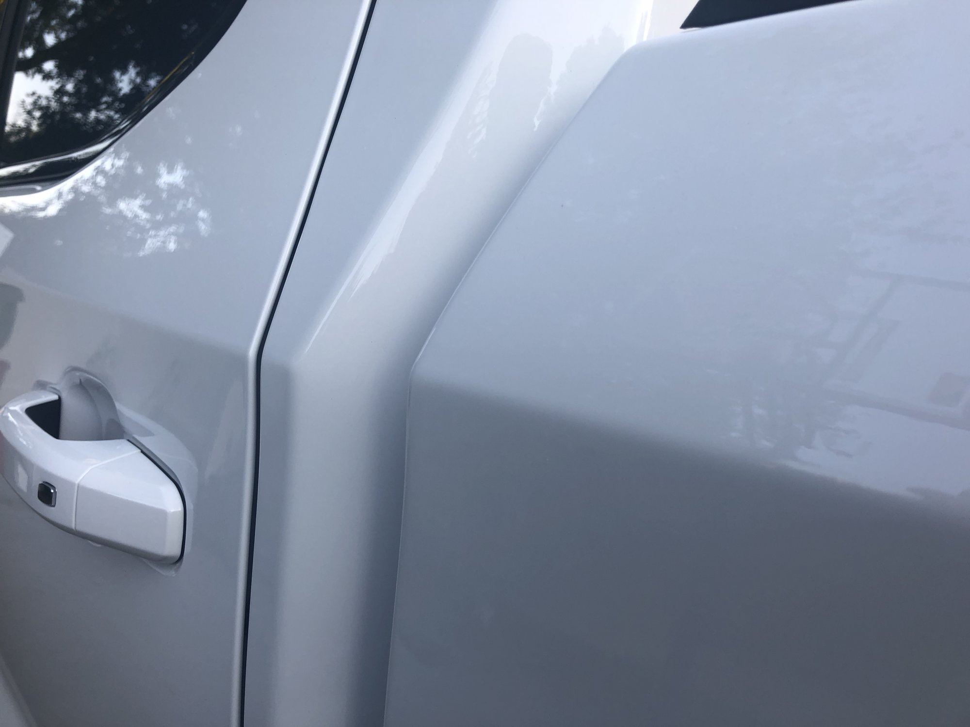

Anyone else notice that their cab/ bed are out of alignment? I've had my AT4 for about a week now, and when I first noticed this in my mirror I thought I was losing it..
On the driver's side of my truck the cab sticks out at least a good 1/4" past the bed side, and the body line doesn't line up. The passenger side is flush and laser straight.

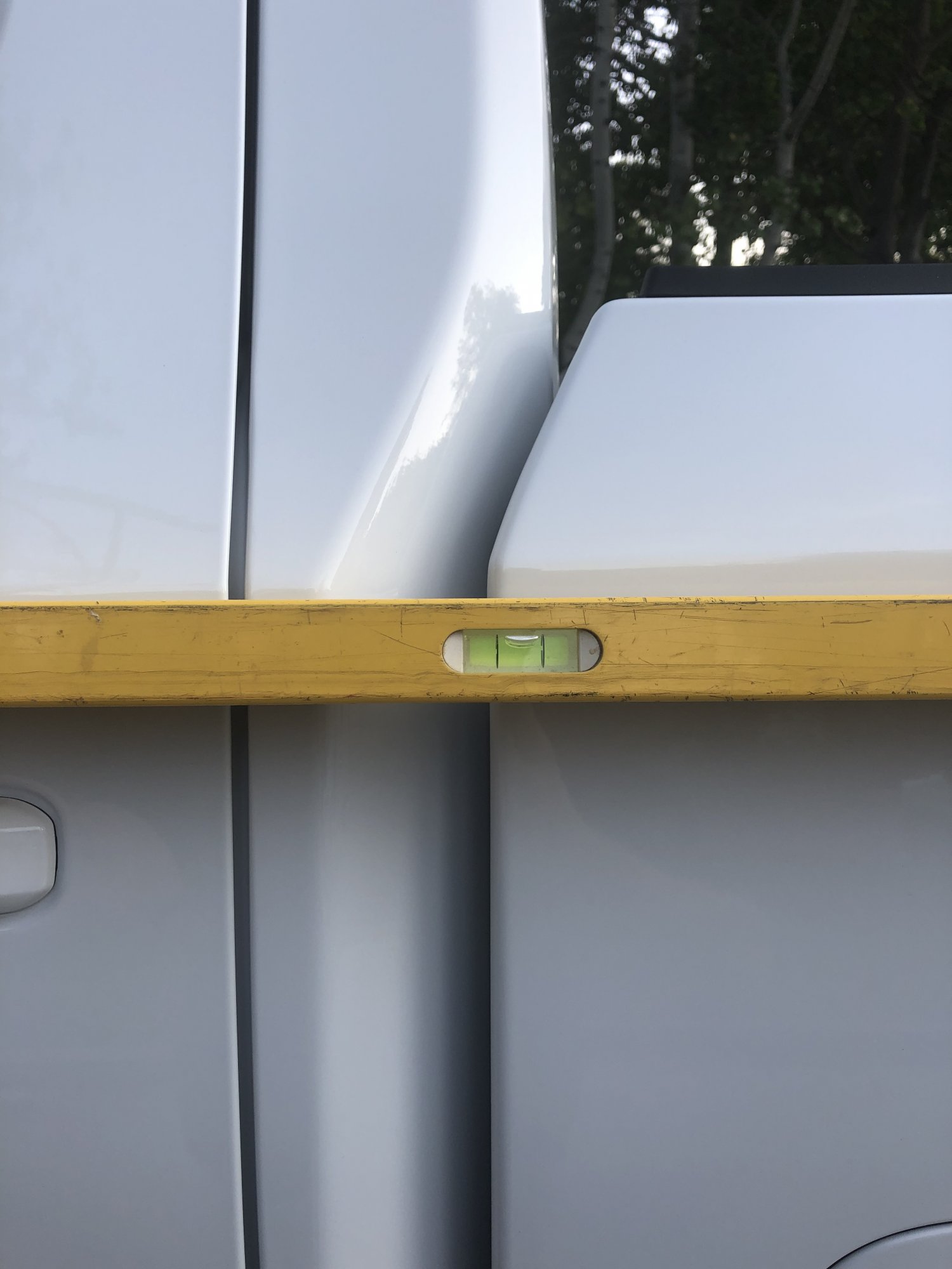

I tried taking a couple photos, but it's quite difficult to capture with reflections. Am I the only one? Is this worth making a big deal about? 8388124f16a738bde132f507db61a96f.jpg525e664f18fe77c9bf7387c9ae98bd3e.jpgf5ce965db587455c5997ca318b630cb2.jpg

Take it to the dealer. They can loosen the bolts and adjust the alignment. Pretty simple fix and very common issue across every single brand of trucks.
Most of the time they are all a bit off, but that's real bad. There was another post on here about it but people were claiming no bed adjustments on the new trucks.
A lot of F-150 owners had the same problem, it's an easy fix. Seems to happen with all pick-up trucks.

Had mine in the shop on Friday, mechanic moved bed over to the drivers side, but its still about a 1/4" off. Mechanic said all the adjustment was gone unless bed is removed and drill out holes.
Mine is off 1/4” in the drivers side and flush on the other. I checked the tire pressure and parked it in my level garage. Took a 4’ level to use as a straight edge and checked both sides. The cab on the drivers side sits 1/4” outside the bed. The passenger side is flush.

I believe I will leave it alone. With a square bed and square cab there has to be a reaction to every adjusted made. I am not sure that I want a bunch of shop hands leaning and pushing on my truck to gain an 1/8” in alignment. After looking at about 10 trucks today I came to the conclusion that the bed must be slightly narrower than the cab - maybe 1/4” to 3/8”.
