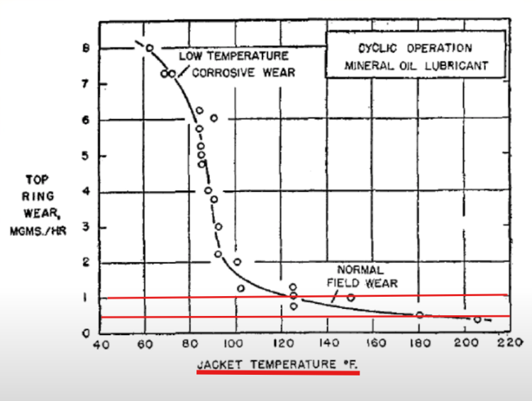

Another Wear Study
There is little difference in wear absolute between 170/180 F and 212 F. There is zero difference in heat up times between the two thermostats to 170/180 F. Colder thermostats do not significantly increase wear. They do lower oil oxidation rates.
What is the viscosity of an SAE 0W20 at 40 C/104F? And an SAE 5W40? Contemplate the difference in wear between that caused by running at 100F vs the few centistokes difference in viscosity at 212 F or a single centipoise at 150 F (ring area) and tell me with a straight face running a 5W40 increases bore or bearing wear based on it's viscosity.
Corrosive wear at 60 F isn't a function of viscosity.  https://rotella.shell.com/en_us/info-hub/4-ways-engine-wear-tear-occurs.html
