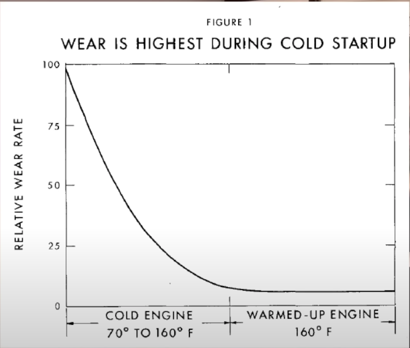

Beat a new Drum
I rarely start Pepper for a drive under 100 miles. Rarely, not never... Why?
How much time and how many threads I've I spent talking about the reduction of wear? Yea...a lot. News flash. Those discussions fall into the 25% of the engines total wear you have the most control over. After it's heated up.
75% of engine wear happens between ambient, cold start, and 160 F+. Not just water temperature but bulk oil temperature as well. Oil takes a much longer time to bring to fully warmed up than does the water. 😱
SAE Tech Paper 2006-01-3413 (One of the GM studies)
SAE Tech Paper #600190 Standard Oil wear during cold start
Ring/bore life is the limiting factor in overall engine life, not bearing life. Ring and bore life hinge on the oil, oil condition and in its operating environment, the number of miles PER COLD START, and load. Yes there are more factors but these are the heavy hitters.
OTR engines get a cold start or two a day and then are run for 400-600 miles. Soccer mom's van almost never attains 160 F oil temperature between starts. One goes a million miles the other ??????? Go figure :dunno:

That’s interesting. My wife’s 2011 Genesis at 155K miles has gone 100 miles at one time 3 times. It does go long enough to warm up that’s about it. Usually 9 miles is it’s max. My wife says it’s her last car. She’s 68 so I doubt it will go 1 million miles. I doubt many vehicles will. It just doesn’t add up. My trip vehicle only goes over 100 miles at start up a few times a year. The rest never. All are north of 150K miles. Some are getting close to 200K. My newest is a 2016, oldest is a 2002. Non use oil run fine. I drive about 15K miles a year now. 1 million miles? I bet pepper wouldn’t make it either. An exercise in futility? Not if it makes you happy.
  • Thanks 1
I don’t turn the key on my truck unless I’m running 30 miles. Wear metals were atrocious short tripping. Some motors handle it better than others so choose accordingly. Big V8s ain’t ideal. Especially not with GDI. Diesels should be out too. Emissions systems can’t handle it.
My V6 Jeep makes out just fine on the short trips however. Is it still wearing faster than if it was strictly a highway vehicle, yes. But we do the best we can.
