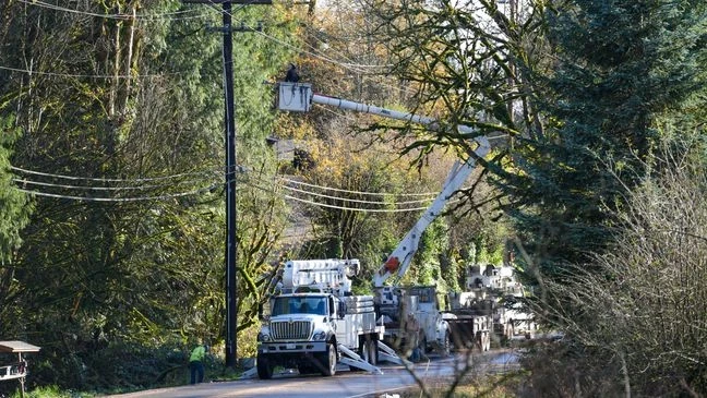

The generator can charge the car, there's charging at the office, and a couple of fast chargers along the way. Those are not cheap though, you pay about $0.50/kWh for fast chargers (350kW) so we only use them when we have to. Still cheaper than gas, but, retail fast charge rates are steep. We also have ICE vehicles that can be driven.
Here's what we see a lot of after a typical wind event with 40-50mph gusts. It's kind of hard to keep dense evergreen forests trimmed back, and it's not feasible to run power underground in a lot of places because of the terrain. You can keep Texas. I prefer Sasquatch country.

And hey, thanks for the well wishes. Really appreciate the Sunday Christian vibes.

I like that area, most areas. What I like best about Texas you stay in the state and experience most everything the rest of the country has to offer. Good luck.
