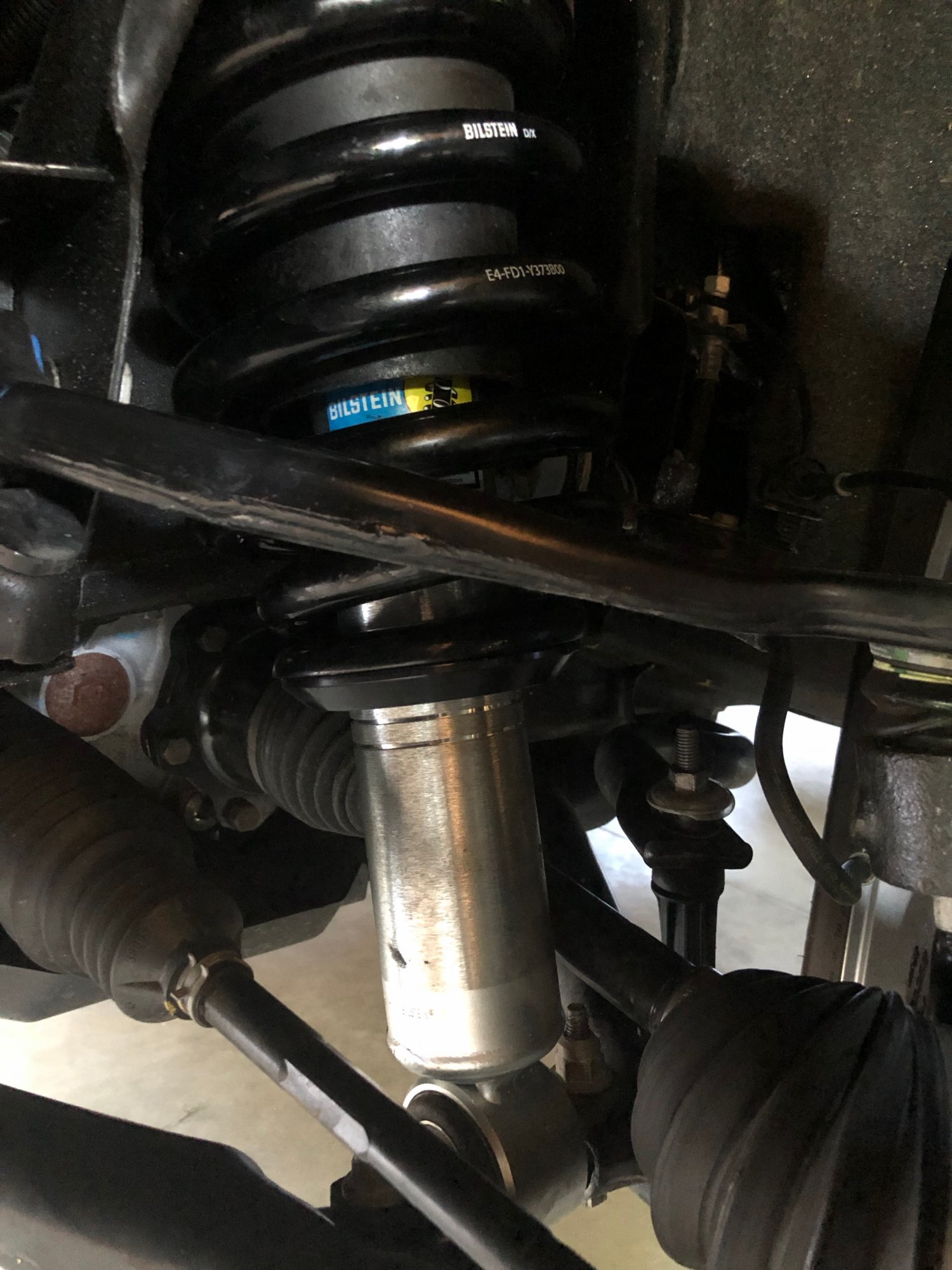

I can also confirm that the Bilstein 6112's at the third setting will show 2 rings exposed below the spring cup.

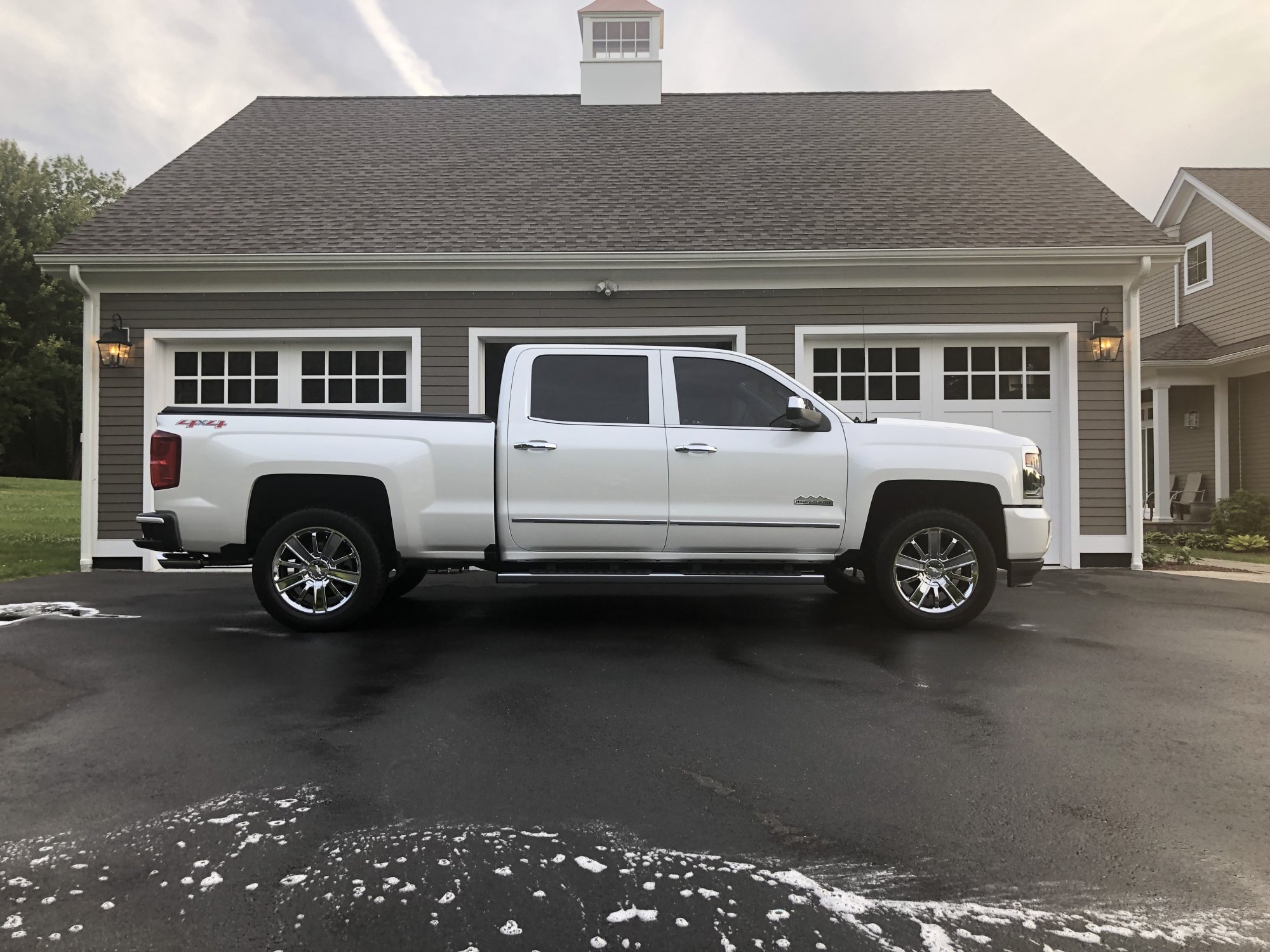

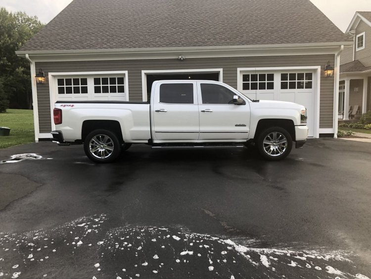

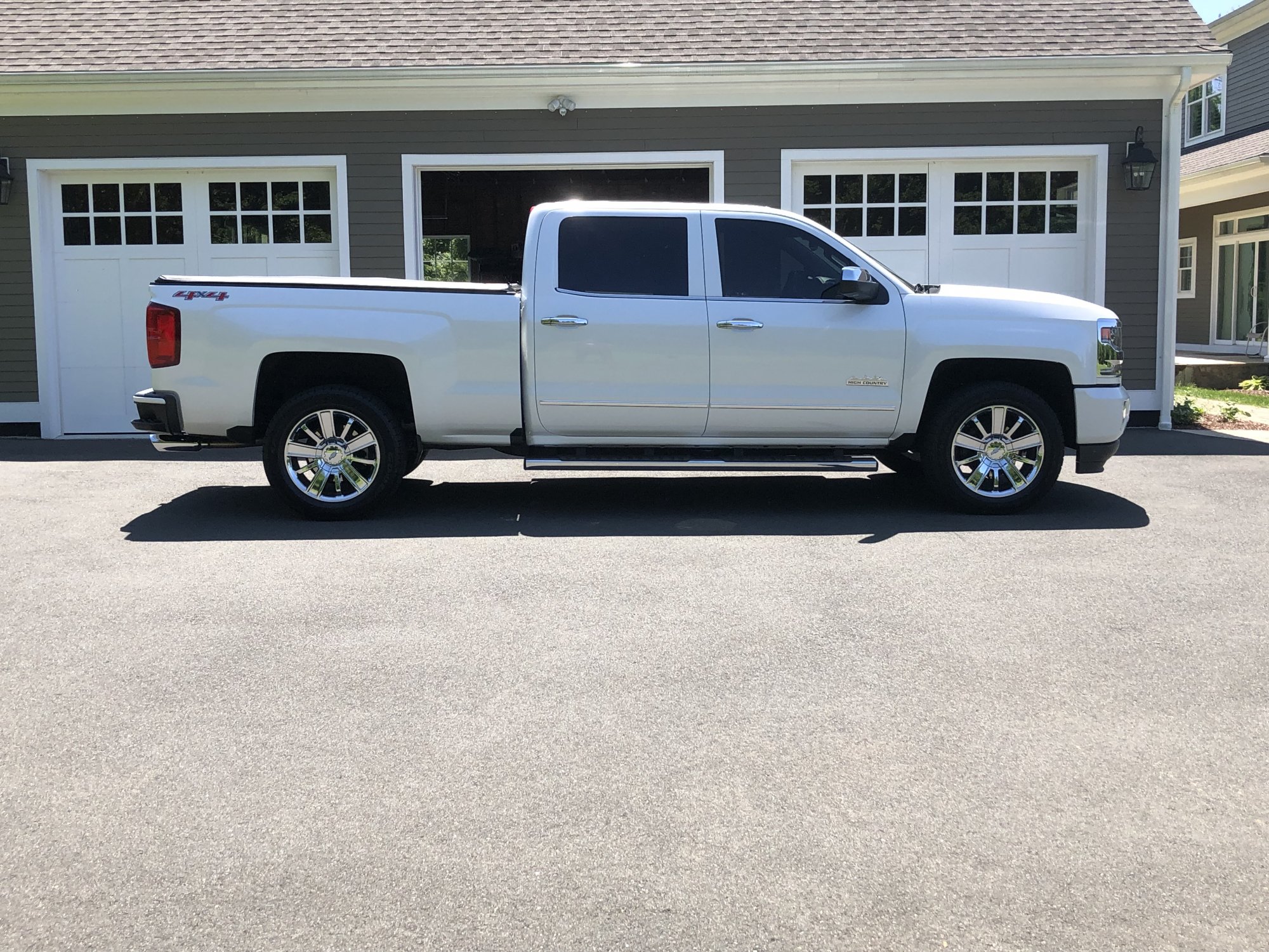

Sure. Tried to park in same place. Lighting was different. Just got done washing it
Bilstein 6112's front. 3rd setting.  Bilstein 5100 rear. Rear block untouched. It might be hard to tell by eye. Measurements were made in garage on level concrete. 38 1/4 front 39 1/4 stock rear. Rake reduced from 2 1/2 to 1. I took the pictures at the same location. Top picture is stock. Pictures that follow are Bilsteins installed.
