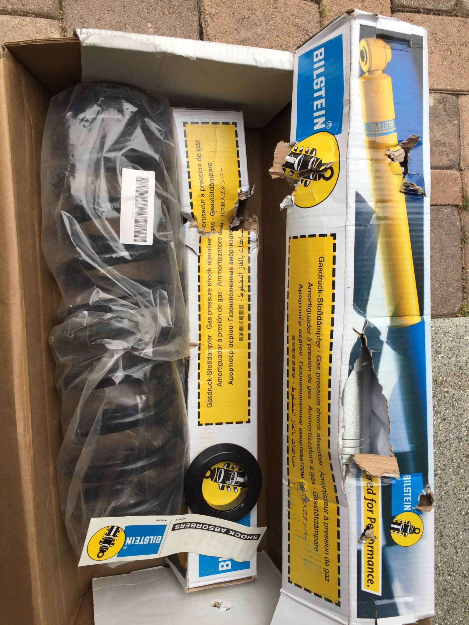

My 6112s finally arrived 2 days late and apparently with inadequate packing material. These things sure are beefy.
Yeah, when I opened mine up and held the strut of the 6112 against the 5100 I had for the rear, it was like wow. Tube is much stouter, springs are beefy. You sticking  with #4 setting and rear block?

I was surprised by how much bigger they are than the 5160s I bought.
Since these arrived late, I missed my window to install and can't now for about 2 weeks so I'll have more time to think about it. I bought the slightly larger blocks already so I'm still leaning toward the highest setting on the for the front.
