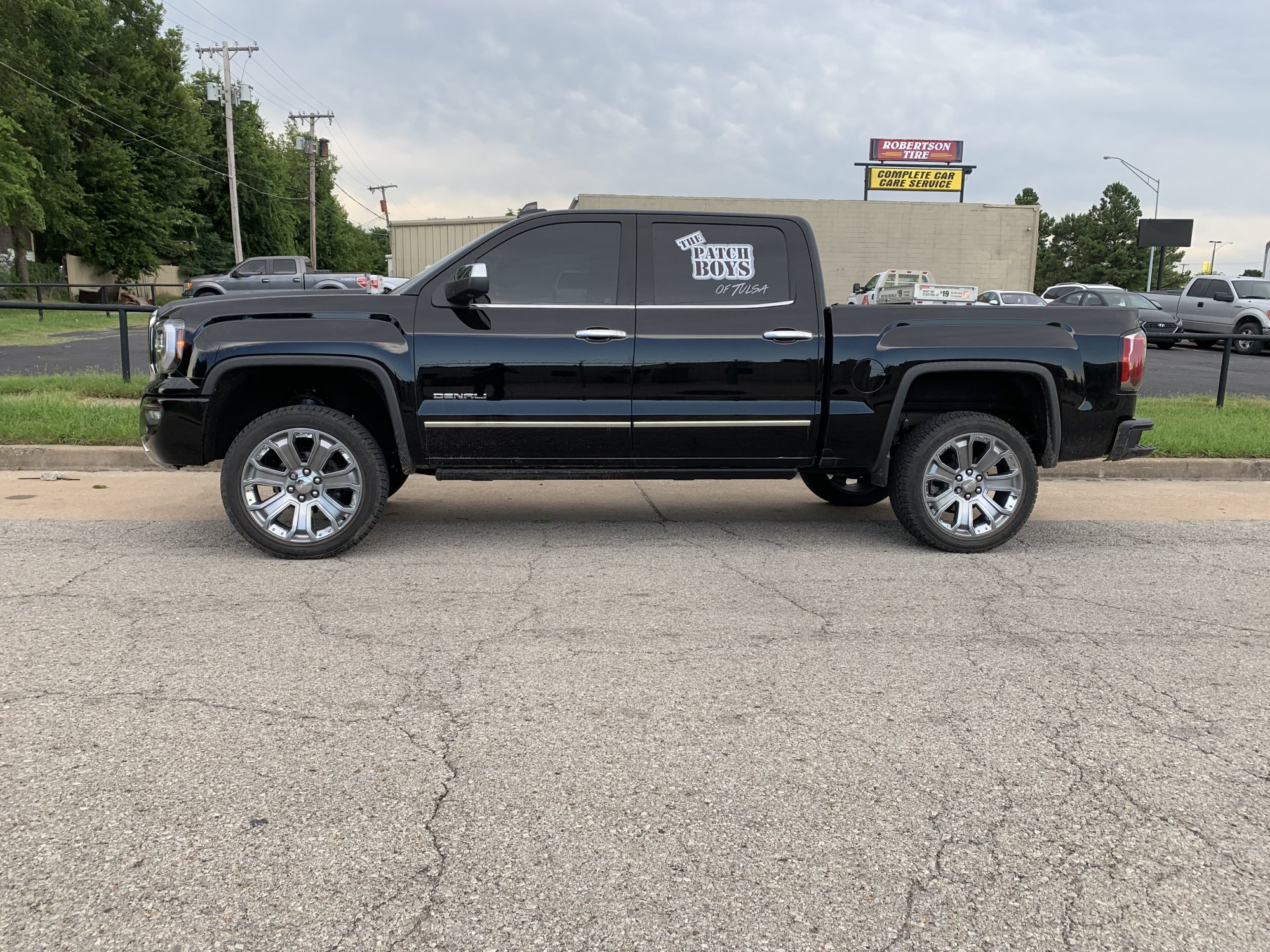

New level kit installed 2018 Sierra Denali
Hey guys thought I’d share the results of my new Suspensionmaxx level kit. I did the full 2.5” in the front and replaced the rear block with one of their 2” blocks. Off-road shop said the rear u bolts were way better quality than Rough Country they typically install. Never the less, i love it. Still rides great. Next on the list is 285/50r22 ridge grapplers ASAP!

What are your fender heights? I feel like mine has settled since I put the level on 50k miles ago and i'm not a fan of rake lol
39.5” front +/- 1/4”
40.75” rear +/- 1/4”
did yours settle in the rear or front?
i added the rear block and keep a slight rake because of towing and not wanting the nose to the sky. Otherwise i would have only done the front. :)

I dont like those angles
I did 2" level and am not crazy about the angle. Fenders are 38.75 +/- 1/4".

Your angles look look like shit.

Agreed I’m not crazy about them but everyone had good reviews with this kit. I don’t drive it but as a second vehicle so less than 8k per year I bet. I’ll keep an eye on them for sure. My steering alignment needs adjusted a little as the wheel is off to the right after the shops alignment

It's still a bad angle. And you have the stamped steel arms. Which from my experiences go bad faster. 8k miles a year is still a lot. I'd do something about it sooner rather than later
