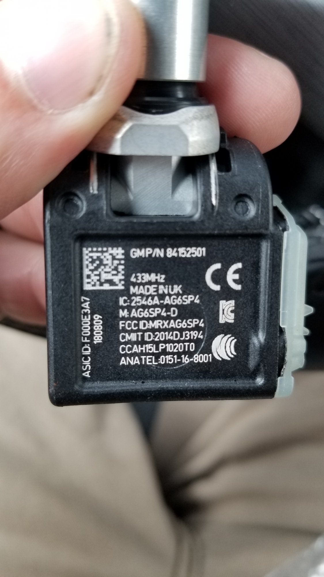

Hello folks,
I just installed the GM Tire Pressure Monitors (GM P/N 84152501) in my Goodyear Endurance RV Tires (225/75R15).  Does anyone know the safe operating temperature range for these sensors?  When coming home from camping the other day I was running 70 mph (90 F outside temp) and the tire temperature was at 138 F.  All 4 tires were the same temp and pressure, just curious as to what is the temperature I should start getting worried when driving?  On my screen the temp was still showing green but had me a little alarmed and thought I would ask.  We have a trip out west in the coming weeks and temps will be in the 105 F range so I am sure the tire temps will go up since the asphalt itself will be around 140 F in the sun.
Tires Goodyear Endurance (80PSI Cold) with a speed rating of 87 mph.  The tire pressure also raises to 85PSI when running at temperature, which I understand is normal.  The real question is about the temperature and where should I start to get concerned and backing down my speed or taking more breaks?
2019 GMC Sierra SLT 5.3L with Max Tow Package
Edited by HightyHo
updated

GM p/n 84152501 is the "old" part number for the sensors. The sensors new part number is the 84338125.  In fact, the old number would show up on the sensors themselves but come inside the GM packaging labeled with the new part number.
It's just a part number, change, nothing more. Which it's essentially the right part number whichever one you use. Both are 433 mHz.  With GMSPO, sometimes it's as simple as a spec change, or manufacturer change that can change a part number. A revision to the part, however slight, may also trigger a p/n change. In any rate, it's just a catalog number so the parts people can find them.
Bottom line, get whichever sensors you can find for the least amount of $$.
