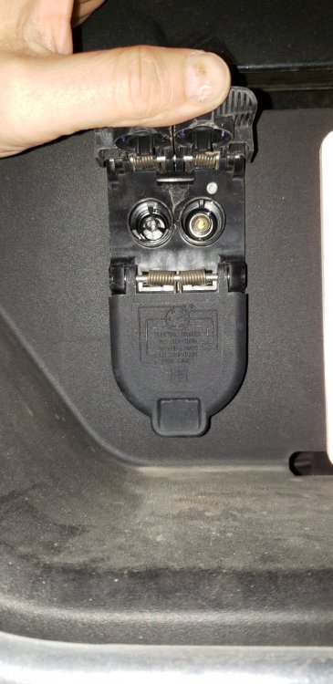

I purchased this with the add on module for my 2019 GMC Sierra Denali 1500.  I tried the curt adapter and I tried hardwiring as Opt 7 shows in a youtube video.  Both of these installs disabled my sensors and cross traffic alert thinking I was towing something.  Does anyone have a good remedy to solve this.  I contacted Opt7 and they said just send the product back for a full refund but I really like the look of the lights but losing all safety features is a real bummer.  Anyone have success with this?  Or suggestions.

I have a max trailer package on mine.  It has no 4 pin jack at all.  The absurdity of that aside, would the putco one still work in my case?
