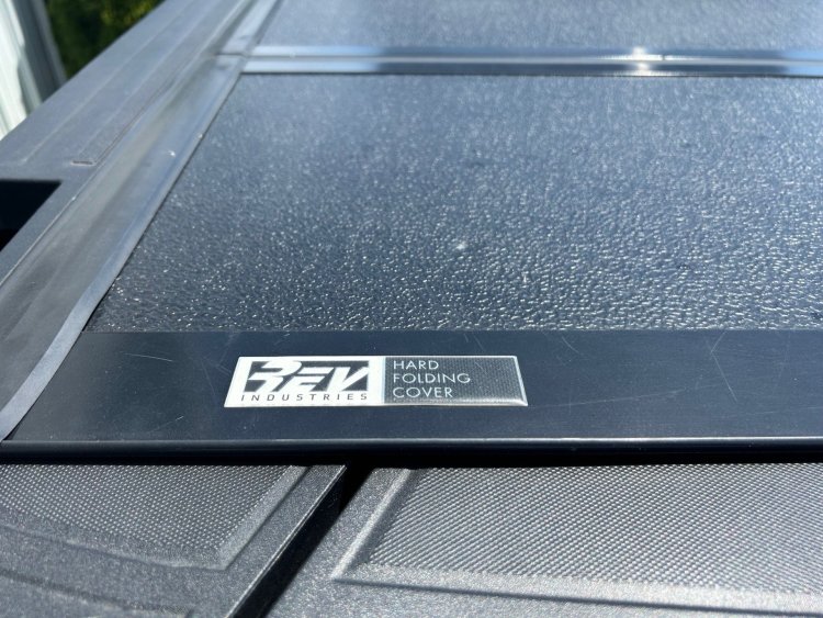

I was set on getting a fold a cover G4 but saw some bad customer pics of cover panels filling with water on their Facebook page and it scared me off. So ended up with the GM hard Folding by REV which is a clone of the Bakflip MX4. Of note, the gm website says their cover by REV is a 5 year warranty, whereas Bakflip MX4 is 3 years.
Install was relatively easy with the exception being the front gasket that I put on then had to take off and move towards the tailgate more.
Overall I would give the cover a 7.5 out of 10.
Hits. Design and looks are top notch. It is easy to flip and fold for bed access.
Misses. Fit and finish are rough in a few spots. The way they manage the seal on the front of the truck needs improvement for those without a plastic drop in bedliner.
The front rubber gasket they supply that gets stuck to the top bed rail is almost too tall causing the rubber skirt on the cover to curl up which doesn't allow water to drain off, and instead channels it to the corners where it dumps into the bed of your truck. Also the cover itself seems about a half inch short.
The rubber trim piece at the back of the cover was trimmed too short on one side leaving a raw cut aluminum piece visible from the outside. And the frame rails had some sharp edges causing me to scratch my hand when I reached for the stake pocket without looking.
Lastly, nothing to do with the cover itself, more a byproduct of the style of cover, anything 20 inches or taller won't fit. I just bought a brand new yeti type cooler by Cabela's and it just fit with maybe a half inch to spare. The sit on top type of covers or soft covers give you another inch or two more useable bed storage for taller items.
All said, I guess I'm happy enough with the cover that it will stay on the back of my truck although part of me wishes I had gone with the Fold a cover G4 that was originally my first choice. Just wanted to share my honest observations.c0e39dcdd77bea0d58ec45e49fd3442b.jpg5d9ec6416b4c9ef6720207c7ba743e8f.jpg3f95181fabc88dcb23c85cf56ef87624.jpgd8a5774d1c7d9aec1ae4f01c939f73a0.jpg6b162ddb259ab0c1b990f16a00023a1d.jpg2b4adb06a304a4250297035597fd0fc6.jpg

At first glance, this one appears to be the same as the one that came with my truck from the factory (recalled one).  I wasn't sure what company makes them for GM.  Yours looks nice, and I'm really enjoying mine!
Edited by lebag335
No mine had the recalled one from the factory too. That one was drilled in with screws, this one is clamps and a different design.
